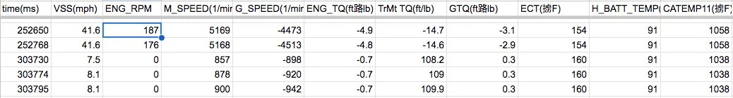

This is just a 51 sec snippet from a 45 mph road and ICE turning off to EV slowing down to 35 where I stayed in EV for a bit, and temps kept rising 154 - 160. 79 F outside, so no need for cabin heat! This is right before ICE was spun up for acceleration. Cat lost 20 even.

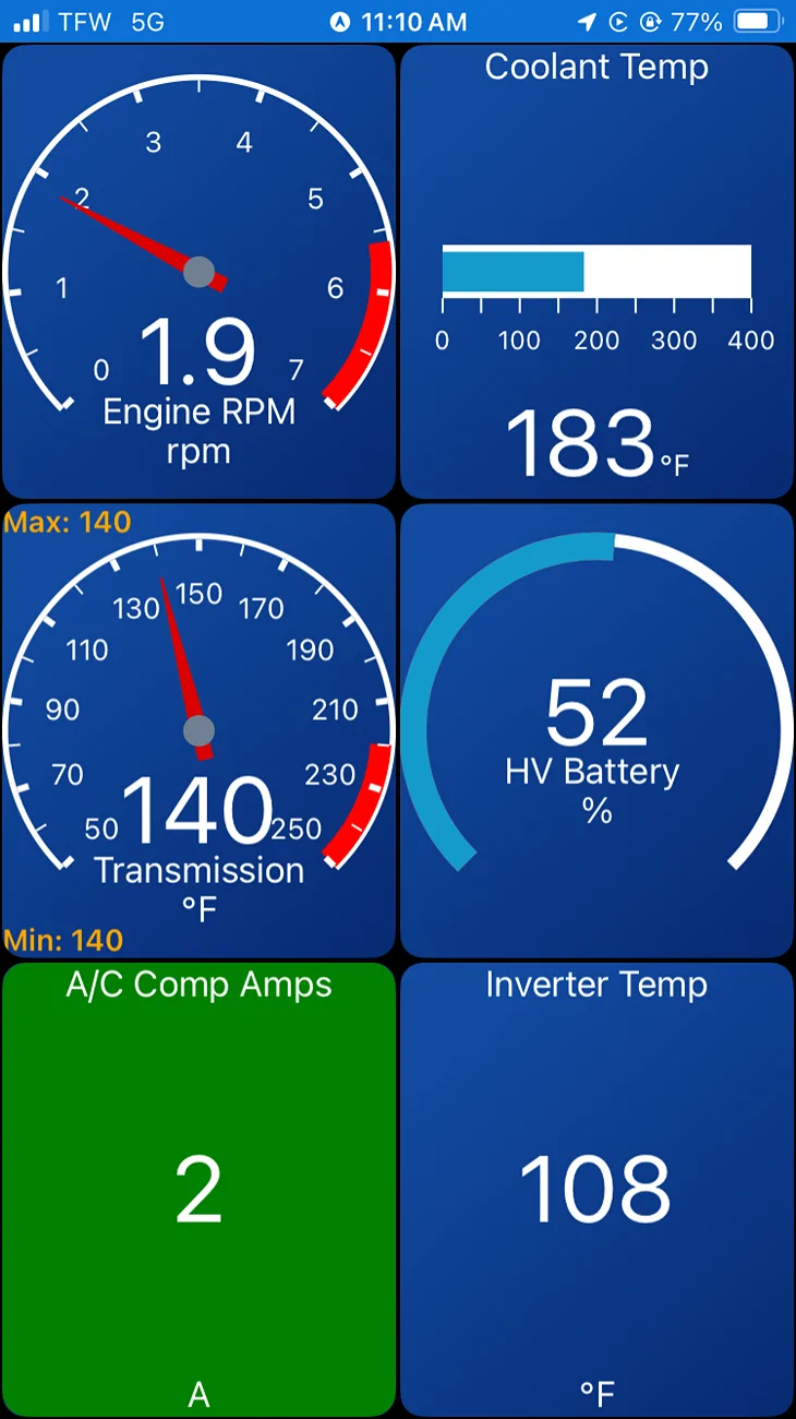

I have noticed this as well. My thinking is the Atkinson engine returns much better MPG the hotter it is, so cooling it down while off would impact MPGs negatively.
Ford Maverick ❓No coolant recirc when engine is off ❓ 20250719_151003000_iOS
Ford coolant WSS-M97B57-A2 is good to 265° F, so no worries on 210°-215° F. The 0W-20 oil is good >400° F.
