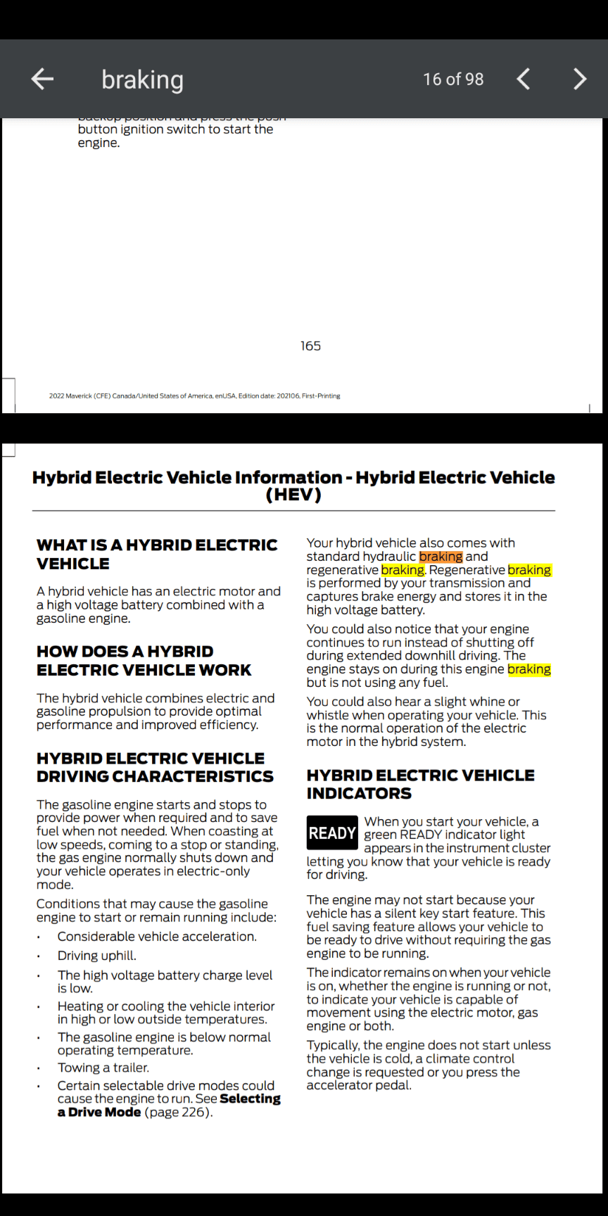

On earlier hybrids, you had an option in the settings menu for "Hill Assist" which would use the engine in a manner very much like a Jake brake. It's not something I'd call "normal," rather "as designed" or perhaps "special" since you need a really long steep hill to activate it in mine.
