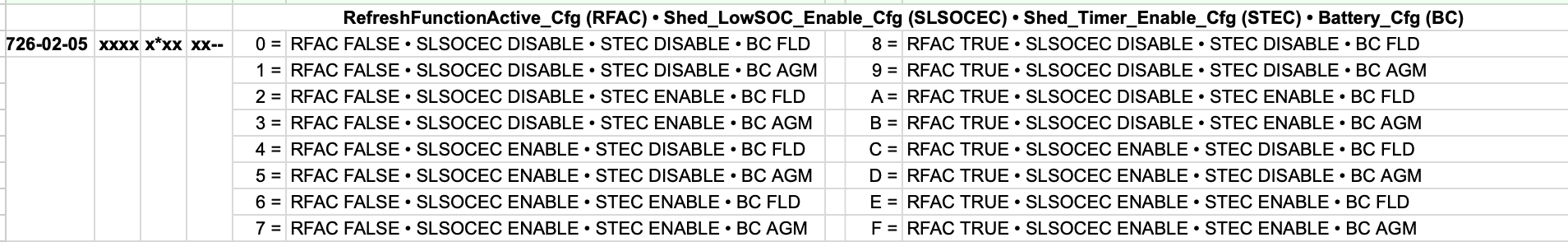

Reviving this as I have noticed that ECOBOOSTS AND HYBRIDS have different codings for the battery config elsewhere in the BCM.
726-02-01
ECOBOOSTS : 0F0F - XXXX - XX--
HYBRIDS: 0707 - XXXX - XX--
Anyone have insight on why? and how changing this would effect the battery?

The BMS (Battery Management System) is where the actual battery information is stored. That will self learn any time a new battery is connected on most systems that is 8 hours in sleep mode with the doors locked and key off.

The BMS also has a hard off setting for the auto stop start system. The way to disable it is to hook up a bad battery to the truck, start it, you may also have to set the ASSS on too but the the BMS will disable it as a feature and not a flaw. Put the good battery back on and the ASSS will be permanently off until you do a reset of the BMS.
