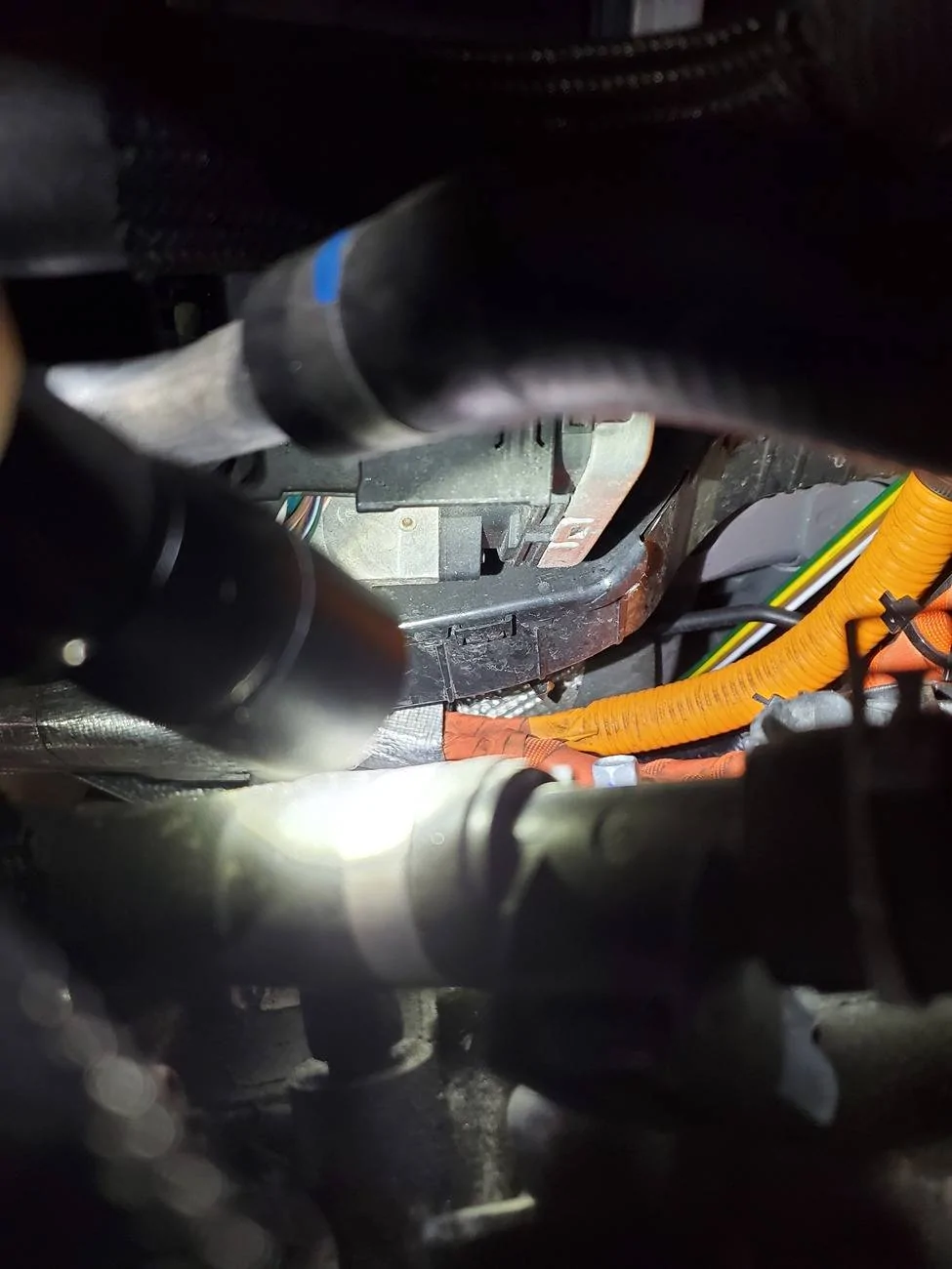

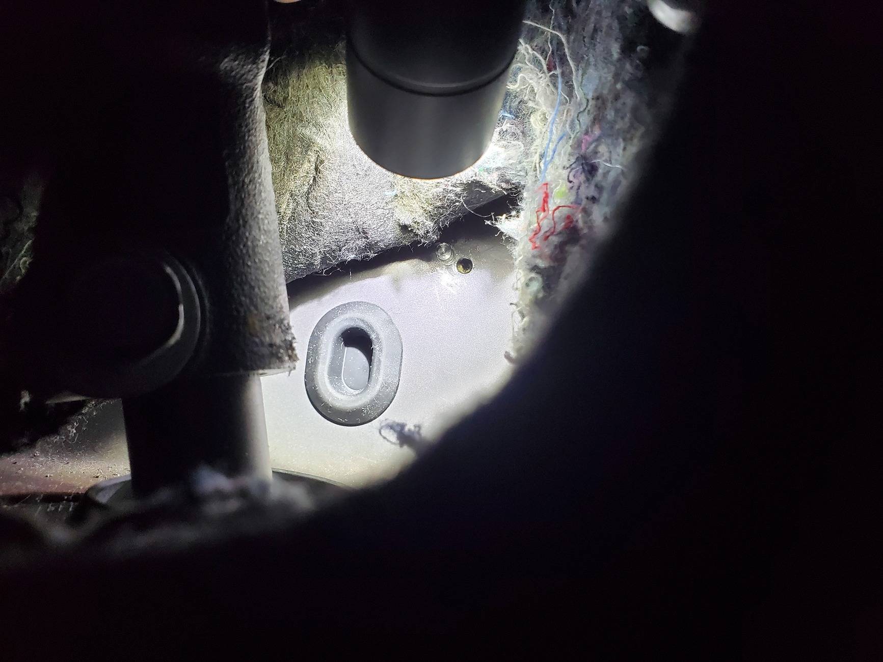

here's where I drilled my hole for rvibrake shadow cable. It's below and to the side of the grommet. I comes out just below the high voltage cables. Really hard to get a good pic of the engine side
Ford Maverick Wire through the firewall 20240804_102537
Ford Maverick Wire through the firewall 20240804_102737

Whatever you do, make sure you have clearance within the firewall of the engine compartment when you drill thru.
