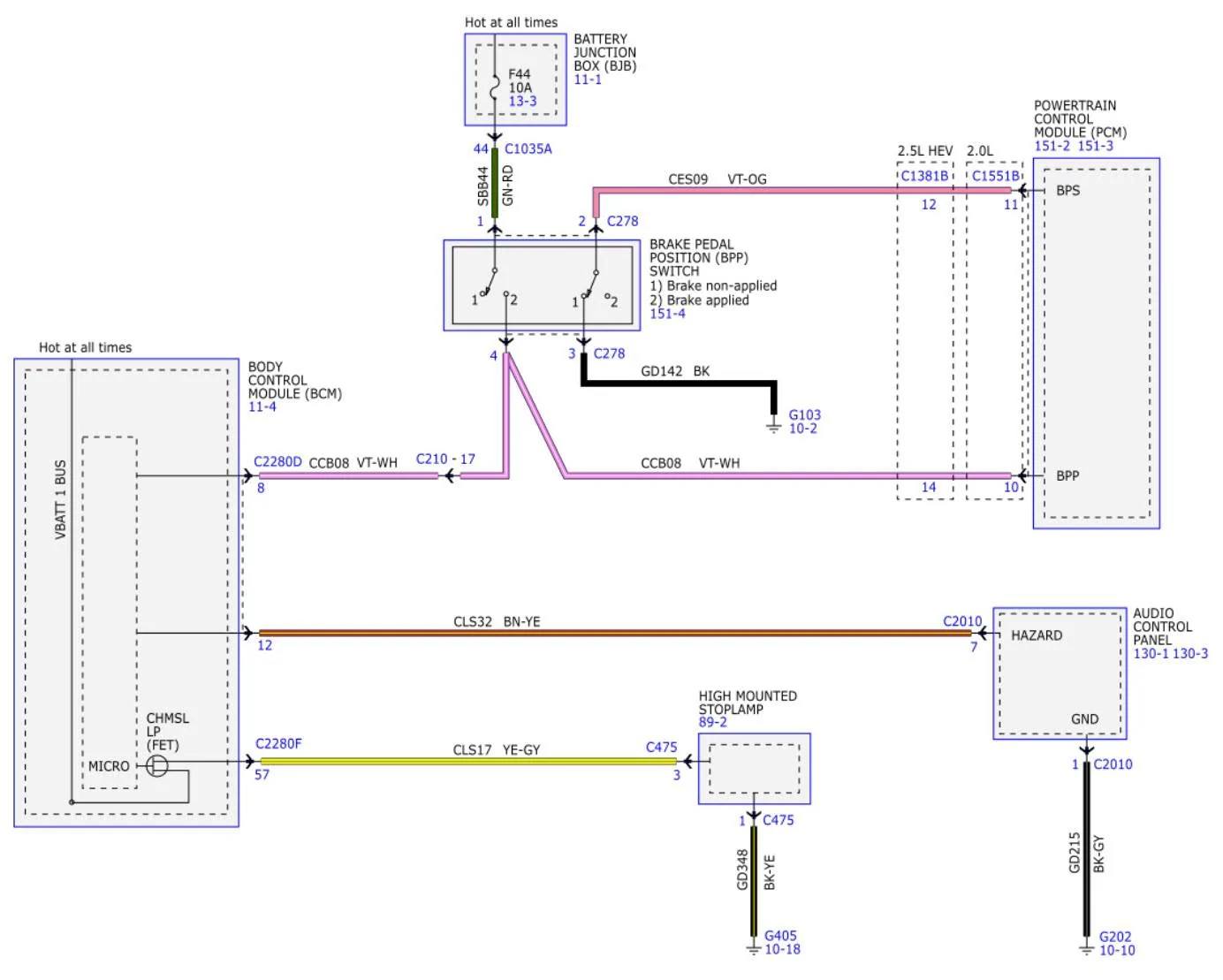

I guess tapping into the CHMSL wire for a trailer brake controller's input and fused +12V to power the brake controller is how to do it as I don't know that there is a separate connector for it on the hybrid.
Center High Mount Stop Light is from the passenger side mounted BCM on C2280F Pin 57, a Yellow/Gray wire that runs to C475 connector above the headliner.
The CHMSL's harness plugs into C475.
Picts look to have Black, White, Orange wires to the light assembly. Orange for 3rd brake light.
https://www.mavericktruckclub.com/forum/threads/23-hybrid-towing-gulp-3k.52933/post-929265
https://www.mavericktruckclub.com/f...ht-when-adding-a-diy-canopy.53430/post-938246
Ford Maverick 4 wire switch at brake pedal. Which wire do you tap for brake controller? BCM C2280F pin 57 to CHMSL C475 pin 3
YL/GY wire that was tapped at BCM in another Maverick by dealer:
Ford Maverick 4 wire switch at brake pedal. Which wire do you tap for brake controller? Maverick CHMSL - BCM C2280F Pin 57 Yellow-Gray T-tap - greenweever

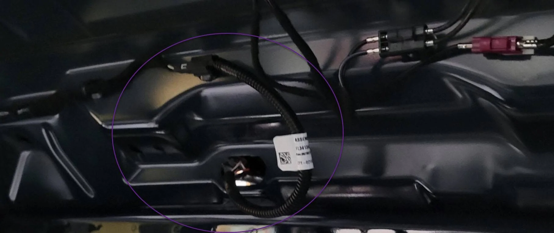

C475 to CHMSL above headliner:
Ford Maverick 4 wire switch at brake pedal. Which wire do you tap for brake controller? CHMSL 3rd Brake Light Connector C475 Above Headliner - shazel

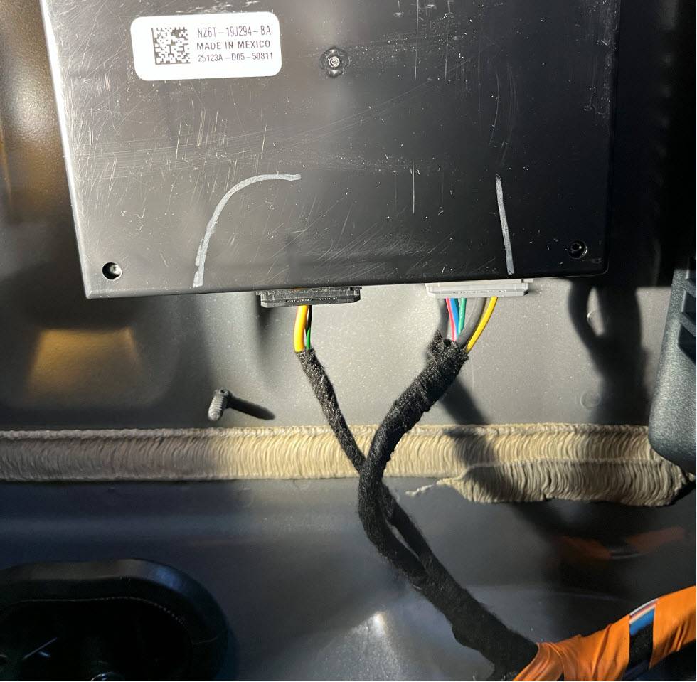

I do have a (TRM) Trailer Relay Module in my hybrid behind the rear seat.
It's only wired for the 4-pin connector the hybrid has with a hitch.
It's missing the wires that would go to a 7-pin connector for Brake, Charge.
I dont know if it is the same module that would be in a Maverick with 4K tow.

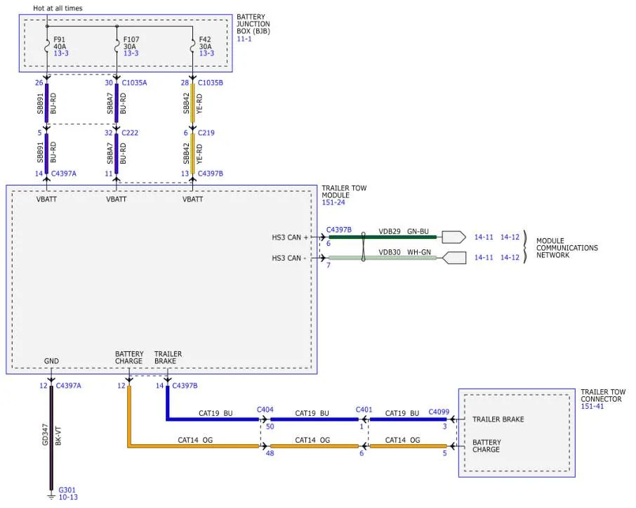

Ford Maverick 4 wire switch at brake pedal. Which wire do you tap for brake controller? 2023 2.5L Trailer Tow Module.JPG
C4397A
11 CAT28 (YE) 18 CTRL MOD. - TRAILER TOW # STOP/TURN LAMP LEFT (COLOR TO SAE 1239) 12 GD347 (BK-VT) 10 GROUND - PILLAR C OR QUARTER PANEL LEFT
13 CAT29 (GN) 18 CTRL MOD. - TRAILER TOW # STOP/TURN LAMP RIGHT (COLOR TO SAE 1239)
14 SBB91 (BU-RD) 10 FUSE - 91 OR CIRCUIT BREAKER
Missing the Blue and Orange wires on C4397B connector.
Ford Maverick 4 wire switch at brake pedal. Which wire do you tap for brake controller? Trailer Tow Module - Wiring

My TRM doesn't have Brake, Battery Charge, LIN wiring on TRM connector C4397B
My C4397A looks like has same wires as 4K TRM
2023 2.5L TRM in my truck:
