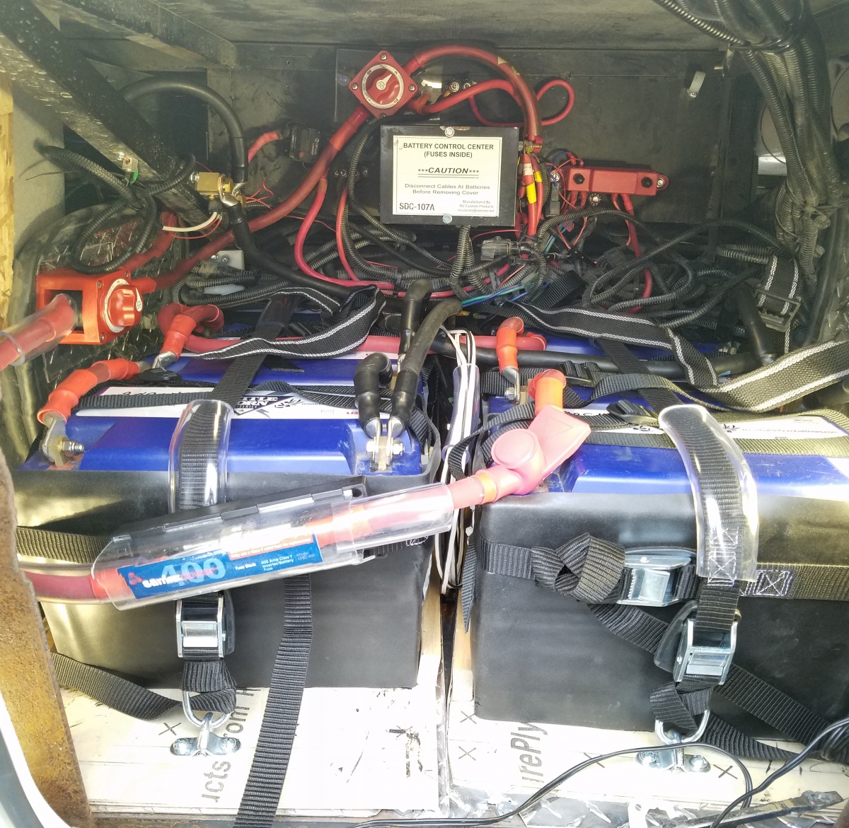

I have 600 amp hours with six Battle Born batteries in my Class A FR3 DS28 . How many batteries do you have to get 300 amp hours?
Solar Power & Battle Born batteries
Three LiFePo batteries.
Looks like 100 Ah batteries are a common item.
Three were preferable in my case vs. one large. In my battery box I have space for two North & South and one East and West. Also three are easier to lift and place. Like an amazing 17 lbs each I think they are.
