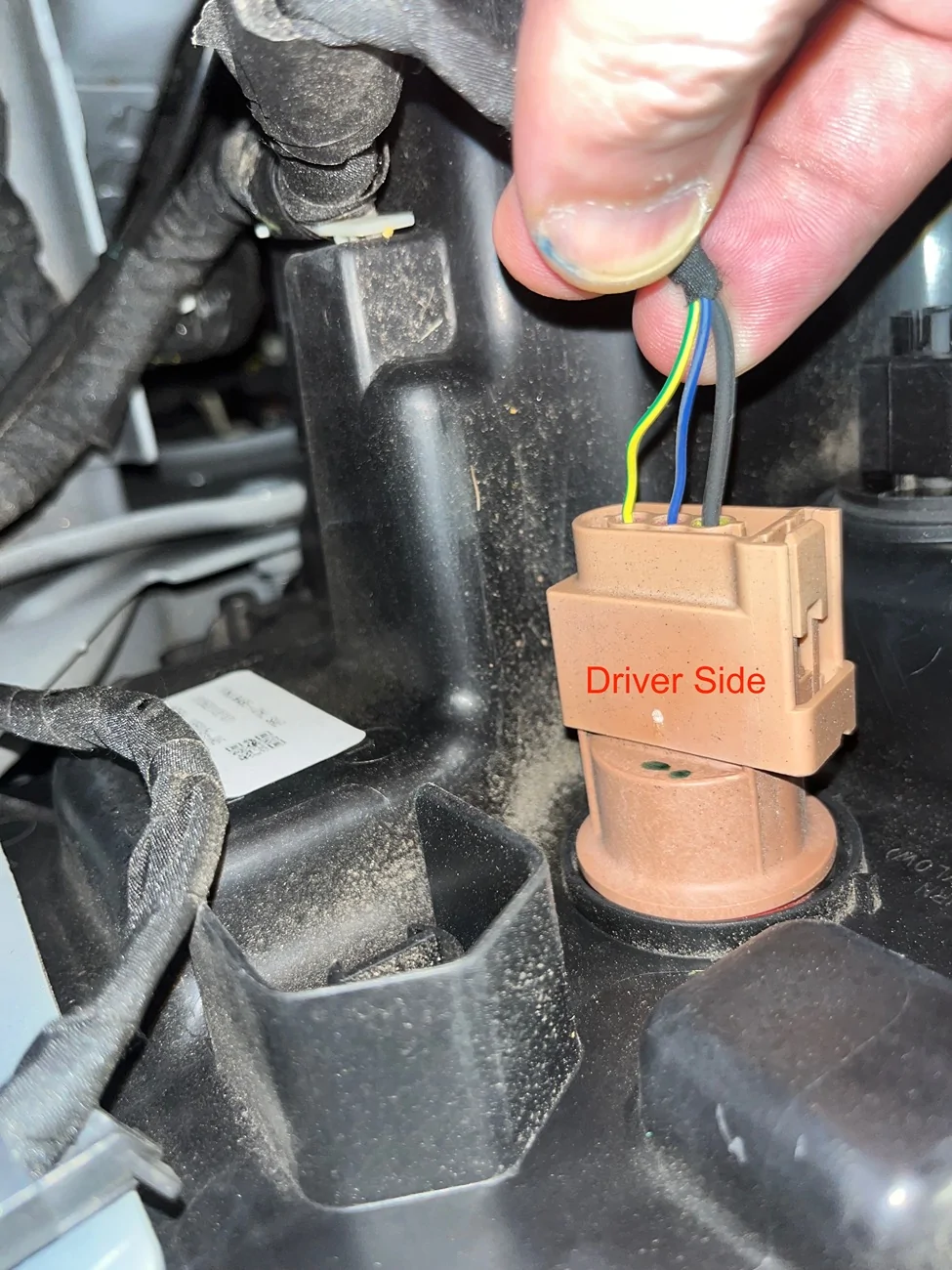

I would like to add exterior LED strip/light to my XLT Maverick badges and plan on using Posi-Tap. The ones I have say 10-22 AWG. I've attached a pic of the wires going to the front Maverick lights. One wire gauge looks thinner than the other. Black is thick and the yellow is thinner.

I wouldn't trust those taps on small wires (or anything on a vehicle for that matter but that's me).
Simple/cheap method:
  1. Remove some of the tape to give yourself room
  2. Cut the wire
  3. Use a sealed butt connector on one end (various alternatives)
  4. Twist together a tap wire with the other end and put both into the opposite end of the connector
  5. Crimp/heat done. Nice inline tap wire.
If you learn to de-pin connectors it opens up a whole world of opportunity to go direct into the connector. Looks pro!

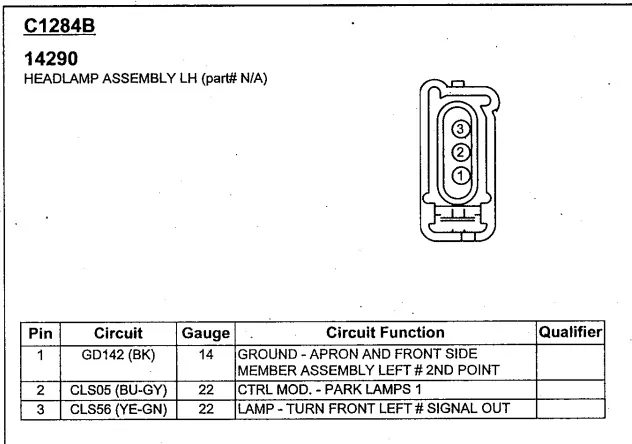

One of them will be ground, one will be the turn signal, and one will be the parking lamp (DRL)
Look at the schematic of the connector that CNJFF posted for which is which.
If your new LED youre trying to add only has 2 wires, your choice whether you want it to act as a blinker, or be constantly on with your factory DRL's, but you cant have both, you gotta pick either/or with just 2 wires.
I want it to act as a blinker. i'll leave the parking lamp wire alone and not connect to anything.
Should be easy enough, looks like you want the outermost ones, leaving the middle one alone, just remove the pin, or bundle the middle wire, wrap it in electrical tape, and zip tie it out of the way so theres no chance of it touching any kind of metal.
Black to black, red to your chosen red... dont get them flipped around since your new led most likely does not have reverse polarity protection.
