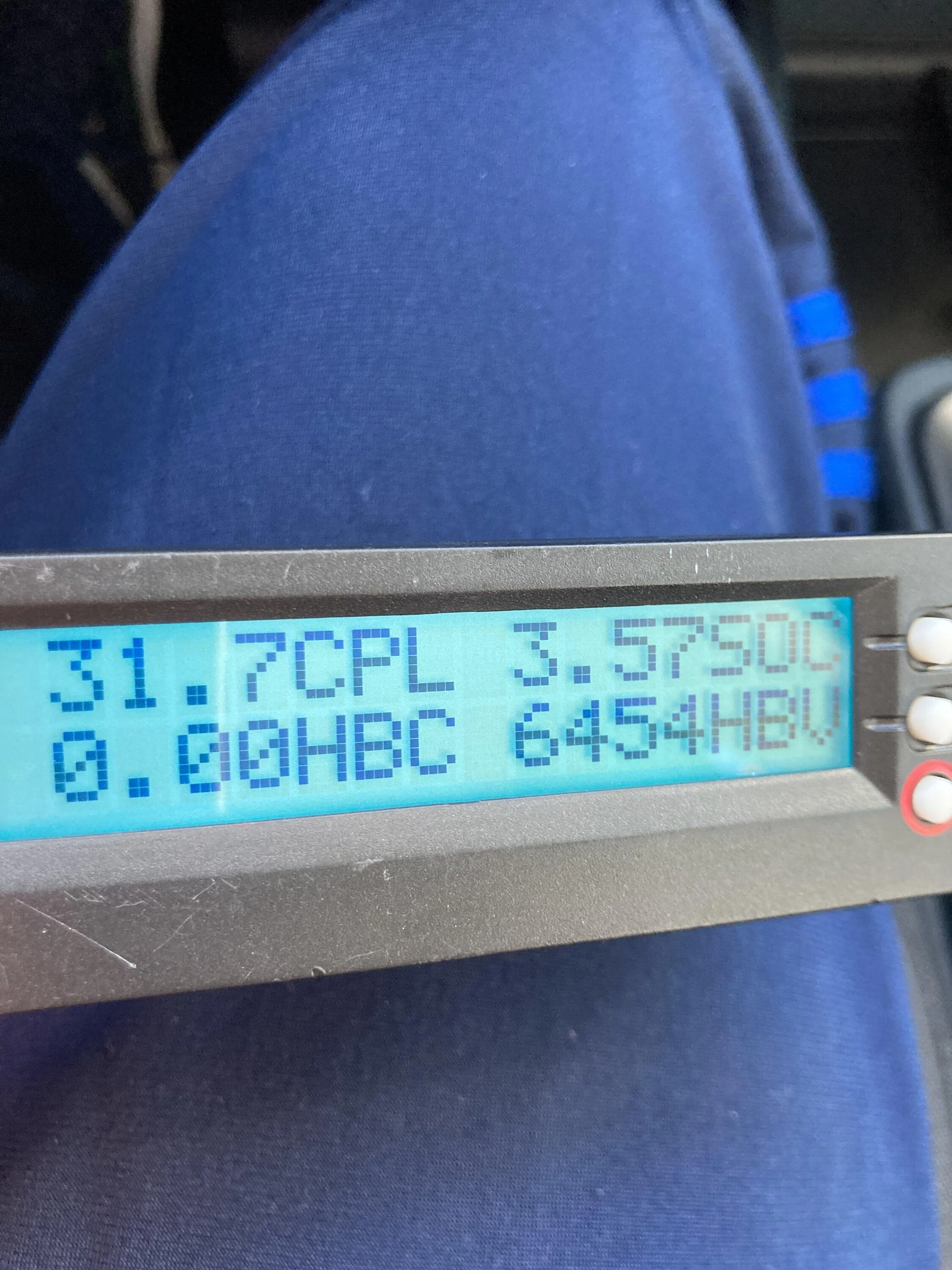

Would you mind explaining why lower is better?
I updated two of the mth and they are better now.
I think the bottom right displays an A instead of an 8 sometimes? Odd

Lower what is better? I don't understand what you are asking.
SOC could be true.
Voltage is way off.
Letters are used in base 16 hexadecimal which is what the CAN BUS speaks in, 10 numerals plus 6 letters. Basically it has 16 characters for data versus "decimal" where deci means "ten".

"I don't know if your CPL is correct or you just got lucky."
I thought this might have meant I was lucky because my CPL is lower.
GPSMan
Jul 28, 2022
4,325
5,340
Many
No. I meant lucky your math codes calculated out to about 32.
Mine with the latest and greatest firmware in the ScanGauge III computes to 32 almost all the time.
It tapers down slowly when the battery gets cooler and cooler, and tapers rapidly when the battery charges above 65% like when going down a hill.
When you get in after sitting all night and it's cooler than the 60's expect the number to be smaller and come back up as the temperature rises. If it is always the same number it's not working.
If SOC hits 65 and still climbs and CPL goes down at the same time, both are probably correct. At 70% SOC the CPL should be zero. Or maybe 1.

Thanks for the explanation. It's been in the 30s at night and 40s during the day.

I know, this is a super old thread, but has anyone successfully gotten the correct values for battery voltage? Mine is also a number around 6,000.
I’ll contact Linear Logic as well, possibly they have some new values to try out.
Nemo
Feb 15, 2024
79
81
24 Maverick XL
Got this from Linear Logic. Looks to show the correct value now, around 220, depending on charge, etc.
Hybrid Battery Voltage (Volts)
TXD: 07DF0153
RXF: 454106532000
RXD: 4010
MTH: 000100400000
