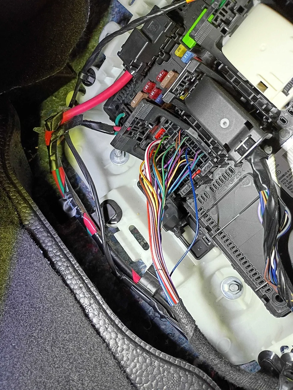

So an update on this. I metered this wire where it connects to the BCM. It connects to pin 17 in the C2280D connector on the BCM. When the vehicle is in park this wire has battery voltage from fuse 4 on the BCM through the steering column lock module. The wire has battery voltage even when the ignition is off. This is illustrated on page 20-1 of the wiring diagrams. When in reverse, neutral, or drive the wire is pulled to ground by the BCM, as shown on page 13-37. I believe the steering column lock module prevents the key from being turned completely to the off position when the vehicle is not in park (key inhibit).
My plan is to tap this wire to trigger a relay when the vehicle is in park. I plan to run my tap wire via a diode and an inline fuse so nothing can backfeed into the BCM. The blue/green wire in the photo off to the side of the harness is the aforementioned wire at the BCM.

Here it is temped up to a relay board. Works well. Relay activates when in park.
