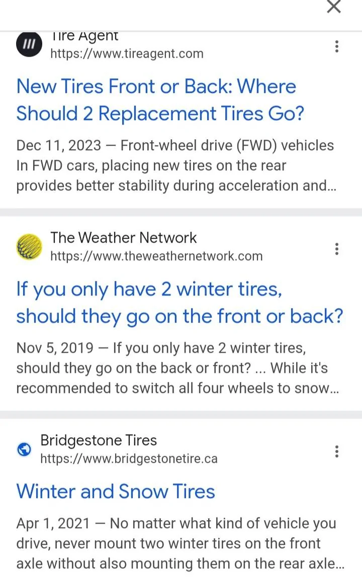

Who said anything about bald summer Tires?
Will bald winter snow tires change anything ?
I try to use a little common sense and don't drive on bald tires to begin with.
Ford Maverick WINTER DRIVING 20241202_122922
I'll stick with the experts on this versus anecdotal stories.
Yes, I use to mount the snow tires on the front of my Ford Taurus's except the SHO it never saw snow. I now know better. Having spent the better part of my adult life in Door County Wisconsin or Bessemer in the UP of Michigan w/163" snow.
I think that qualifies as enough snow driving experience.
