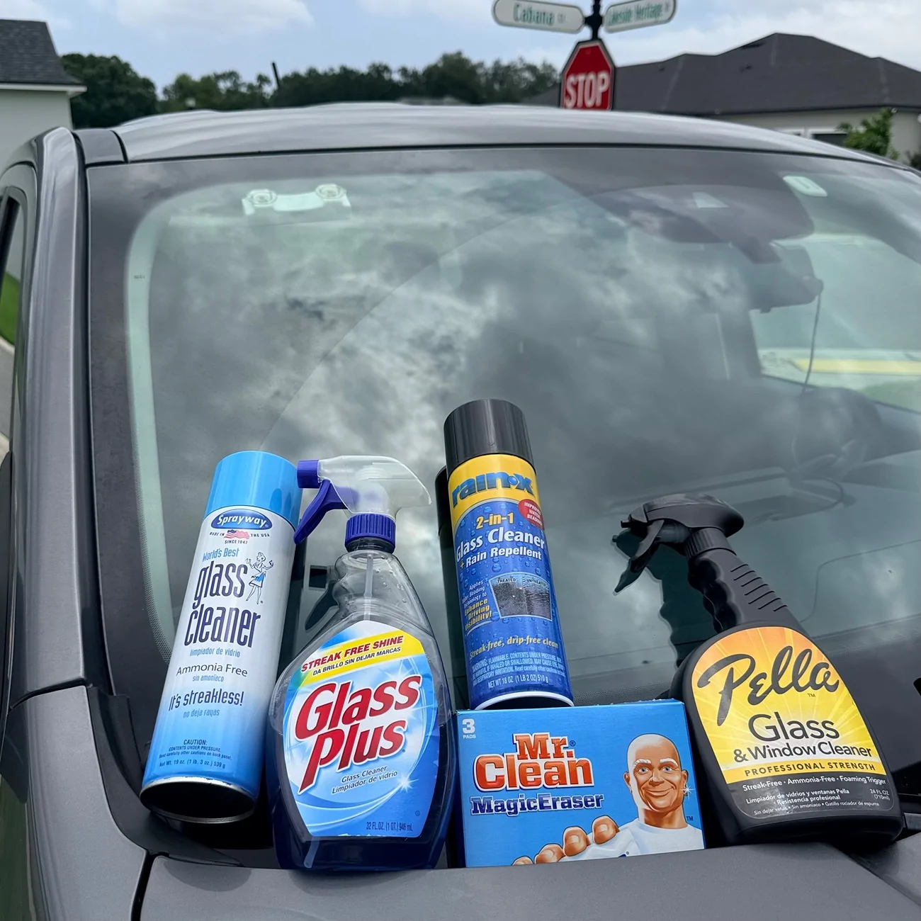

Update for all following. The Magic Eraser didn’t work, nor did 4 brands of glasd cleaner to include Rain-X and Pella Professional Glass Cleaner. The blades were not Rain-X; they were Ford part nos NZ6Z-17528A & NZ6Z-17528-BA, both priced @ $25.98 ea. I am retired. The truck is parked at home outside.
I do live about 5 miles as a bird flies from a phosphate fertilizer facility. Because of trying the Rain-X cleaner the beading is the same when the wipers aren’t running. See photo of what I have tried. Have avoided any with ammonia to avoid damage to the paint itself. Have not tried eraser wheel.
