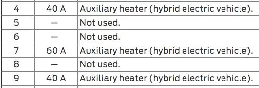

Electric Booster Heater Operation
The electric booster heater ensures that the passenger compartment can be quickly warmed up when ambient temperatures are low.
It is a heater element made up of ceramic resistors that is mounted in the climate control housing.
It directly heats the airflow into the passenger compartment rapidly in the case of low ambient temperatures.
The current is switched via three electric booster heater relays located in the BJB / BCMC.
Electric booster heater operating parameters:
• Engine is running
• HVAC controls have been switched to the highest temperature setting
• Engine coolant temperature is below approximately 75°C (167°F)
• Ambient air temperature is below approximately 12°C (53.6°F)
• Sufficient generator capacity is available
The electric booster heater is deactivated when an engine coolant temperature of approximately 85°C (185°F) or an ambient air temperature of approximately 15°C (59°F) is exceeded.
Fuses in BJB # 4, 7, 9

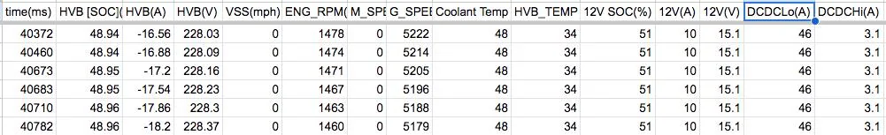

Interesting test last night - took home flattish route to get some good EV miles, but noticed after traffic stop a normal easy place for it still had ICE on. Realized temp still set to HI.
Lowered to 75 and ICE immediately off and full blue battery bar popped up. So PTC use kept ICE on when it was ready to turn off. There's a gotcha for MPG.
Using HVB temp in log from the start - it was 34 F outside. Coolant Temp read 37 F. Considering a morning drive - they would have actually been the same. Log started with key to Acc mode.

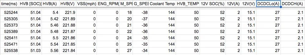

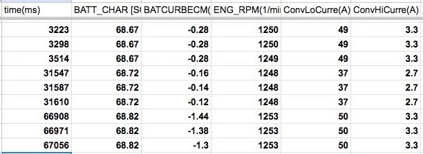

I'll give a snippet idling in driveway, this is after the 12V battery amps dropped back to 10A - Coolant up to 48 F, HVB temp still the same. High enough for charging. (Just to note, during the higher 25A but still lowering to 15A to 12V battery, the DCDCLo A had an increase to 53A during time before dropping slightly. The 12V charging A is in the DCDC Low A figures.)
Then compare that with later after sitting at light after the highway, I turned off HI heat already, ECT still not high enough. So normal avg figures.
Ford Maverick Will Remote starting hybrid maverick turn on the engine ? 1738337189771-om
Ford Maverick Will Remote starting hybrid maverick turn on the engine ? 1738338035467-61
Is the PTC on the 12V circuit?
Part of the 46-10= 36A being used?
Non-PTC is 27-2= 25A normal usage.
Fan speed the same low setting, no lights on/off difference, same radio on, Park vs Drive is it.
So increase of 11A on 12V circuit.
Or on the 220V circuit?
DCDC Hi seems to keep the HVB charging circuit out of the figures.
So 3.1 high to 2.1 normal.
So increase of 1A on 220V circuit.
Hmmm.

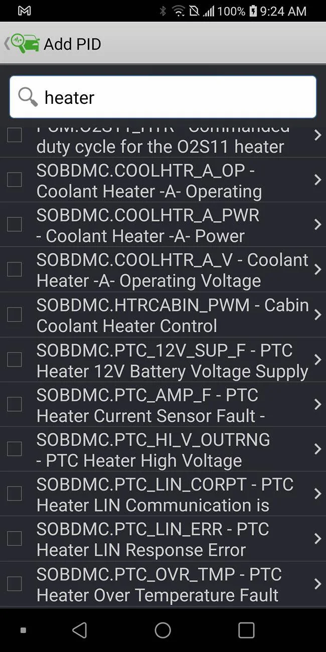

I guess there are some PIDS to track for the PTC heater regarding Voltage at least - but I sure thought I peeked at those already, and none had values, only Yes/No, True/False, Good/Fault type responses.
As we go into 50 & 60 F weekend - won't be testing that at least. Gotta carry my surfboard out to the corn fields!
And appears it is on the 12V system.
Coolant Heater A Operating Voltage and Power - what!?
Perhaps badly worded field name.

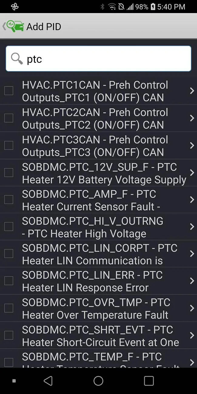

Did a better PID search. PTC1, 2, & 3.
Ford Maverick Will Remote starting hybrid maverick turn on the engine ? Screenshot_20250201-174056
Combined with 3 fuses stated for the Aux heater, 2 x 40 and 1 x 60 (center and edge vents?).
Also confirmed - none of the PIDS give a voltage or a figure, just true/false, yes/no.
Must be under another PID name, I'm sure it must be used.
I'm not sure how they would not show up under the DCDC Low Amp reading, since the fuses are in the engine fuse box on that circuit.
Here's a snippet of idling - high heat, to 75, and back to high.
Only a 12-13 A increase?
Though 220 side 1.1 A increase too, and HVB SOC and current isn't the pull.
So to the point of an outer ring for high heat?
Wasn't actually that cold out, and engine a tad warmed up, ECT at 123 F already. So perhaps it's adjusting for temps being seen instead of going full bore.
I expect full bore draw would be only before other heat available. Maybe the generator current is bypassing the dcdc low reading increase with that reading being only HVB provided current to provide voltage control for the smoothing of the 3 phase generated current. This is all way outside my pay grade, etc. would the 3 ph dc even have to be smoothed for the heater?
