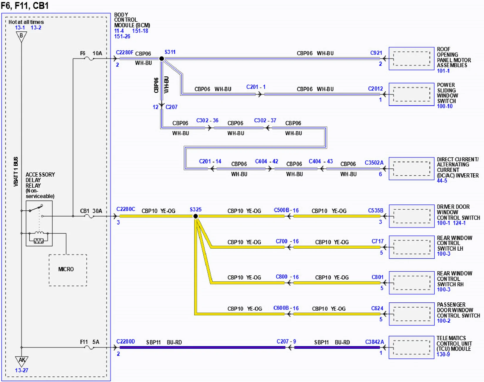

Yes, 12v switched. I realize I can always get it from the fusebox, I was looking for an easier option.
BlueSpec1
Gene
Jul 10, 2022
780
803
23 F150 XLT Powerboost, 22 Escape Plug-In, 23 Bolt EUV
ACC Switched 12V doesn't go to rear seat area.
Fuse info from a 25 Maverick Lariat

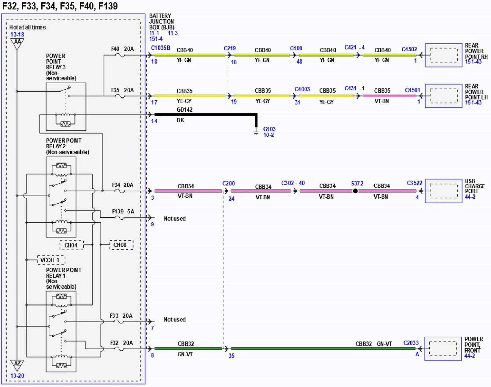

If you want a 20A switched circuit you could use 1 of the box power point circuits.
They run down each side & can be accessed behind the rear seat or rear foot scuff panels
Any pics of their location/harness?

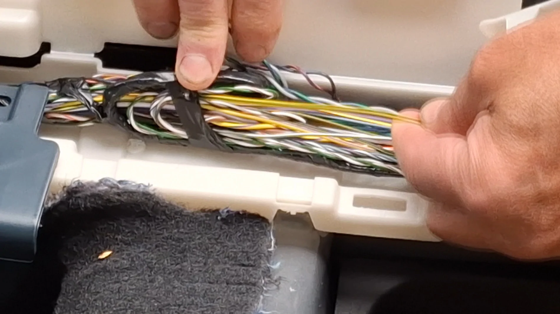

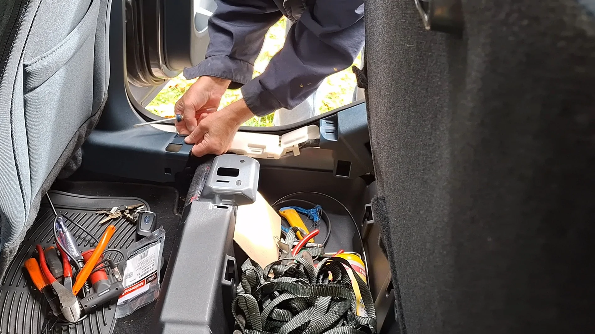

Im in the process of doing a video about tapping into these circuits
Heres a few screen shots of where I tapped in .
I found tapping in at these locations was easier as the harness isn't wrapped under the harness boxing
The right side is a 14GA yellow & green wire switched & 20A fused at the Battery Junction box.
