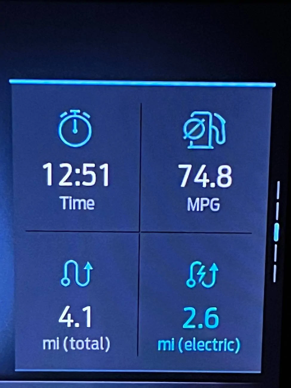

I’m finally getting great mpg numbers now that the weather is back above 60 degrees. Man, those cold temps REALLY kill the engine and battery. I was worried for a bit there. Thought I got a dud. But now I’m routinely getting trips around town in the mid-upper 40 mpgs. I even just got my first trip with a CRAZY number of 75 mpg 😂. Check it out.

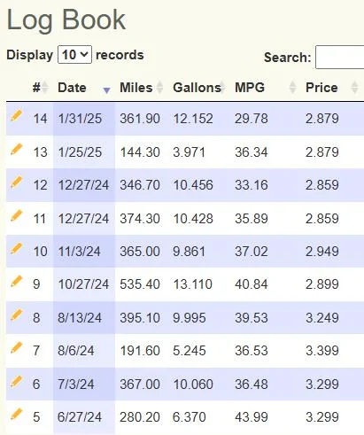

Here's where I ended up. I came back and it was 40°-45° and I went 70 mph vs 74 mph. Averaged about 33 mpg coming back home, so still less than what I have been getting, but round trip was just about 30 mpg. Definitely a learning experience.
Urrggg. That's terrible mileage. I'm in Canada at probably an average of 20 degrees temperature less than your location. I average 5L/100km or 47mpg in Merican right now in January with ice tires and winter gasoline and the heater on a lot, and it drops to an average of 3.9L/100km or 60mpg in the summer with the stock tires and summer gasoline. Do you have a stuck brake or something?
