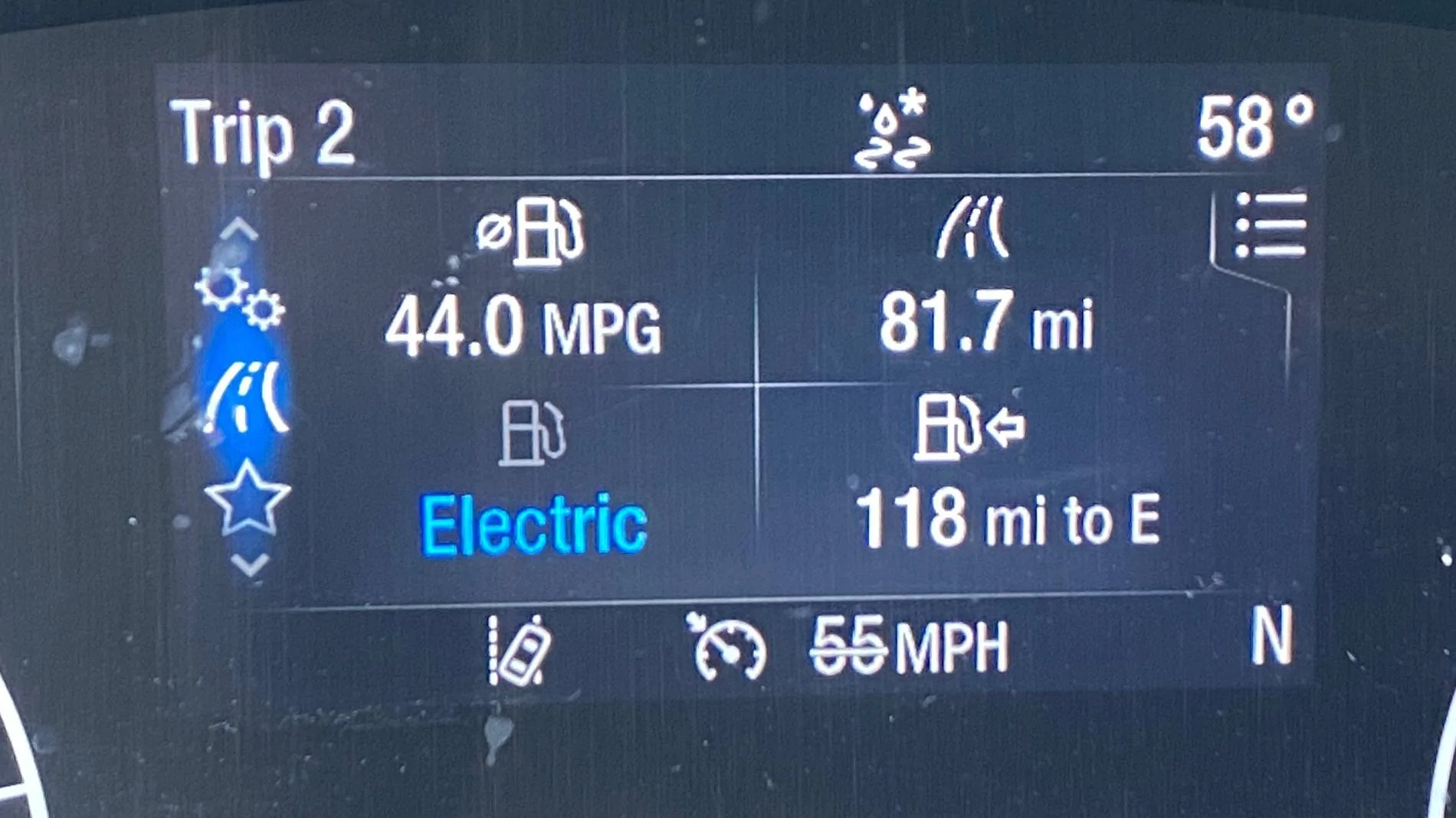

It's a tale as old as time....
People not understanding what the window sticker is saying.
The window sticker is only saying under precise laboratory conditions, the truck will go this many miles on a gallon of gas.
The sticker NEVER STATES the MPG YOUR TRUCK will get with you driving it in your conditions.
No. Not everyone is seeing lower numbers. Some (me) see HIGHER numbers.
Example: 80 miles of highway driving at 55 mph yields me 44 miles per gallon.
Ford Maverick Why is winter *highway* mpg so low? IMG_2533
But the on screen computer calculations are consistently optimistic by 5% across nearly all drivers, ecoboost and hybrids.
You can calibrate the computer by putting your dash into engineering test mode. I did and set mine to 950/1000 or 95%. My 44 MPG is accurate to real life. 44 MPG is 95% of what the stock setting was. Or 5% lower if you will.
