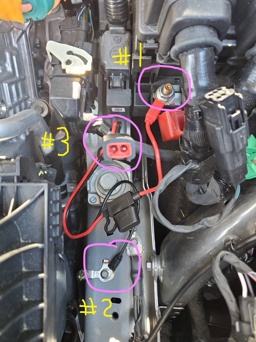

Who knew (or is it Whom Knew... no Who Knew sounds better) that my MY24 Lariat Hybrid was also equipped as a Plugin Hybrid. I checked my window sticker and did not see that as a listed option. I am positive that if FORD was aware of this, they would have charged me at least $1000 more for this optional feature. It will be a bummer that this added option may be obsolete with a magical software update from FORD in some future calendar quarter in some future year. Now all I need is to find a water bottle I like for the driver’s door and ALL my first world problems will be taken care of. :crackup: :crackup:

Make sure that charger negative is on a ground point/bolt somewhere and NOT on the battery negative post. Will screw up the battery management system if you connect to the negative post on the battery.
Here's a bottle that fits the front doors: https://amzn.to/40mrXHQ

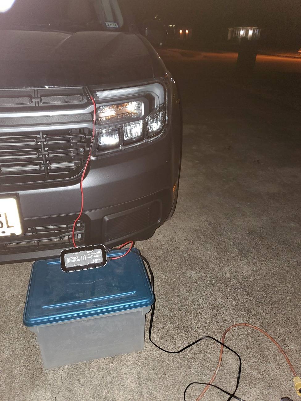

Thanks, I think I got it right, but that will be for this forum to determine. :teehee:

That will work for the negative.
I want to add a tender to my '23 XLT. What is the nut size on the jump start post that your positive wire is attached to?
Thanks.
