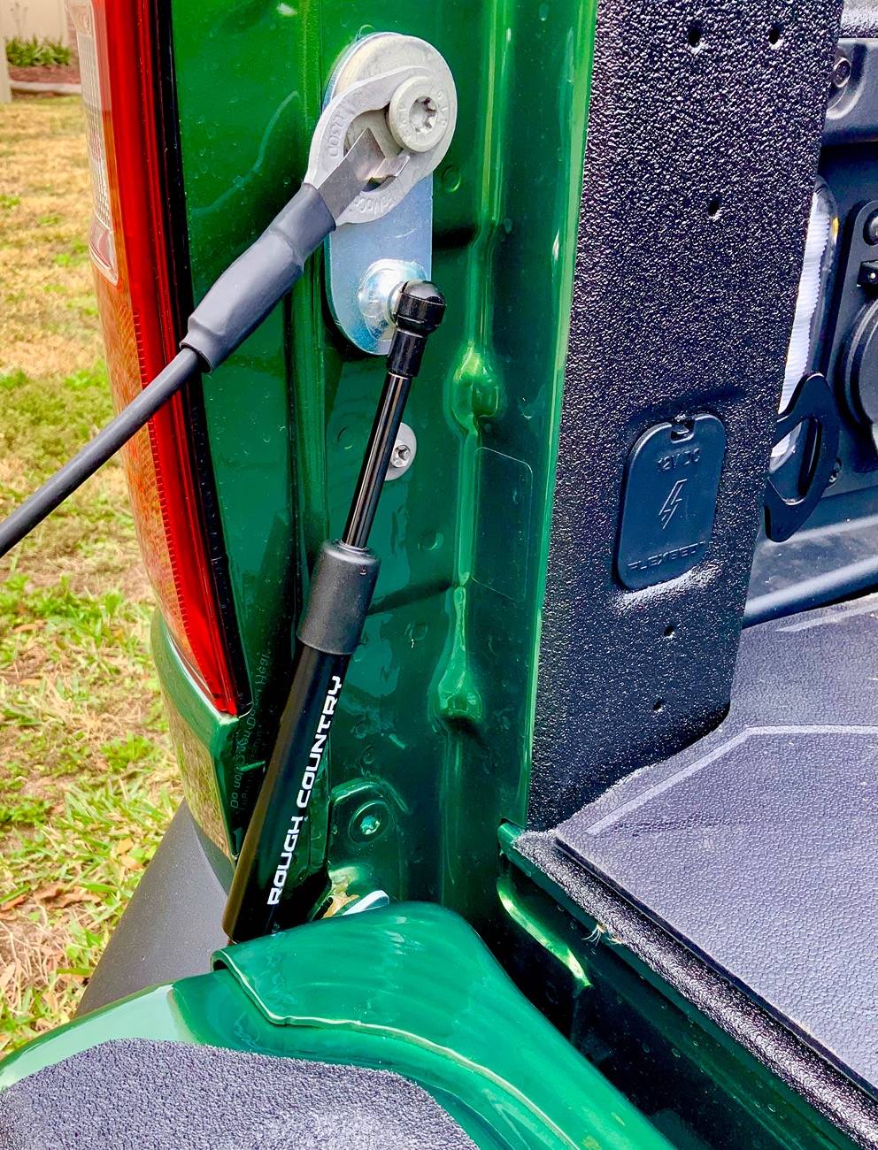

I chose the rough country although they all look the same to me except the writing on the side
Just an FYI if you're able to do it easily, I would swap the direction of the strut. The way you have it now encourages debris to flow down into the chamber. It's small and silly and probably isn't a true issue, but it felt better in my brain.
I appreciate your insight I will look at doing this - just a note funny the manufacturer or seller doesn’t put the label in the direction for the best installation practice at the very least an arrow or this side up label🤷🏼‍♂️
Yea, they probably don't even put that much thought into something like that. It's nitpicky for sure, but better safe than sorry!
