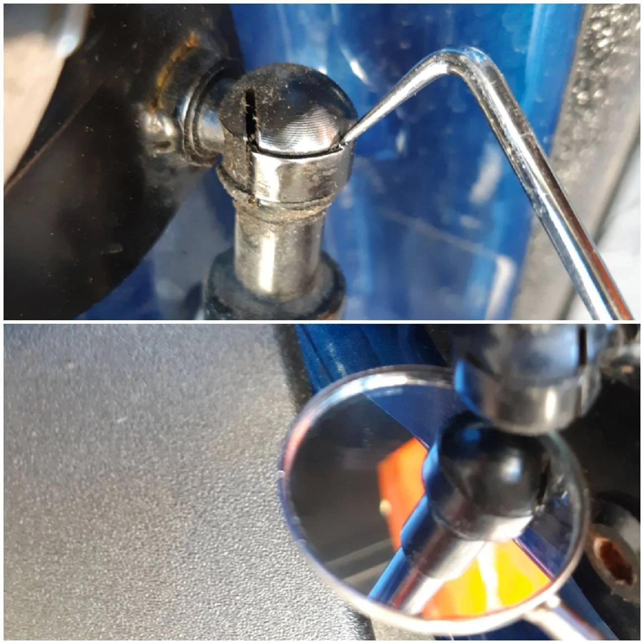

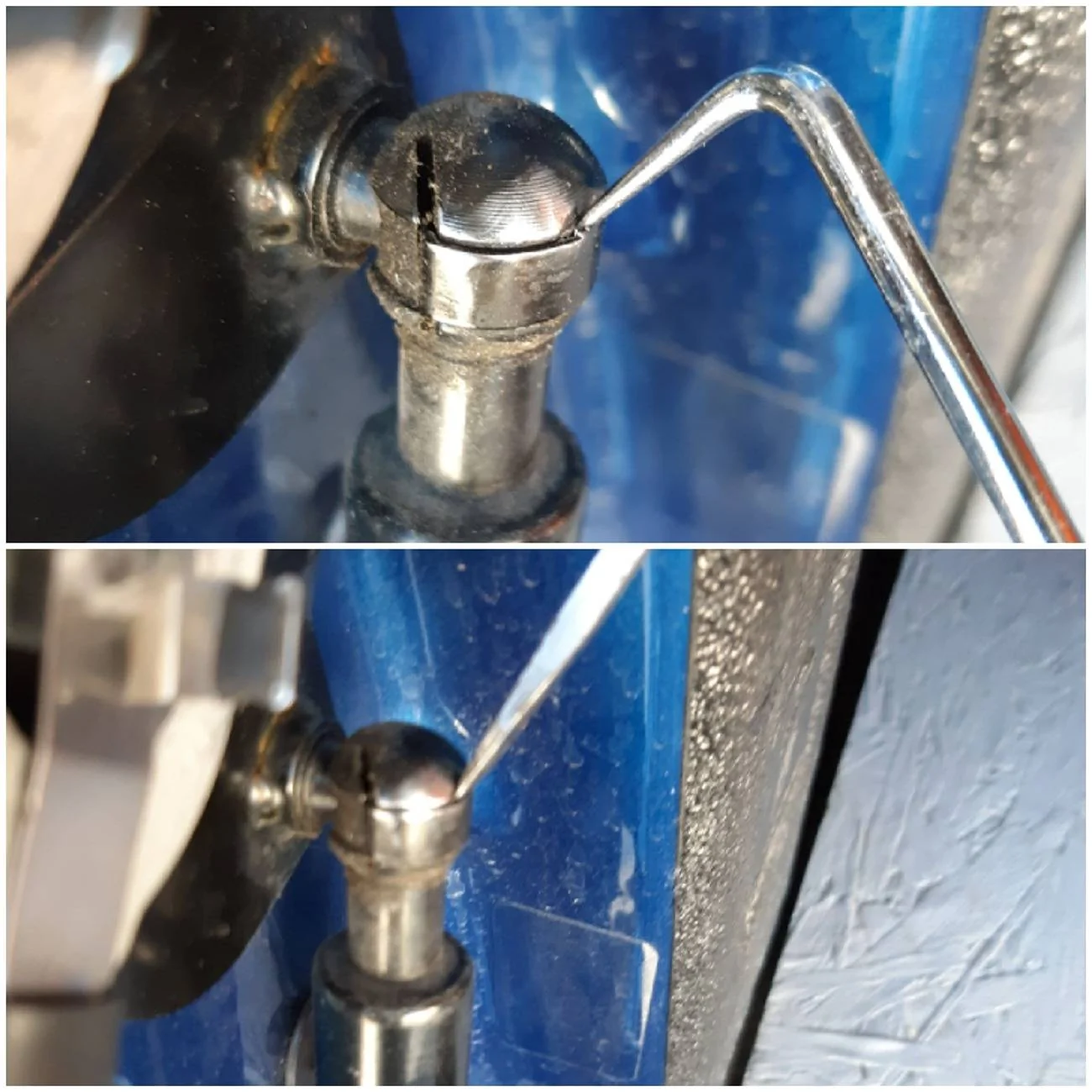

Keep an eye on that spring clip. I had one once flew across the shop, took me half hour to find it! Most of these gas struts, including hatch back cars, baggage doors on motor homes and others use the clip. Makes it easy to just pull off after removal of the clip.
