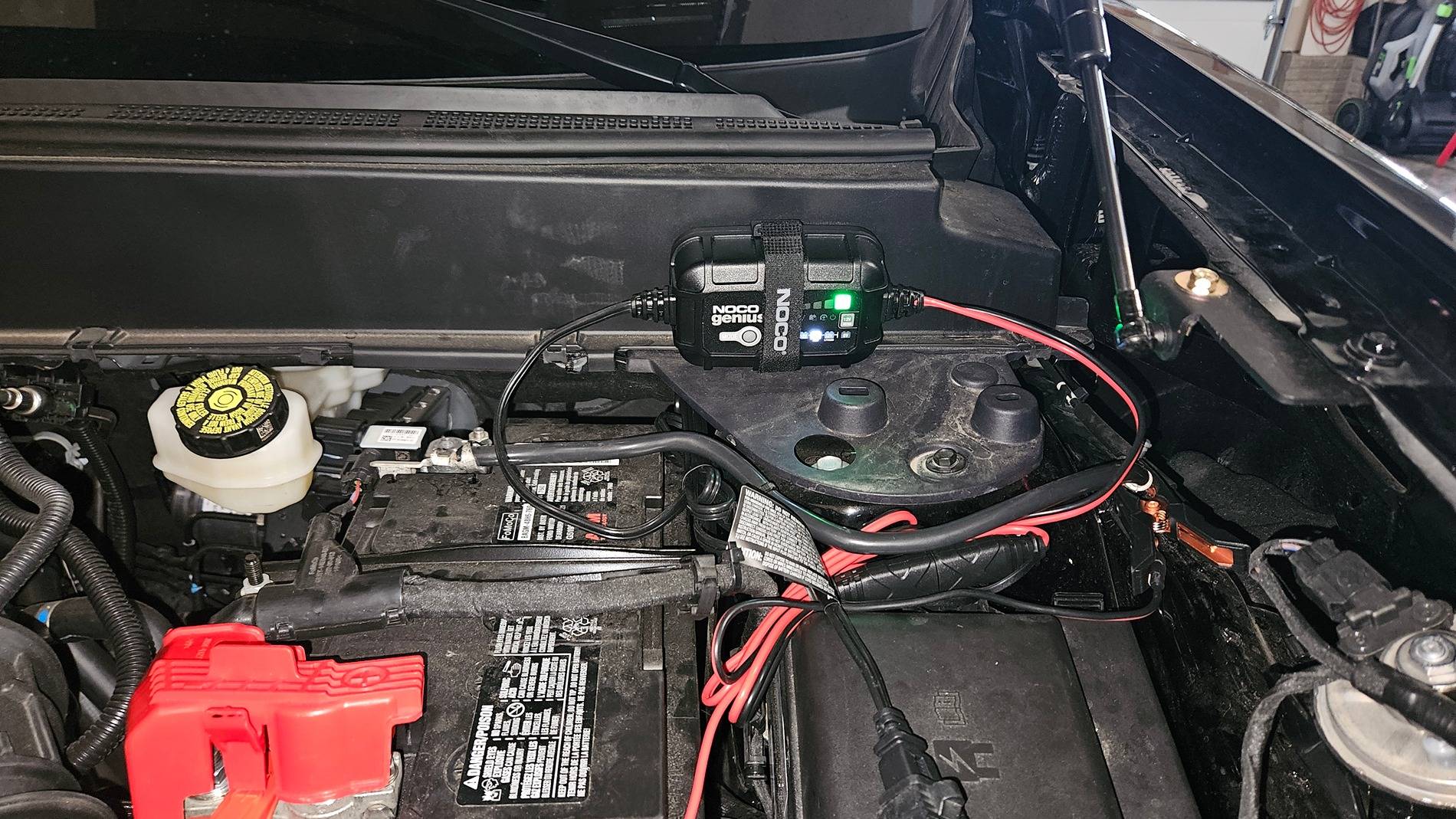

I decided to keep the charger and cables under the hood and open it to plug in the charger. The main advantage for me is to know I won't forget to unplug before driving away... my 76 year old mind occasionally has a brain fart, and I'll get a big red warning if I try driving with the hood ajar.

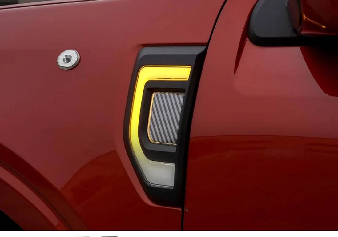

I had the same thought cause my 24 lariat goes into sleep mode occasionally I was thinking on the same charger and routing wire and mounting a permanent plug on the side to one of the side badges
I was going to do this and bought the Mabett side markers. I saw an AC plug mounted in the front bumper. It was for a block heat in the north country! If you come up with a good idea please share.

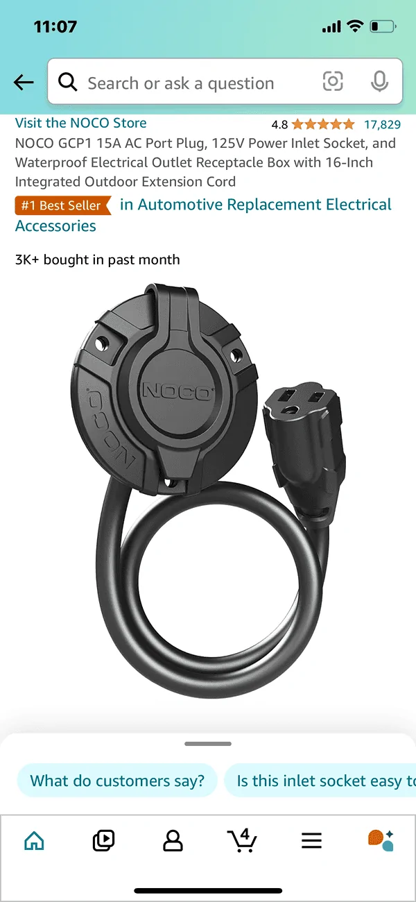

It would make sense to have a dc plug and not run AC power under the hood. These look interesting. It would also provide a port to provide DC power to an external source. Maybe we need to mount solar panels on the cab roof and sent it to the battery!

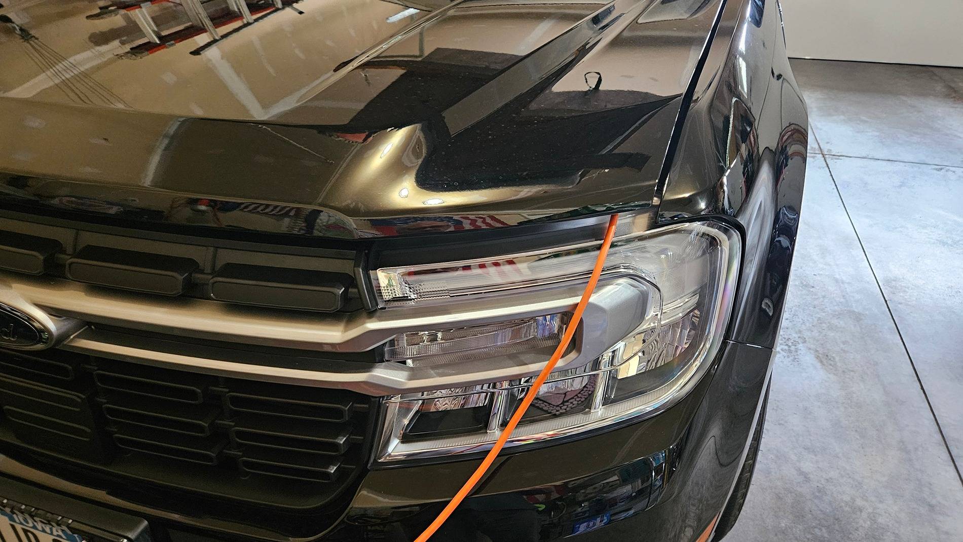

My battery tender DC cable just goes out over top of the grill in the crease between the grill and quarter panel. Lays right in there and no contact when closing the hood.

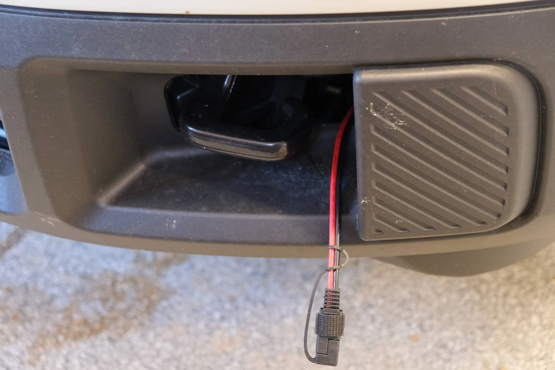

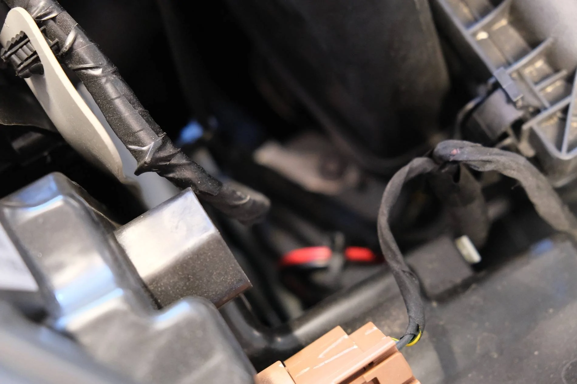

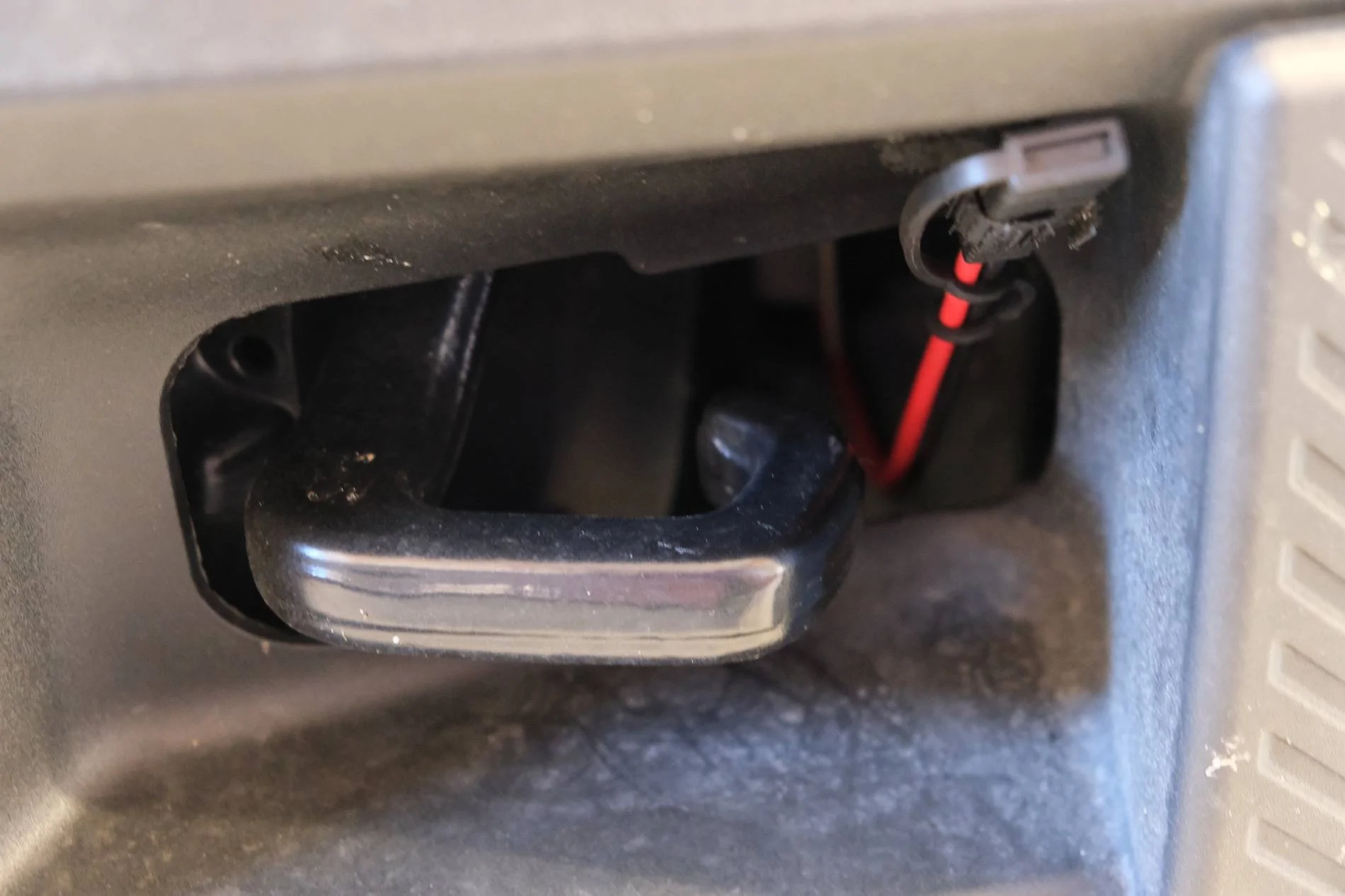

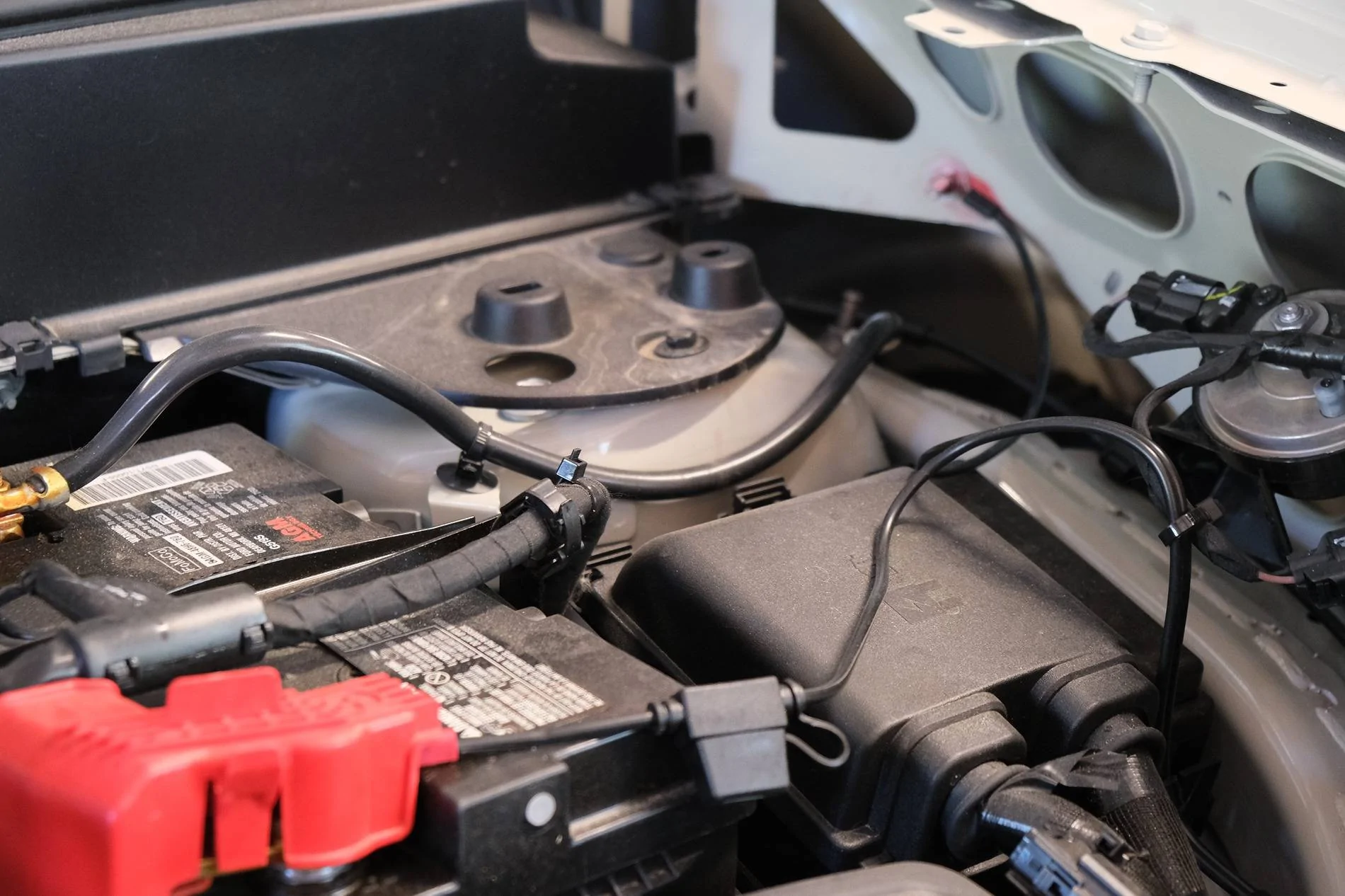

Well, I took a different approach. Wired to battery and chassis (added 8mm bolt as stud) and used long SAE cable to route down behind headlight and out the grill where the tow hook is. In pictures, it's the red/black cable. I needed a NOCO/SAE adapter at the NOCO charge cable side, not mounted in the truck. I velcro the cable up under the grill by the tow hook when not in use. Sorry the pictures aren't great, but the setup works well. I just dropped the wire down and fished it out the hole, clear of the radiator, and zip-tied to convenient places.
