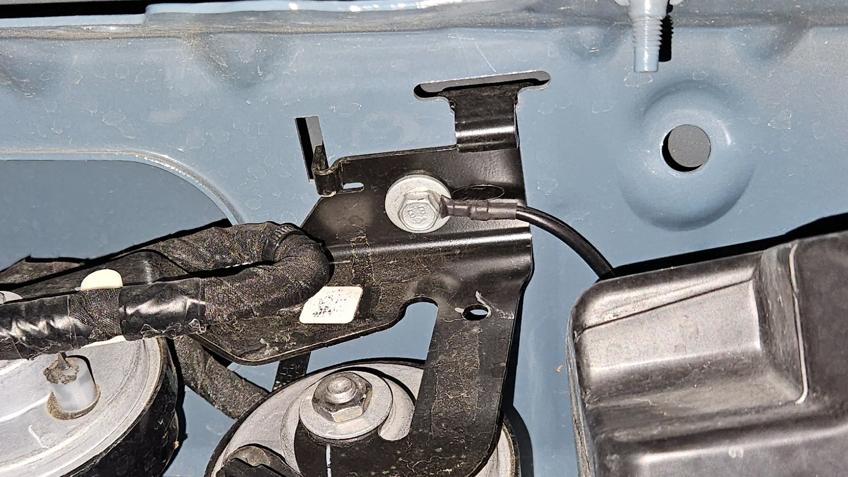

Engine compartment

It's strange that Ford provided positive and negative terminals for jumping our trucks but chose to not put threads on the negative one.
You can easily unscrew the groung lug and replace it with a threaded one.
I did it. Just be sure you get the correct thread pitch.
