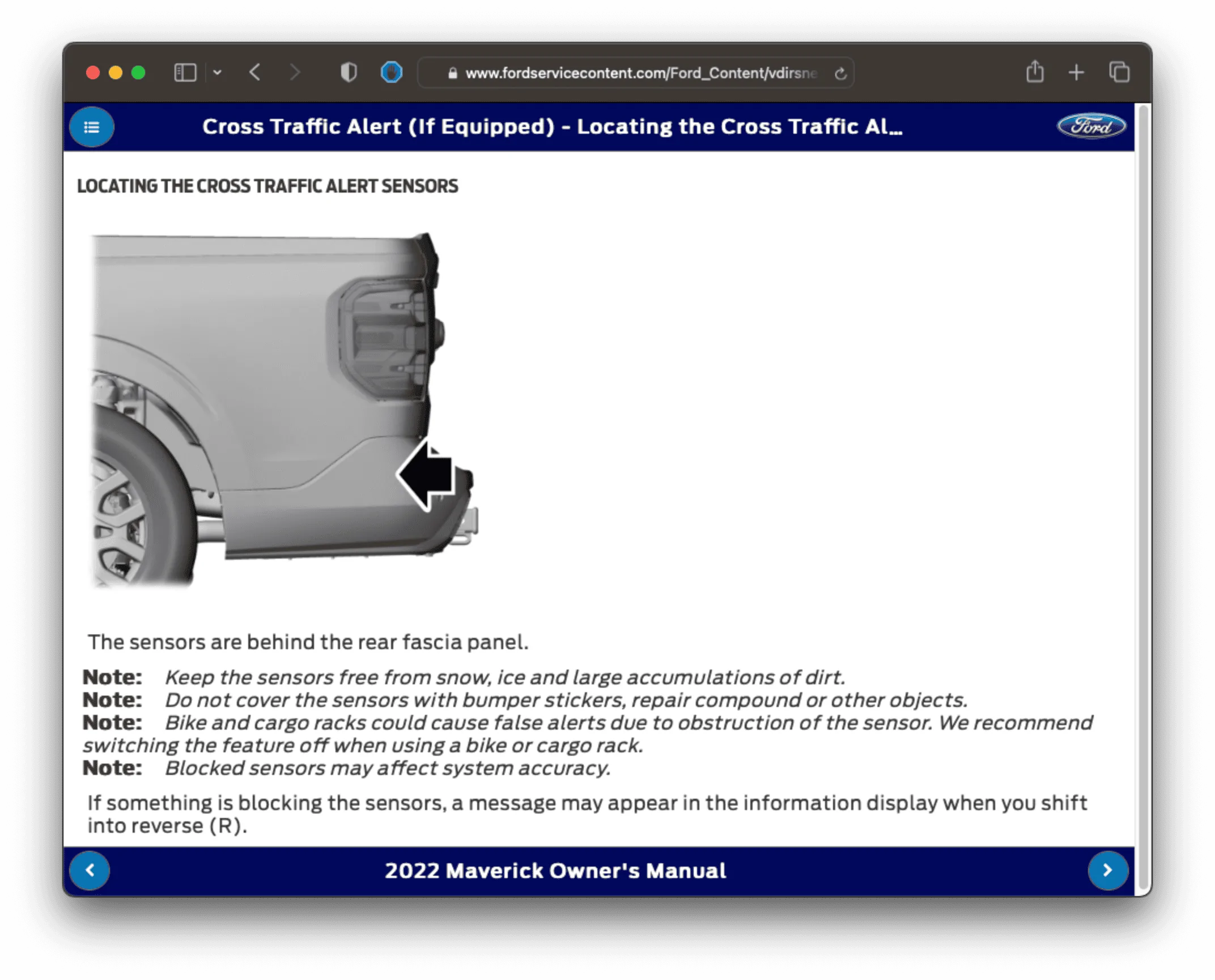

Where are the sensors for Blind Spot detection?

I don't see any cameras or proximity sensors on the sides.

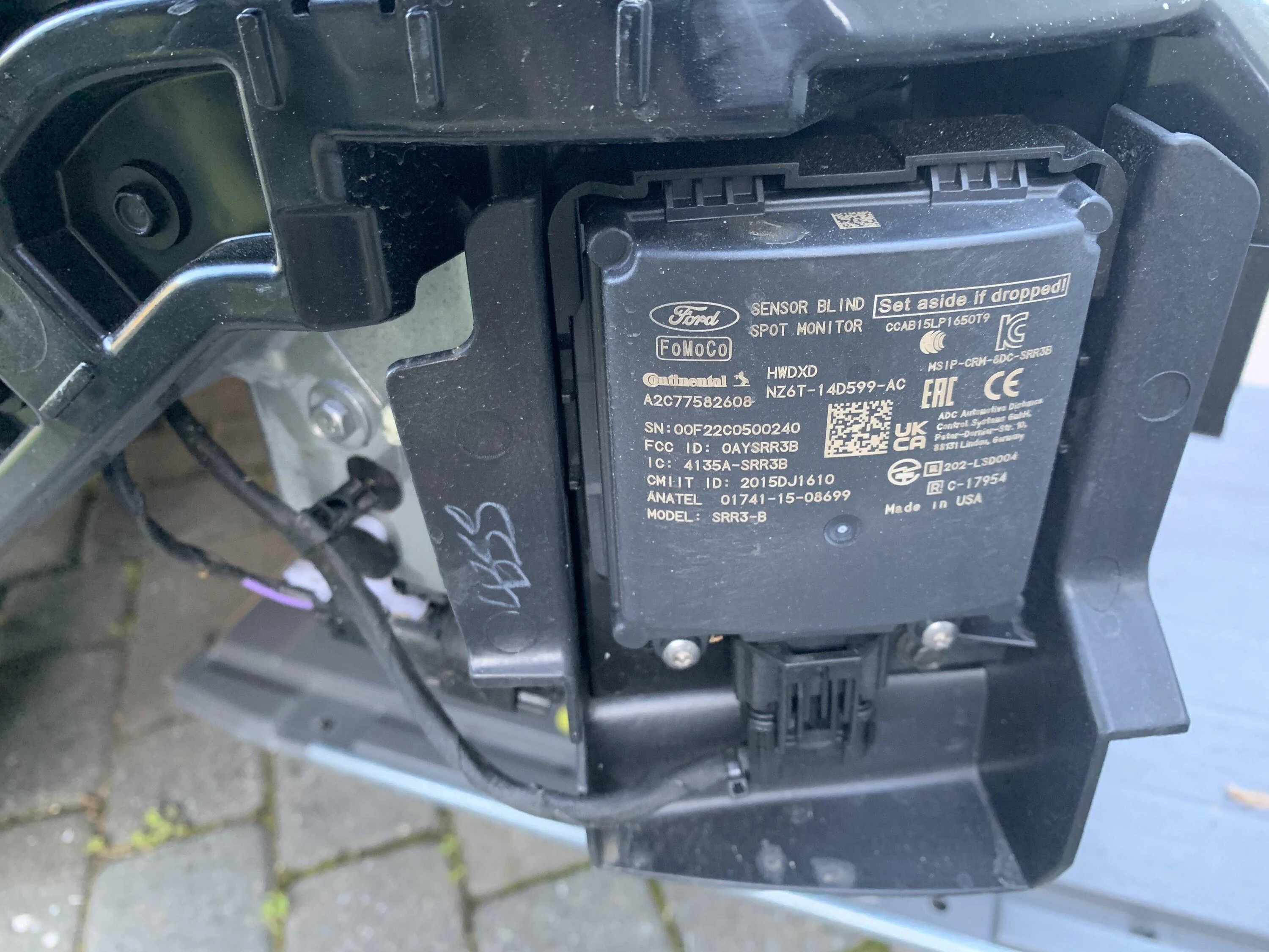

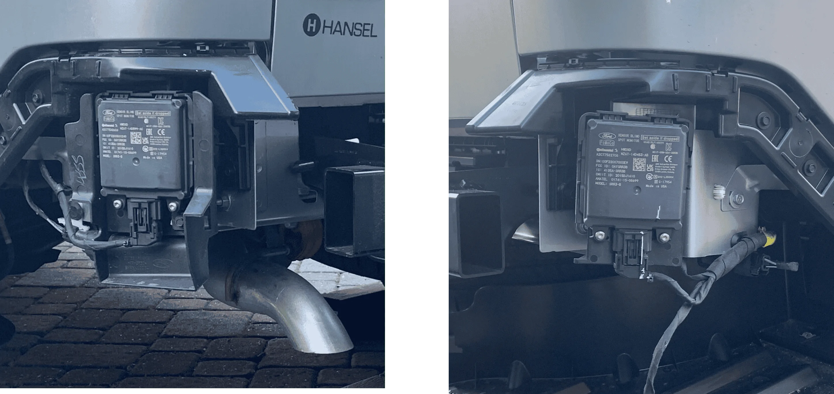

I'm repairing a salvage '23 Maverick with tailgate and right quarter panel damage. I noticed the left rear radar has a sort of protective plastic cover around it while the right radar does not. Any thoughts as to why? Perhaps exhaust heat?

You won't see them from the outside. Sensors, not cameras. See your manual...

Probably to help shield it from road spray as that side is more open. Compared to the passenger side which has the fender well more sealed off and the plastic piece covering the lower bumper cover.

I should have thought of that. Thank you.
