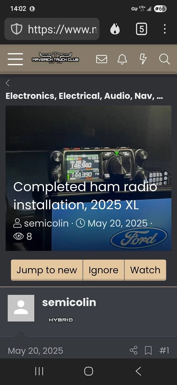

This thread may be of assistance, and also someone who may be able to help...
Ford Maverick RF Grounding and Bonding Screenshot_20250603_140256_DuckDuckGo
Hope this is of assistance,
Andy
I literally posted in that thread with my own current setup. That thread is not a HF install and as such there's no mention of the topic of grounding or bonding...
