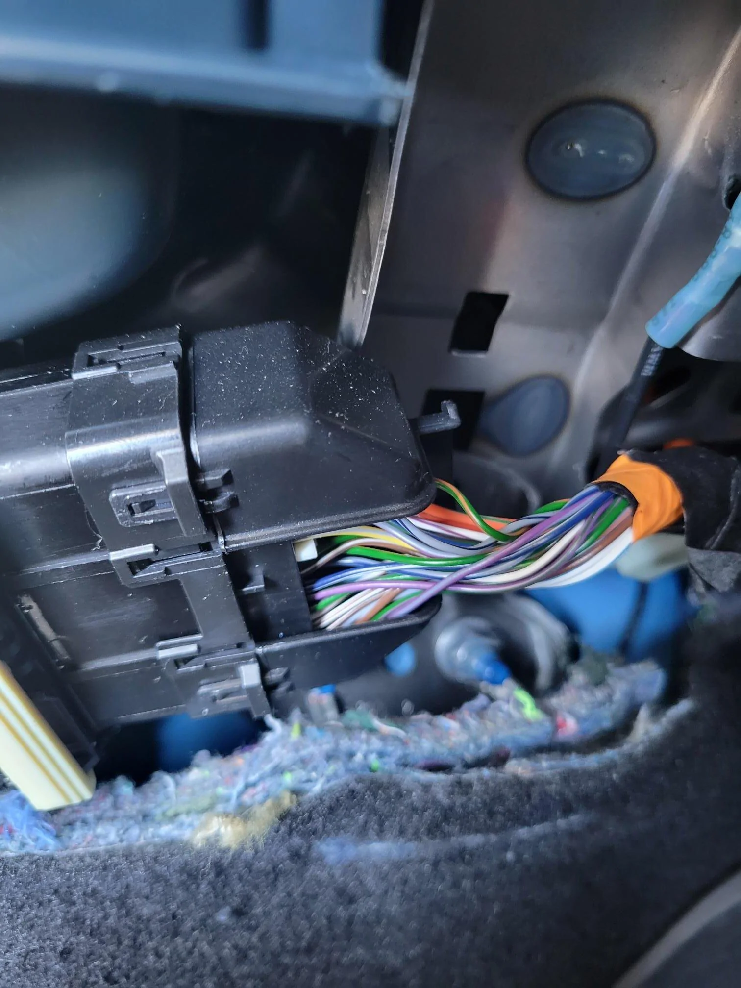

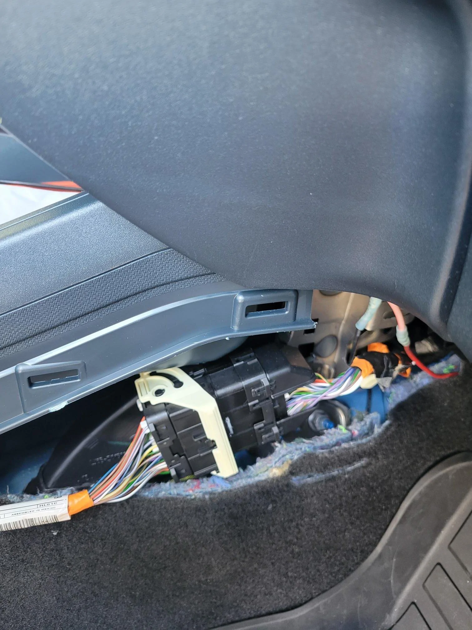

Correct fuse 24 is not switch controlled and is at battery voltage always. The acc outlet connects to fuse 24, the acc outlet connects to solar controller battery connections + and -, and solar controller connects to solar panel on dash or where ever to get sun. The solar controller acts as the "brain" to pass current to battery depending on voltage, available solar current, and or a selectable time schedule.
Picture of grounding 13mm bolts under passenger side console panel. Now to buy MICRO 2 fuse taps since I only have mini size.
Ford Maverick Good Grounding point under dash 20230503_154556
Ford Maverick Good Grounding point under dash 20230503_154629
