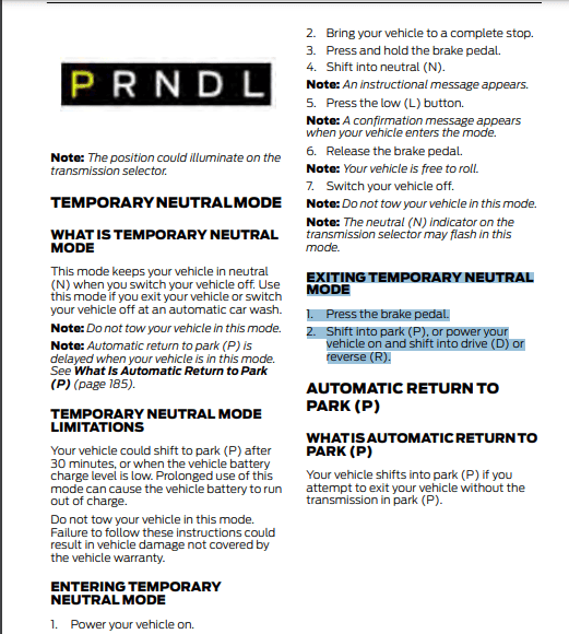

Do i put on the breaks then switch to L.
And when i get out of the wash do i put in N or Drive?

If you have to get out of car in wash you put in neutral and push down on L lt locks in neutral when you get back in you have to push break to release if you are staying in car all you have yo do is put in neutral

Refer to Owner's Manual, Page 185 on Temporary Neutral.
Highlighted from page 185 of the Owners Manual if you exit the vehicle for the car wash. The other option is to stay in stay in your vehicle, keep the vehicle in Neutral while the truck is running. If you exit the vehicle while the vehicle is in neutral, it automatically returns to park, and most car washes want you to leave the vehicle in neutral.
