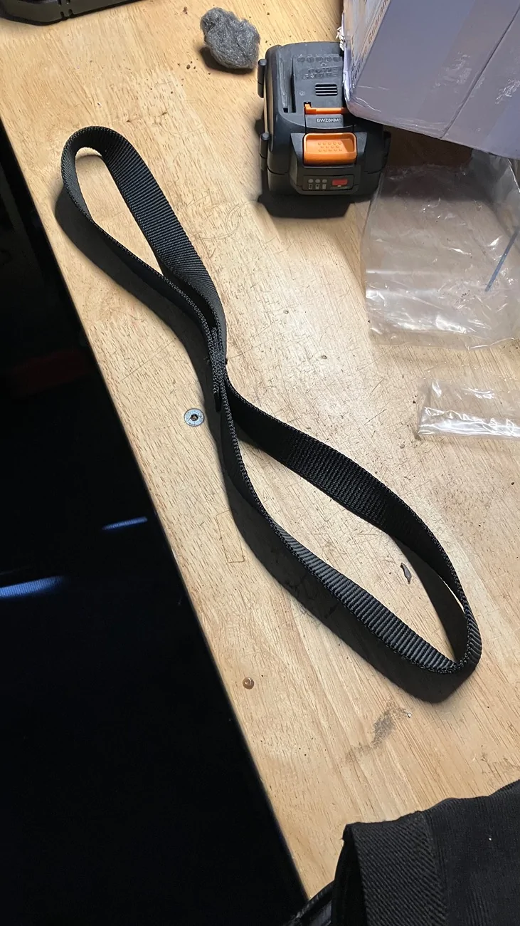

To keep the flat tire in the bed

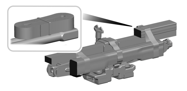

Extra one of these straps that got left?
  1. Turn the wing bolt on the jack bracket counterclockwise to release the jack and tool bag from the jack bracket.
Ford Maverick What is this strap? Screen Shot 2025-11-17 at 7.58.39 PM
Or as I thought about it - I think I did recall seeing a strap.
And due to that long bolt above - I'm not going to go check.
But...
Stowing the Road Wheel
  1. Place the flat tire in the center of the vehicle bed with the wheel facing up.
  1. Locate the retainer strap mounted on the jack.
  1. Locate the cargo tie-down hooks in the corner of the bed.
  1. Push the loop of the retainer strap through the tie-down. Thread the non-loop end through the loop.
  1. Weave the retainer strap through the wheel openings.
  1. Locate the tie-down at the opposite corner of the bed. Thread the retainer strap through the tie-down and pull tight.
  1. Secure by tying a 2-half hitch knot.

This strap came in a bag along with my new 2025 Maverick. There was no explanation as to what it used for. Can anyone help me out and tell me what this is for?
Thanks

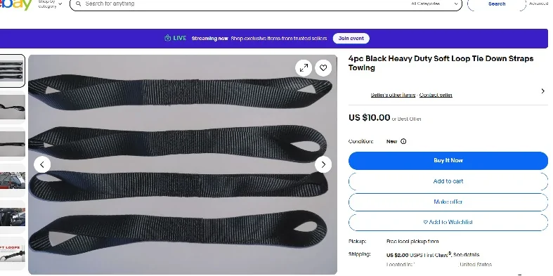

Looks like this....
Ford Maverick What is this strap? Holddown stra

To secure a flat tire in the bed after installing the spare
