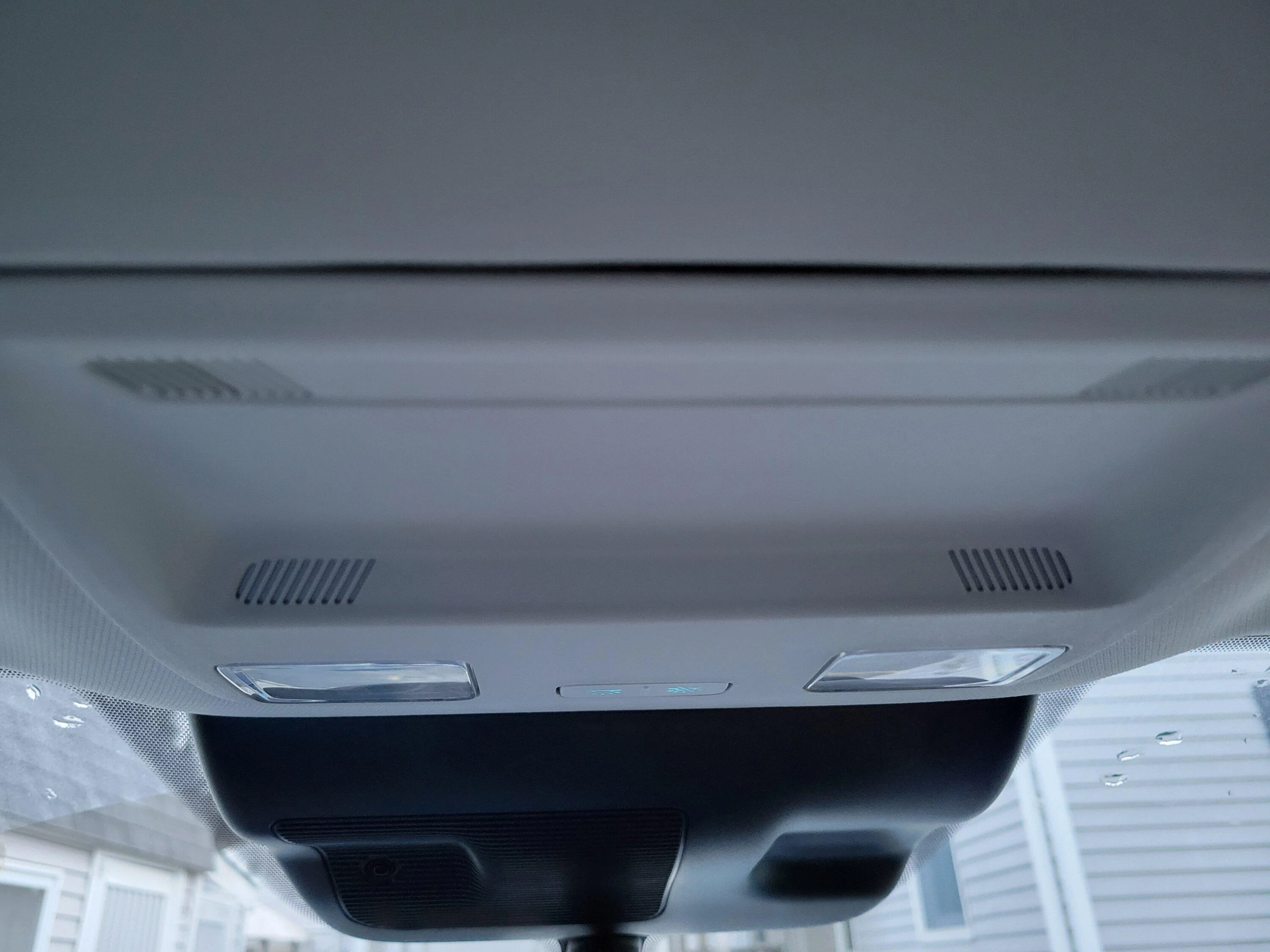

I bet you thought this issue was dead. I have read through all of the threads regarding the "missing interior sensors". Your posts are very well written and informative. I had decided not to use Forscan to enable certain features because it appears you are correct. However, today while sitting in my truck waiting for someone I looked up and could clearly see where the four interior sensors would be if they were installed. The picture below shows four "grid" areas that the sensors would be installed. The next two pictures are from a Ford F150 and definitively show that the sensors can be placed behind these small "grids" in the overhead console. Before I investigate further, I just wanted to know if you have pulled out the console to see for yourself.

Update: I removed the overhead console. You can clearly see where the sensors would be attached but they are not there. To be fair, Ford never implied the presence of any interior sensors or anti-theft system in any of their marketing literature, ordering guides, window stickers or packaging guides. They always used the words "Perimeter Alarm" and "Securilocks".
Below is a summary of the security/alarm system:
FORD MAVERICK 4 PART SECURITY SYSTEM
1SECURILOCK (PASSIVE ANTI-THEFT)XLXLTLARIAT
Prevents use of incorrectly coded key to start vehicle
2PERIMETER ALARMXLTLARIAT
Unauthorized opening of door, hood or tailgate
Unauthorized attempt to raise truck (Inclination)
Unauthorized disconnect of battery or battery back-up
3ANTI-THEFT (Factory installed option*)***
Sensors in overhead console detect interior movement
*Was not available for '22, '23 or '24
4PERIMETER PLUS (Factory or customer installed option)OptionOptionOption
2 stage shock sensor detects impact to glass or body
$285 for part
$60 for installation
