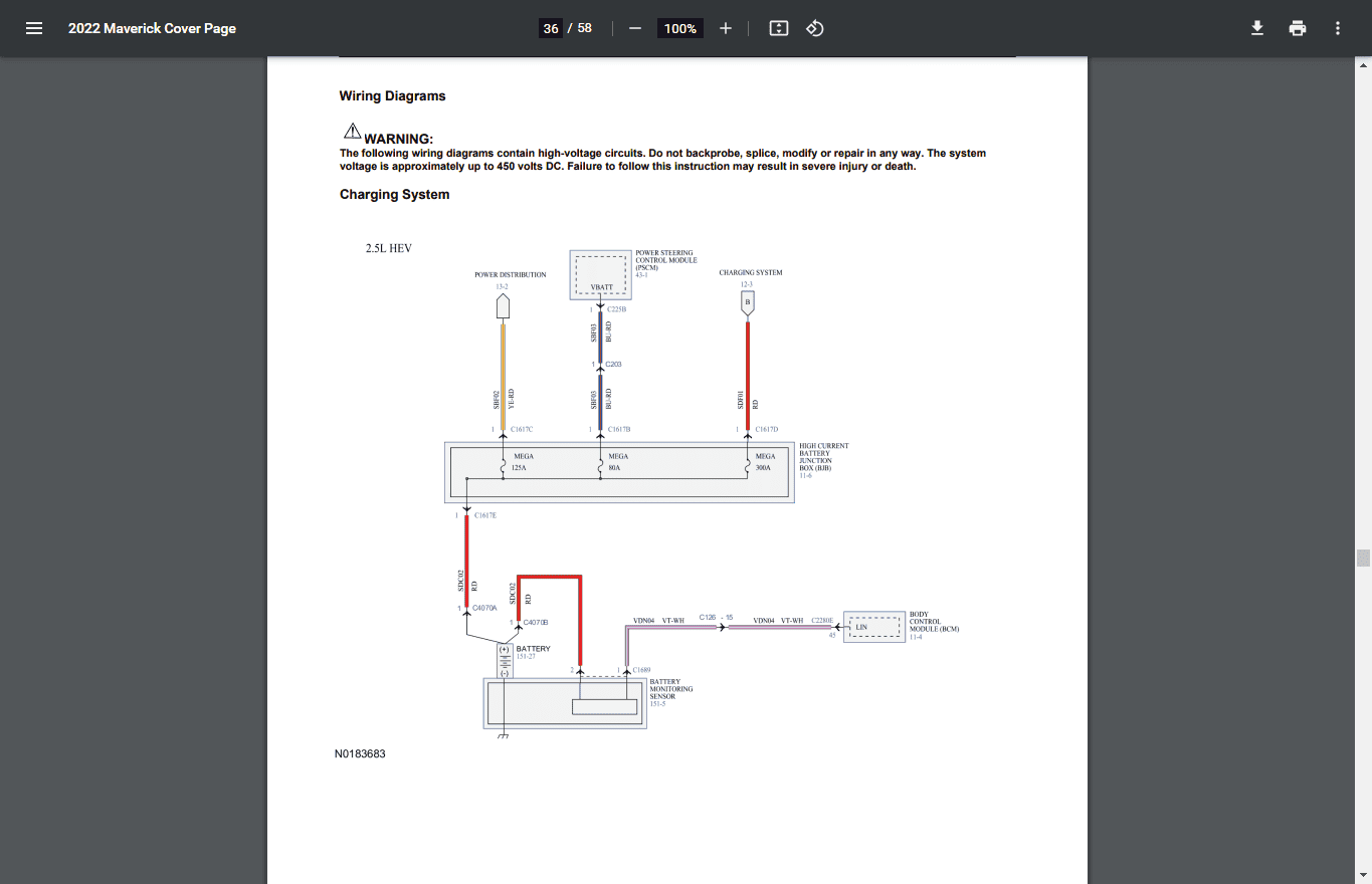

I've seen the factory schematics showing a 300 amp fuse on the charging output of the DC to DC converter. That's very robust so I don't see any problem running a 1000 W inverter. With inverter losses and all I don't believe it will pull anywhere near the max. Volts x Amps = Watts, so 12 VDC x 83 Amps = 1000 Watts output (not counting for converter losses) So if you have ignition on and all accessories off, lights, AC, HEAT, wipers, etc. there's plenty of power to run the inverter. Your pure sine wave inverter of course is more effecient than my modified sine wave, but they both get the job done.
Thanks. That is the kind of news we have been looking for.
I have seen other hybrids reporting a 100A fusable link on the DC-DC converter output.
A 300A fuse gives me a warm and fuzzy feeling that my setup will work and be safe.
I am planning a 100A fuse between the battery and my inverter.

Right, that's where I found the 300A fuse on the charging circuit. I wouldn't recommend putting a 1500W continuous load on an inverter, but for light loads with some surge current to get going like a mini fridge should be fine. The 400W factory inverter is very limited by the tiny 12V wiring and 15A fuse.
www.fleet.ford.com_content_dam_aem_fleet_en_us_fleet_resources_2022-2023_Maverick_Hybrid_Modif...png
Fresh eyes are great. I had the document I needed in hand and didn't know it.
I had reviewed the Modifiers Guide various times as late as today and just passed over this page thinking that it was just for the high voltage side.
Thanks.

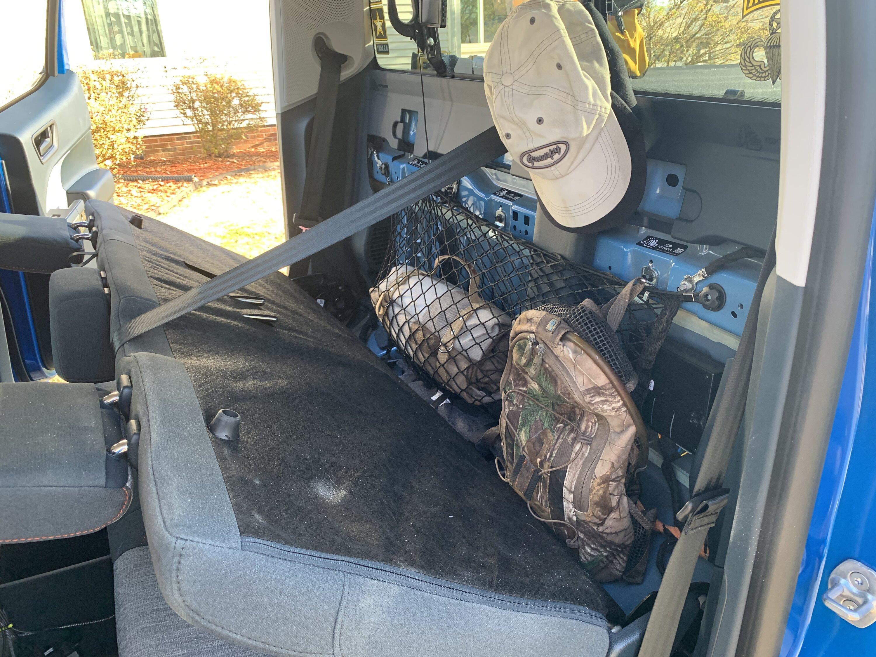

I have been looking to make use of the available space behind the rear seat. Just today, I attached an elastic cargo net to the back wall of my Maverick. I purchased the net from Amazon. It was advertised as 31” x 15”. I stretched it out to about 36” between the two upper attachment points. These are screwed to the back wall. The lower corner attachments are attached with double sided tape only. As is, the net does not interfere with the seat latching mechanism or the three upper child restraint anchor points. Most of everything I keep in the truck’s cabin is stored either in the two rigid Molle seat back organizers or under the rear seat. For now, the net holds only a rolled picnic blanket and my ice/snow brush. To start, I’ll add a hooded sweatshirt and light rain jacket. Also, my day pack with water bladder is D-ringed to one of the child restraint anchor points.
I picked up my ford maverick yesterday. A hybrid at $26k. Great value IMHO. I bought the same net to put behind the back seat, but noticed that it doesn't have the black brackets you put the netting loops on. Did you add those in or was it already installed? Thank you in advance

i Installed the anchors. The net I purchased on Amazon came with four of the plastic knob anchors. Although they have double-sided tape. the tape is insufficient to hold any weight. I mounted the two upper anchors with sheet metal screws.
