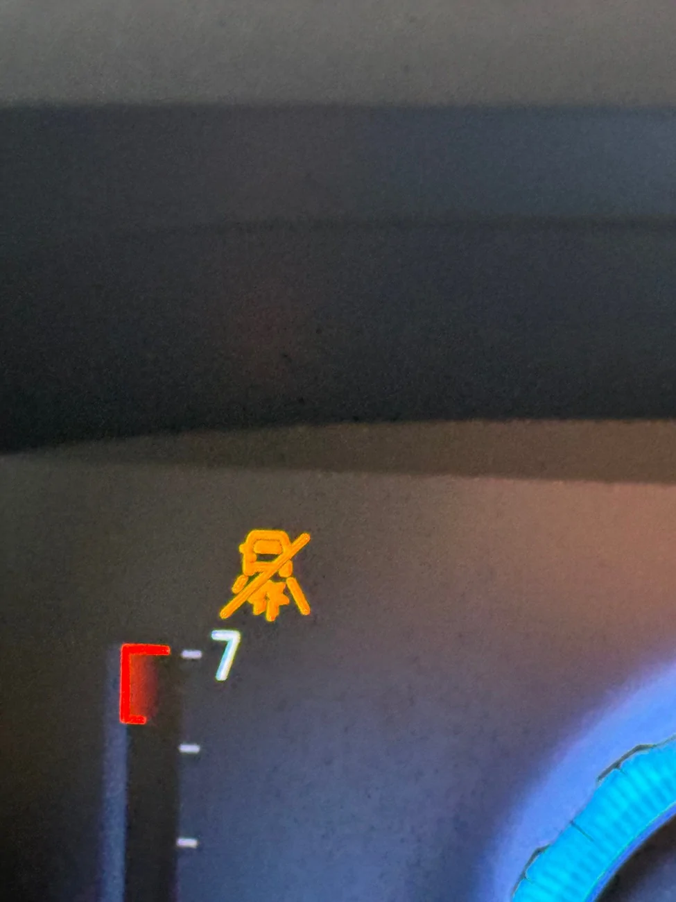

Comes on occasionally. Often followed or near the time I get the front camera blocked message.
But not sure they are related because it happens so rarely.
So
Just above the red line on the tachometer.
Was sis light mean ?
I get a front camera visibility message.
From Ford AI
**Pre-Collision Assist / Forward Collision Warning Off or Unavailable** warning lamp.
**What it means:**
It illuminates when Pre-Collision Assist (including Automatic Emergency Braking) is switched off, unavailable, or temporarily degraded due to external conditions (such as mud, snow, ice, or bad weather blocking the front radar or camera sensor).
**What to do:**
1. Check that the front windshield near the rearview mirror and the front bumper/radar area are clean and clear of snow, ice, or debris.
2. In your vehicle's touchscreen, go to the **Driver Assistance** menu, select **Pre-Collision Assist**, and ensure **Automatic Emergency Braking** is switched on.
If the sensors are clean and the setting is on, but the light remains on with an information message, have your vehicle checked by an authorized Ford dealer.
So

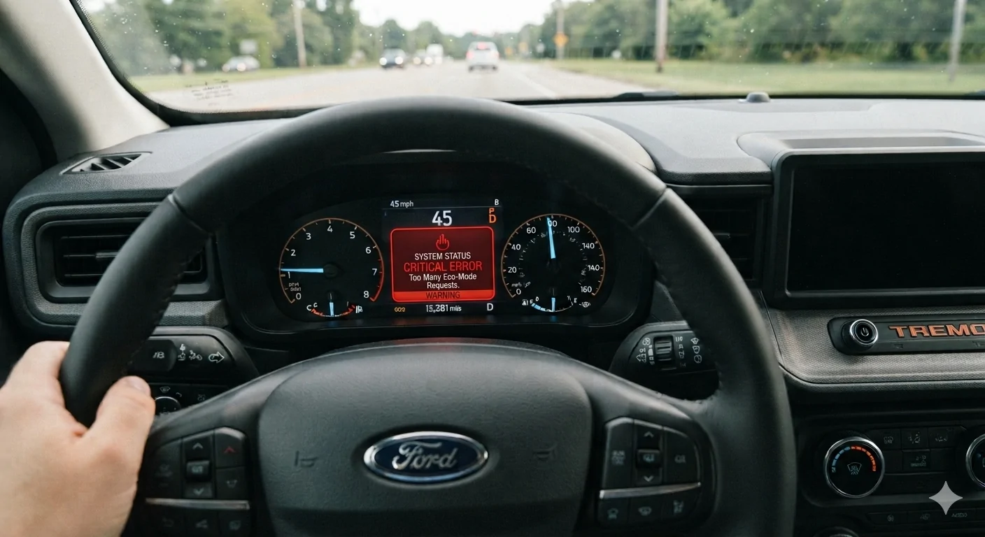

My guess would have been the oil slick dispenser reservoir needed refilling, but apparently not. 😬
My Tremor will never be driven in Eco mode !
Thats an absolute disgrace in a Tremor !
Don’t Do It !!
:’P
So

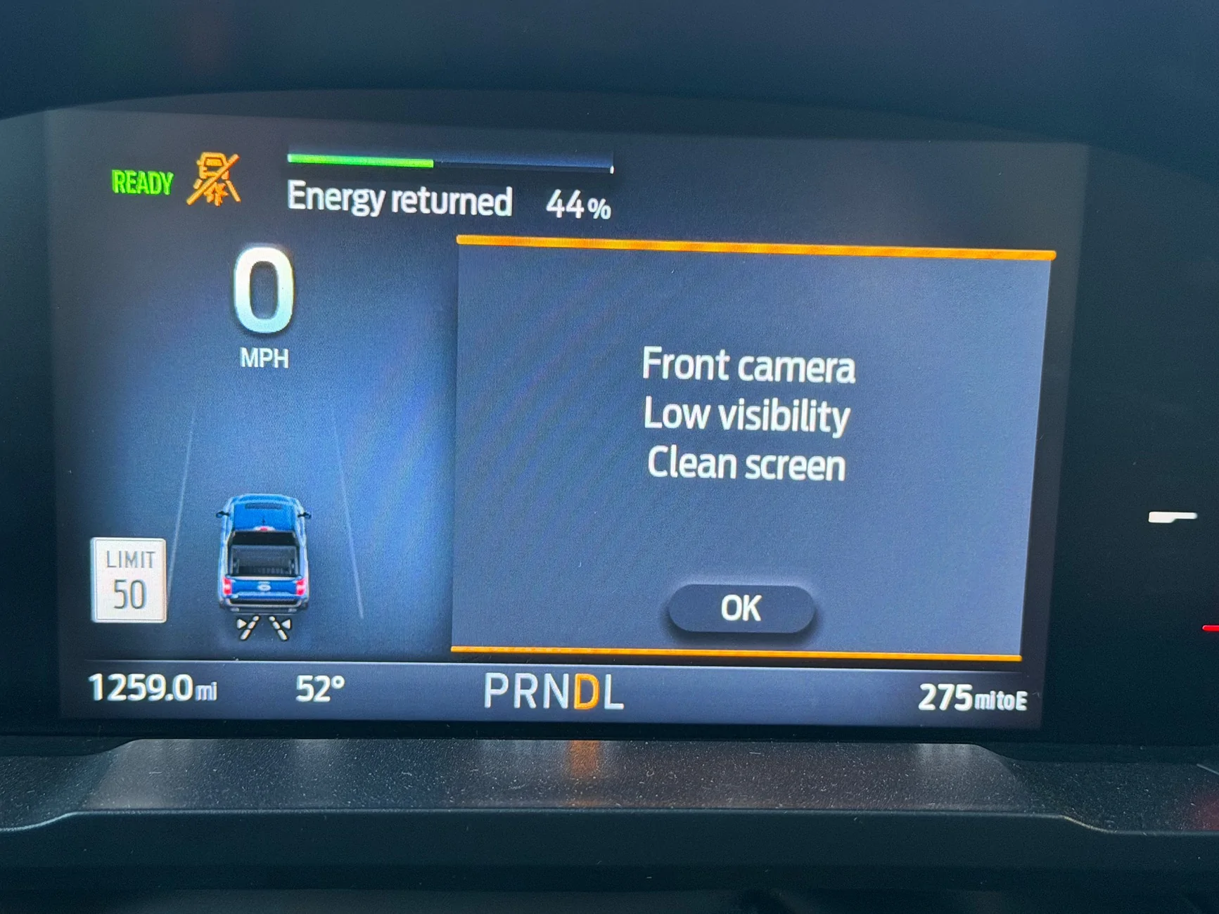

I also had this come up on mine when the temps were cold outside!!

My 2024 Ranger would get this on mornings with either heavy dew or frost on the windshield. Would go away after a few minutes i think there is a heating element for the sensor to help with it

I lose camera related systems fairly frequently during glass condensation / frost related weather events. I assume what is covering my windshield may also be covering the camera lenses until it clears up after driving for a bit.
