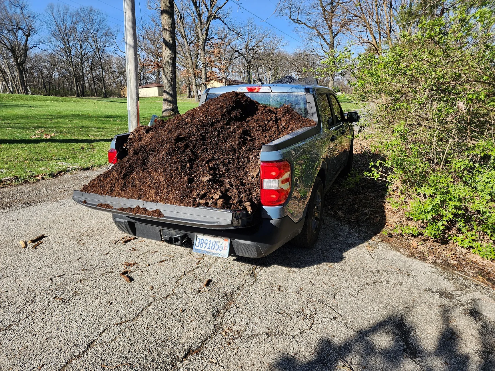

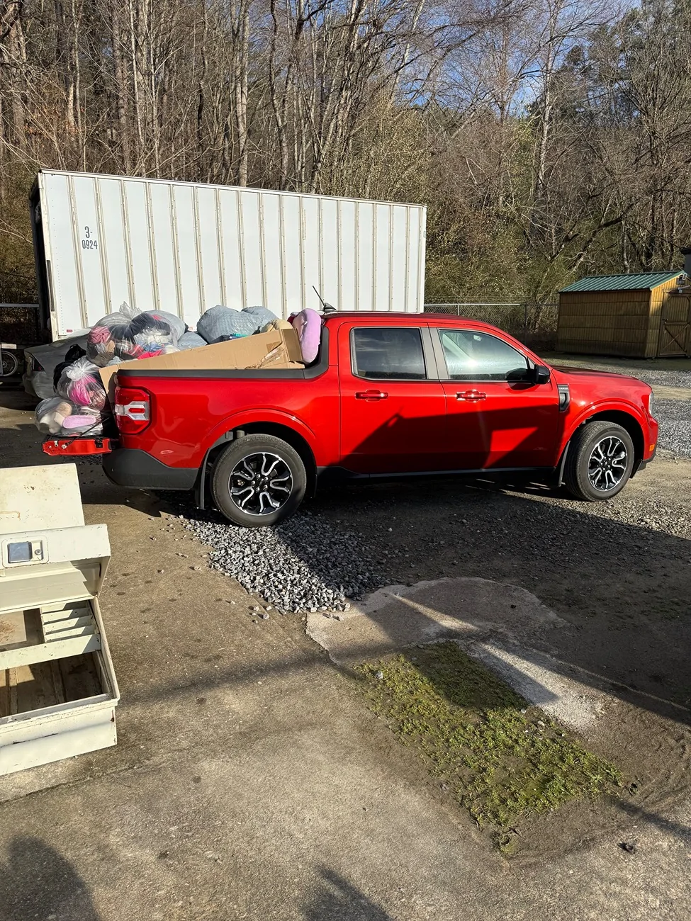

Hard to explain,
At work on the property I may load my bed super full with stuff with big bags of stuff, lamps, small bits of furniture etc.
Only sometimes but often, with the tail gate DOWN, rear camera looking down,
When I’m backing up slowly nothing around to hit.
When I ease on the brakes, very softly
It locks them up thinking I’m about to hit the ground or some such nonsense.
The odd part is this does not happen every time.
Nickel for your thoughts ?
Speculation’s,
Wild guesses,
Anyone have any real knowledge on this ?
My new 2026 Tremor does this,
But here is a picture of my 2024 loaded up tail gate down.
It NEVER behaved in such a manner.
When I fill my bed like that I put the tailgate in the 'partially down' position so crap is less likely to fall off. I've never had that condition you describe. You don't have that automatic parking brake/hill hold feature on do you?
Ford Maverick Weirdness 20260411_090616
I’ll look into that, thanks.
