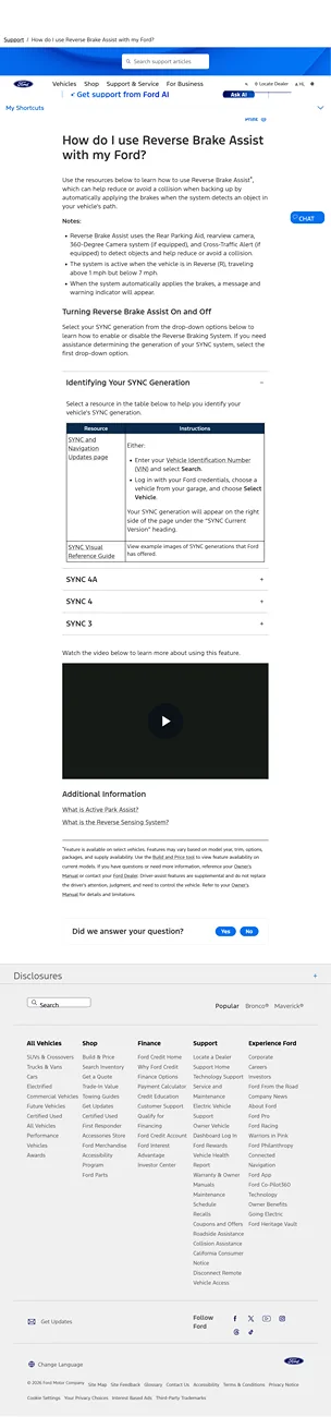

Rear break assist function
TiberiusWise
Alex
Apr 5, 2026
60
Highland Lake NY
2026 Maverick, 1978 CJ-5, 1966 Mustang
I haven't had to drive with the tailgate down but sometimes my Rear Brake Assist will engage when I'm backing into my garage. Like ScottyC suggests, try turning it off in the Driver Assist setting.
