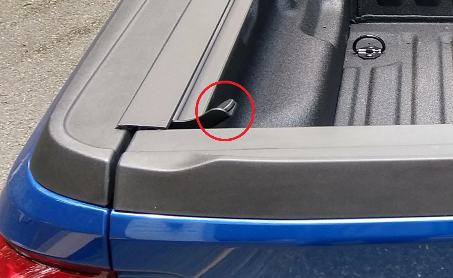

Please note that tonneau's left and right tabs are too wide and block the gate extender. The Ford gate extension will not fold in. The product sold with Ford label came with instructions from Rev Industries, part 318S0015
Ford Maverick Ford Brand Tonneau Hard Trifold Cover Tonneau ta
. If this was designed and manufactured by Ford, most likely they would have 3/8 clearance at each side to fit the extender. The Ford Tonneau fits, but t it is about 1/2 inch too short at the end at tailgate, so the rain will inside of the gate wet.

As noted above, the cover is about 1/2" or so short. Mine was installed fully forward and needed to be moved back 1/2" so the rear weatherstrip would engage with the tailgate.

Yep, that's what I had to do also. But I still get a few drops on either side of the tailgate. Tonneau cover mfg's will say that nothing is 100% waterproof.
