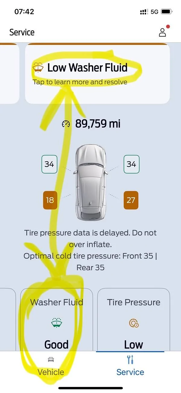

Ford Maverick "Washer fluid level low" indicator came on and off randomly IMG_6205
uhhhhh…. What in the world are these washer level indicators arguing for?
