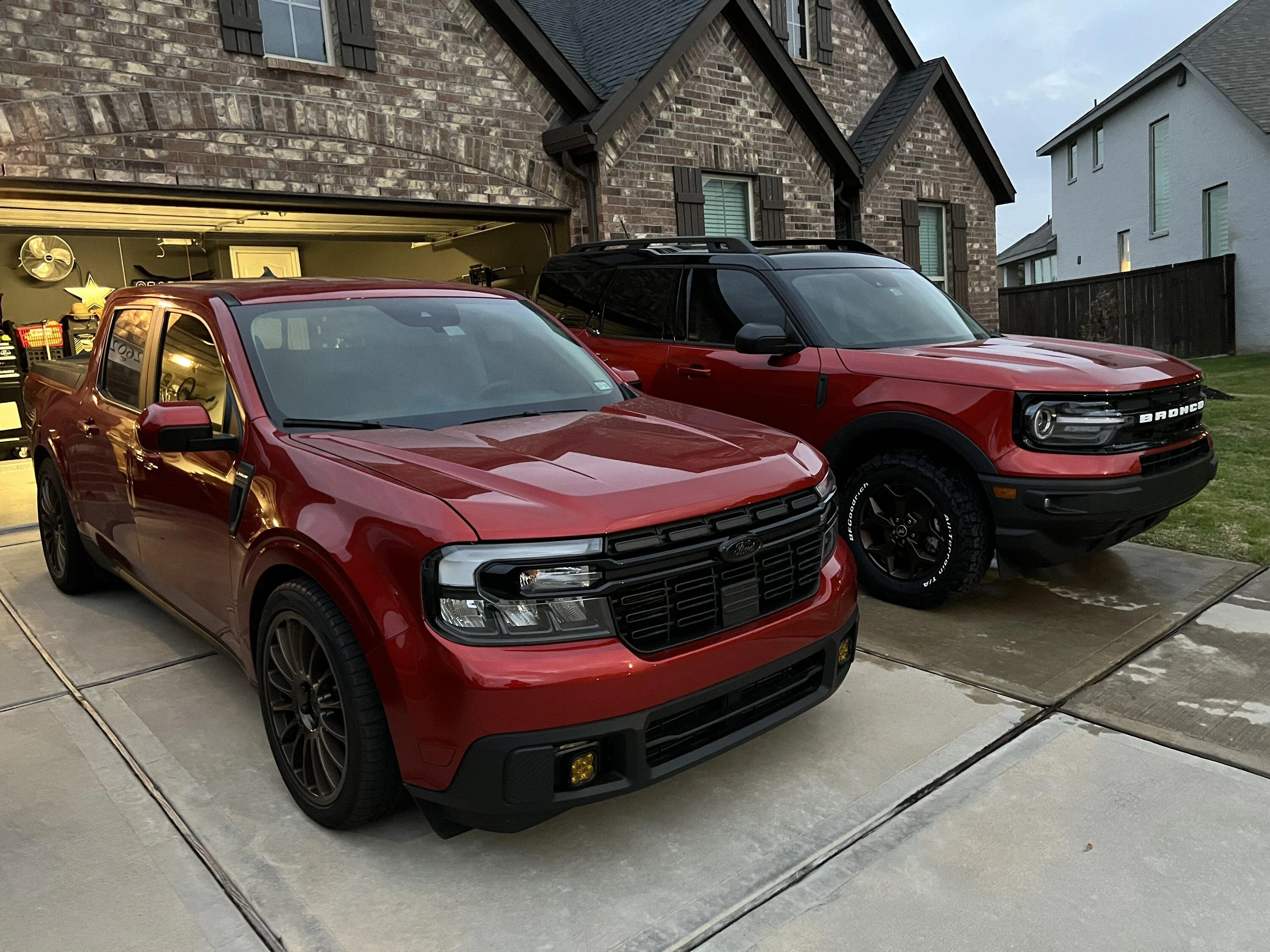

Truck is looking great! Did you use the nightshade on this badge again? Also how’s the audio coming along?
Yep Niteshades again, though this time I did it thicker and let it dry longer
Hopefully it’ll hold up better
