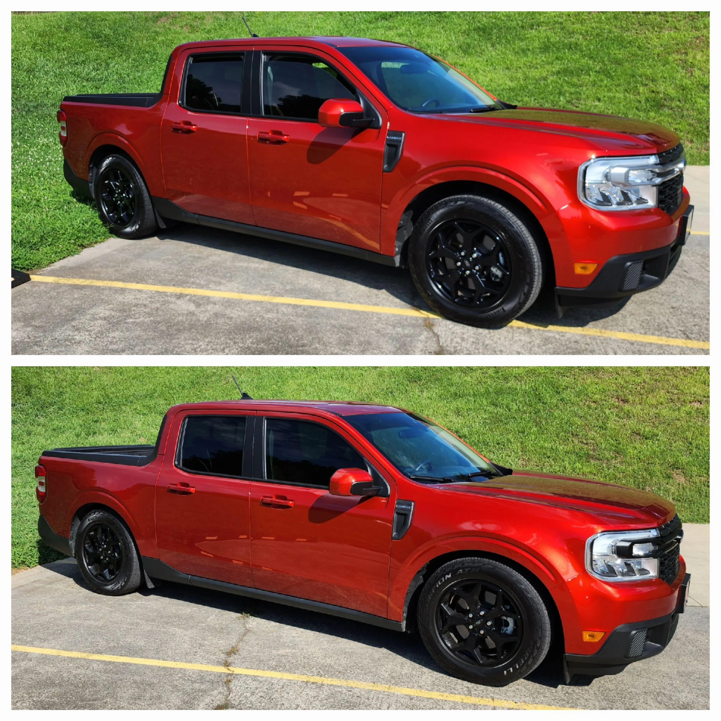

The PO had installed H&R Escape lowering springs. Which was pretty cool, but needed to be lower ;)
So I went with the Silvers, Lawrence Giles specs of course. These thing are awesome!
Before/After HR vs Silvers

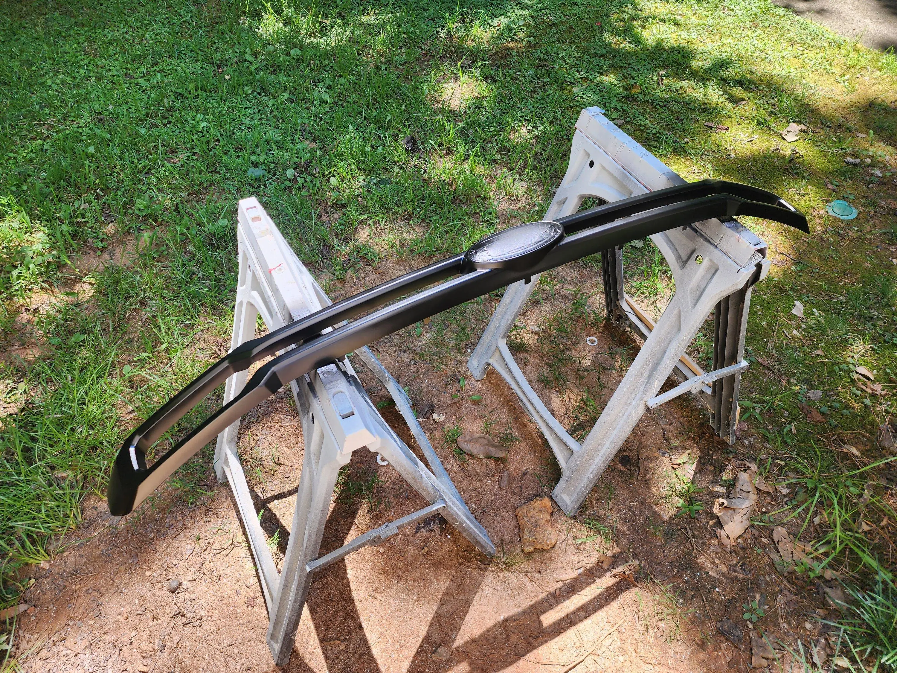

I wanted the grill bar black, so i attempted to wrap it with black vinyl, that was an epic fail LOL. So ended up pulling it off and painting it. Much better.

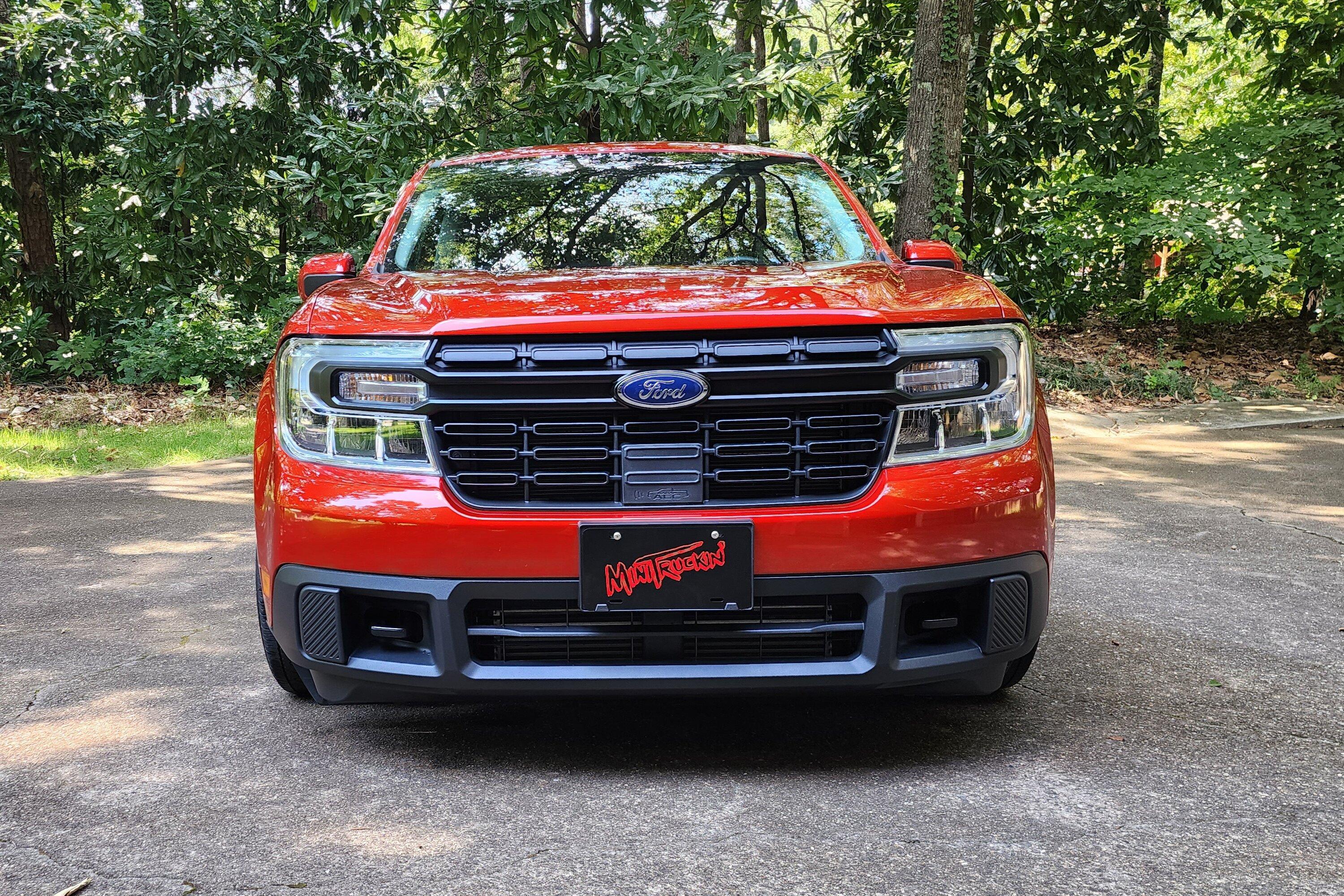

And "installed" my custom front tag :)

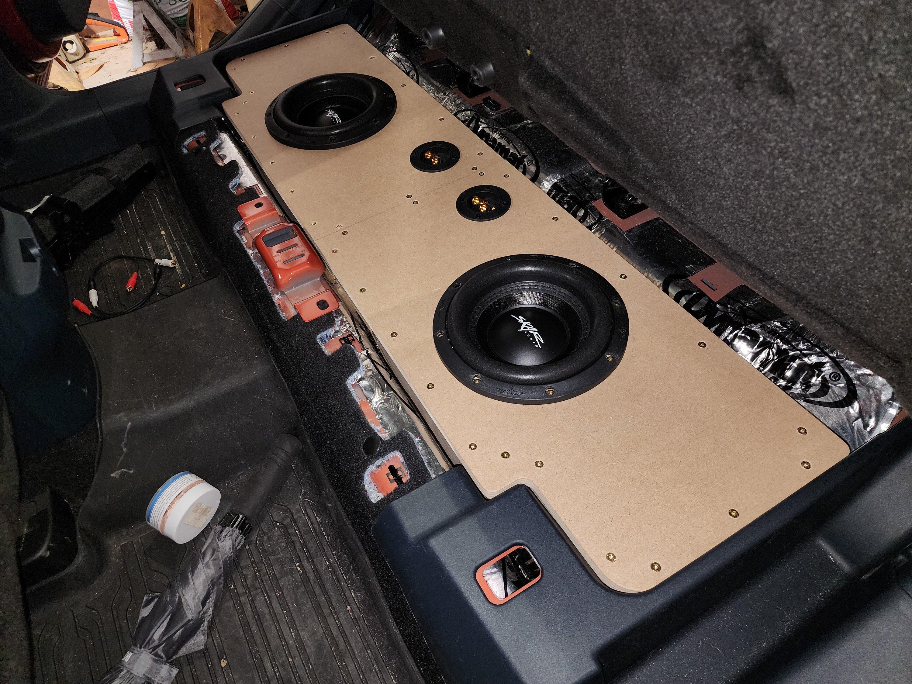

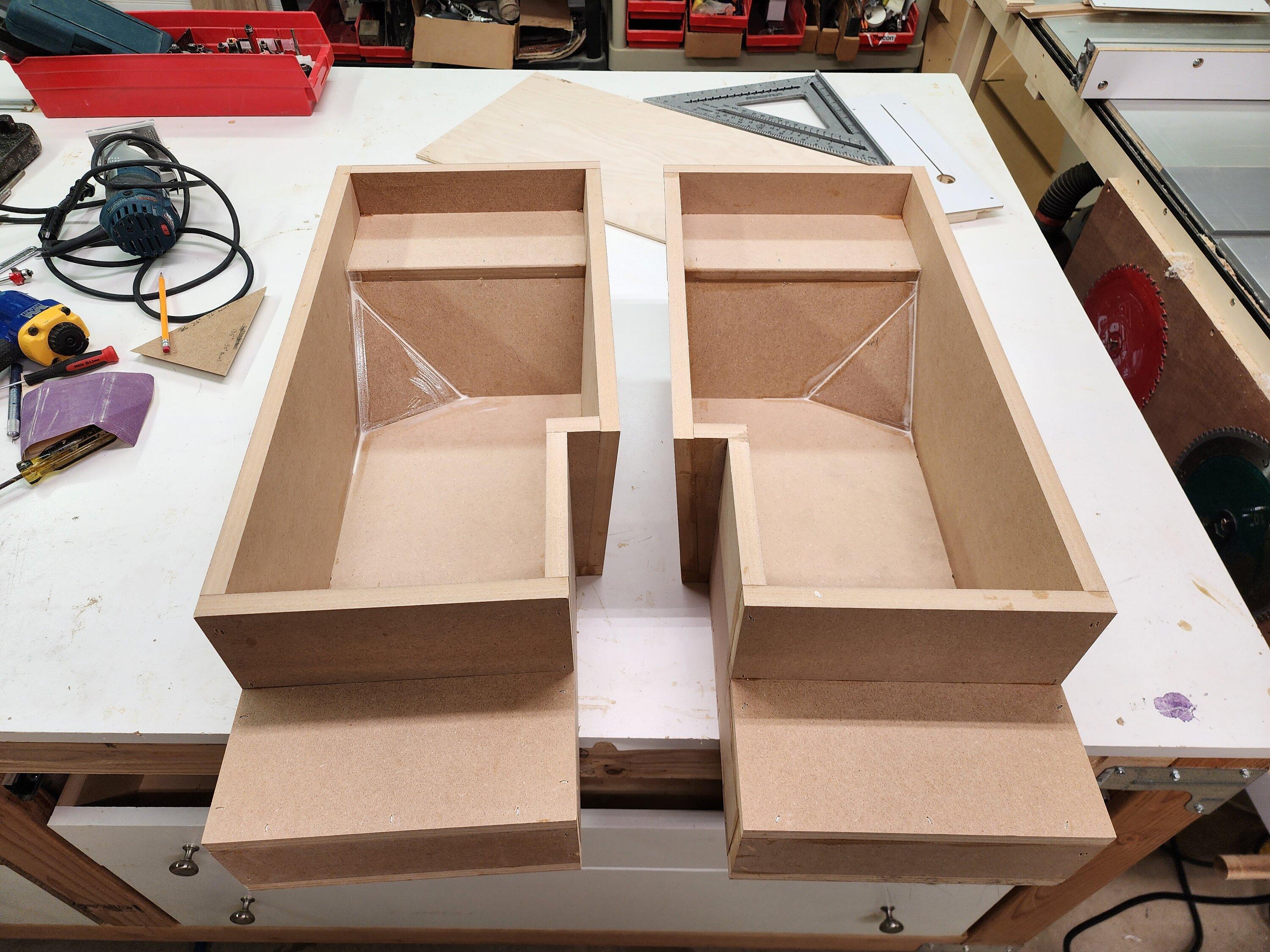

Built a couple sub boxes, having a CNC router at work is pretty cool :) boxes are about .6 cubic ft each. I used 8 inch skar SVR subs, and their 800w amp. They jam pretty good.

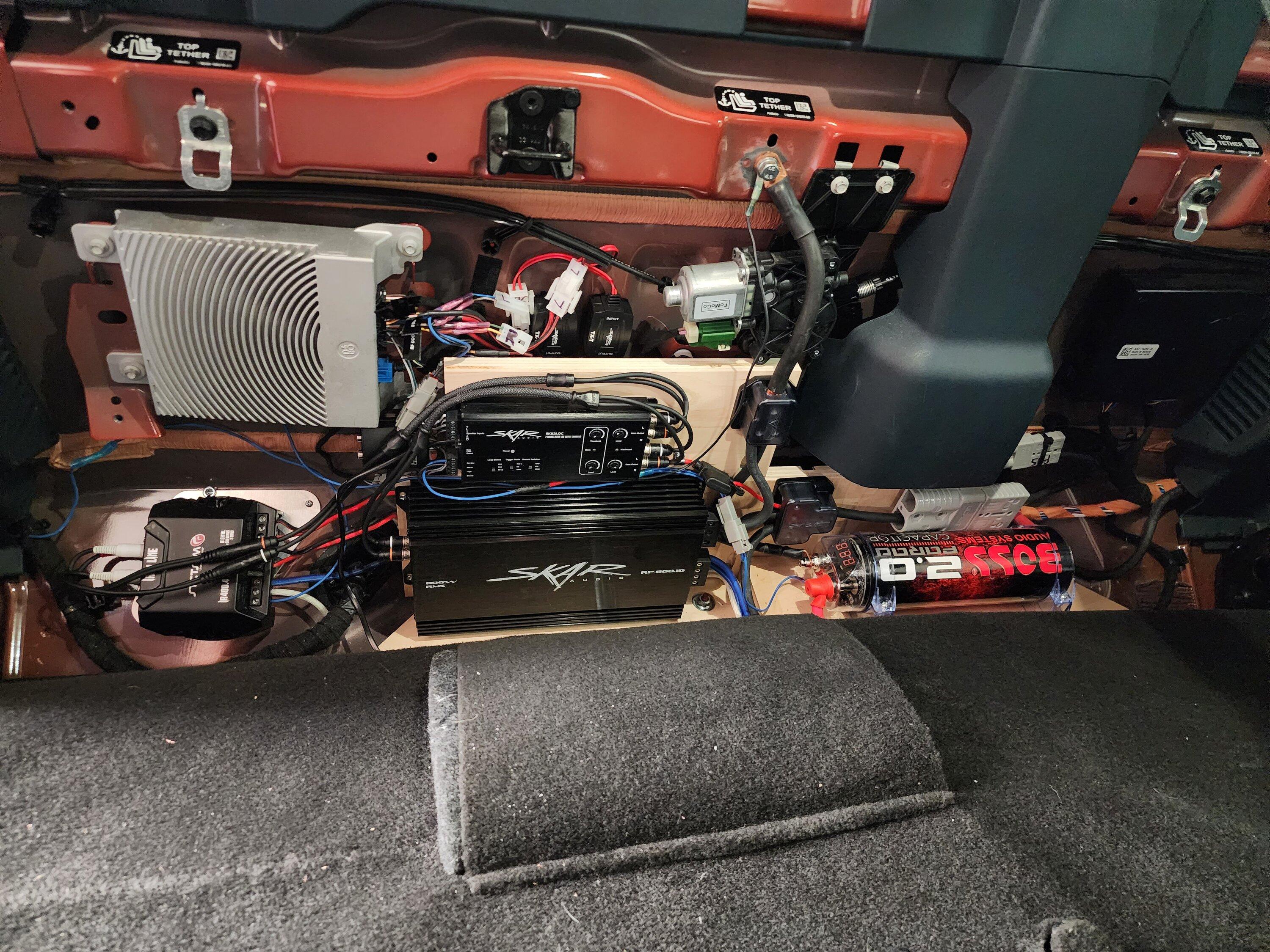

Audio stuff is still a work in progress, changed all the speakers out, added a couple amps, a DSP.

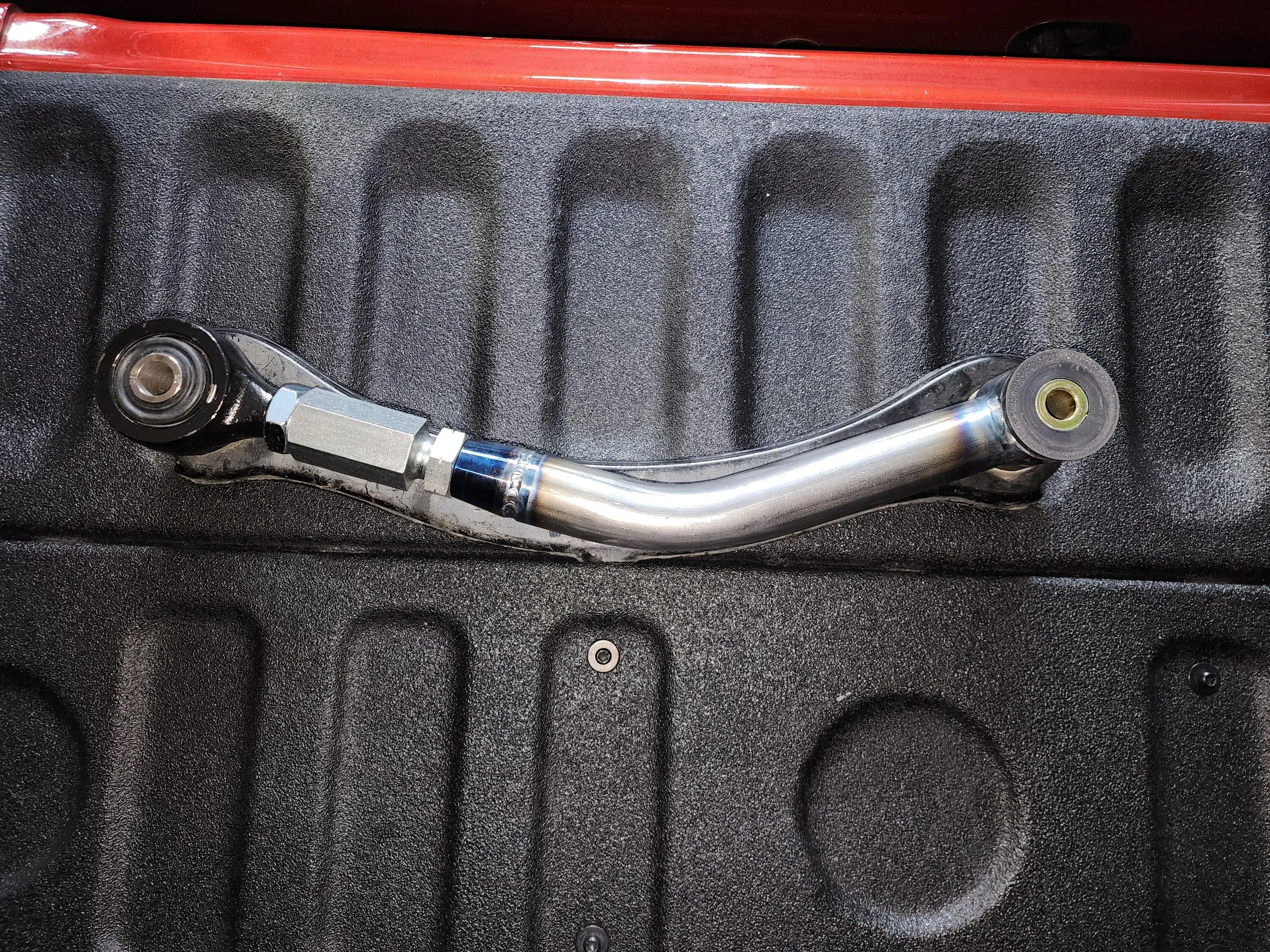

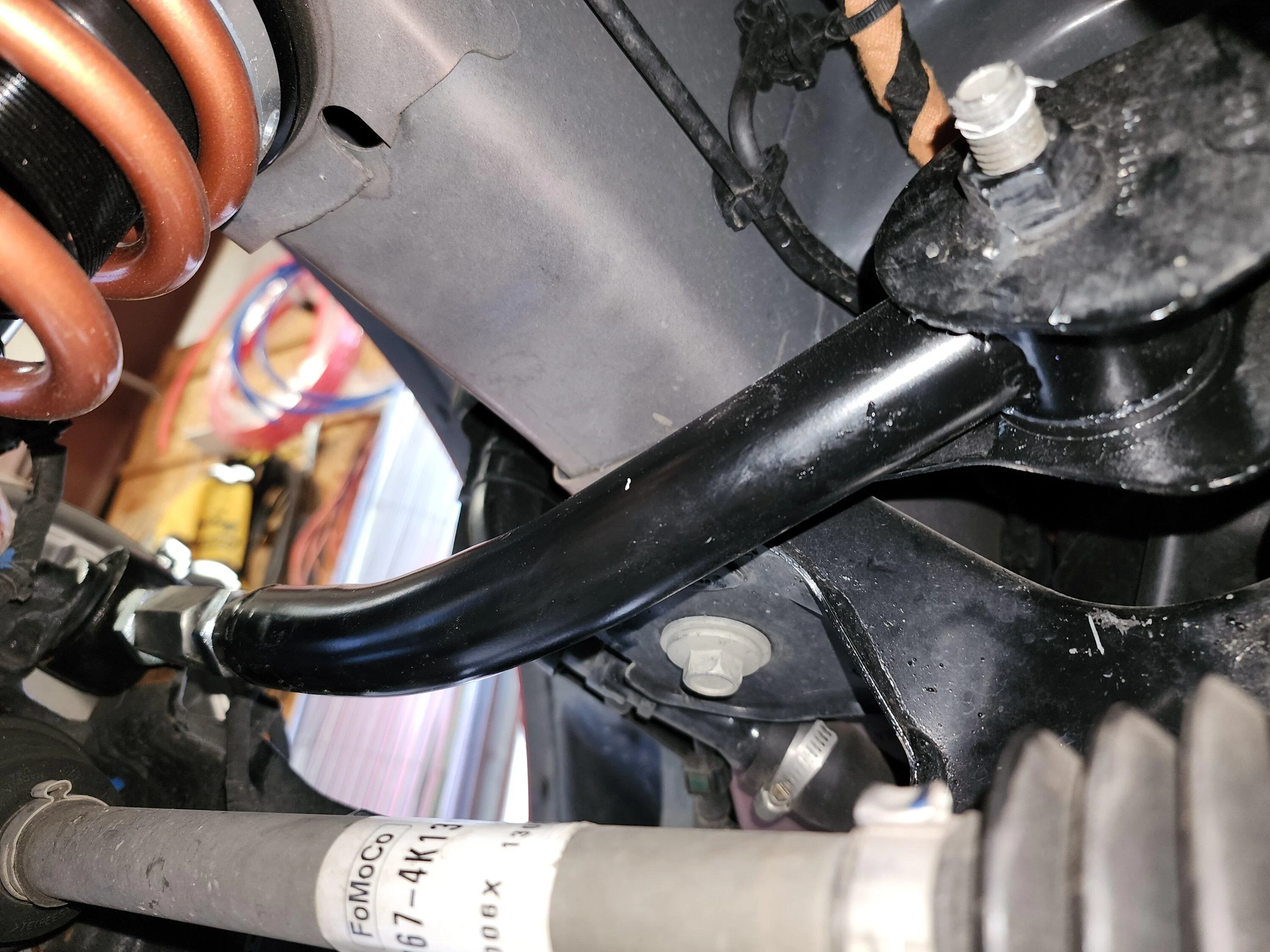

So then I had to fix the almost 3 degrees neg camber in the rear. And seeing as the only adjustable arms out there hit the frame, I made my own :)
Looks SOOOO much better in the rear, half assed "stanced" out Maverick did not look good LMAO

Hey OP, I am unable to PM you in regards to the rear control arms. Can you pm me, I have some questions about them. Kindest Regards

How much would you charge for a pair of those adjustable arms? Thanks
