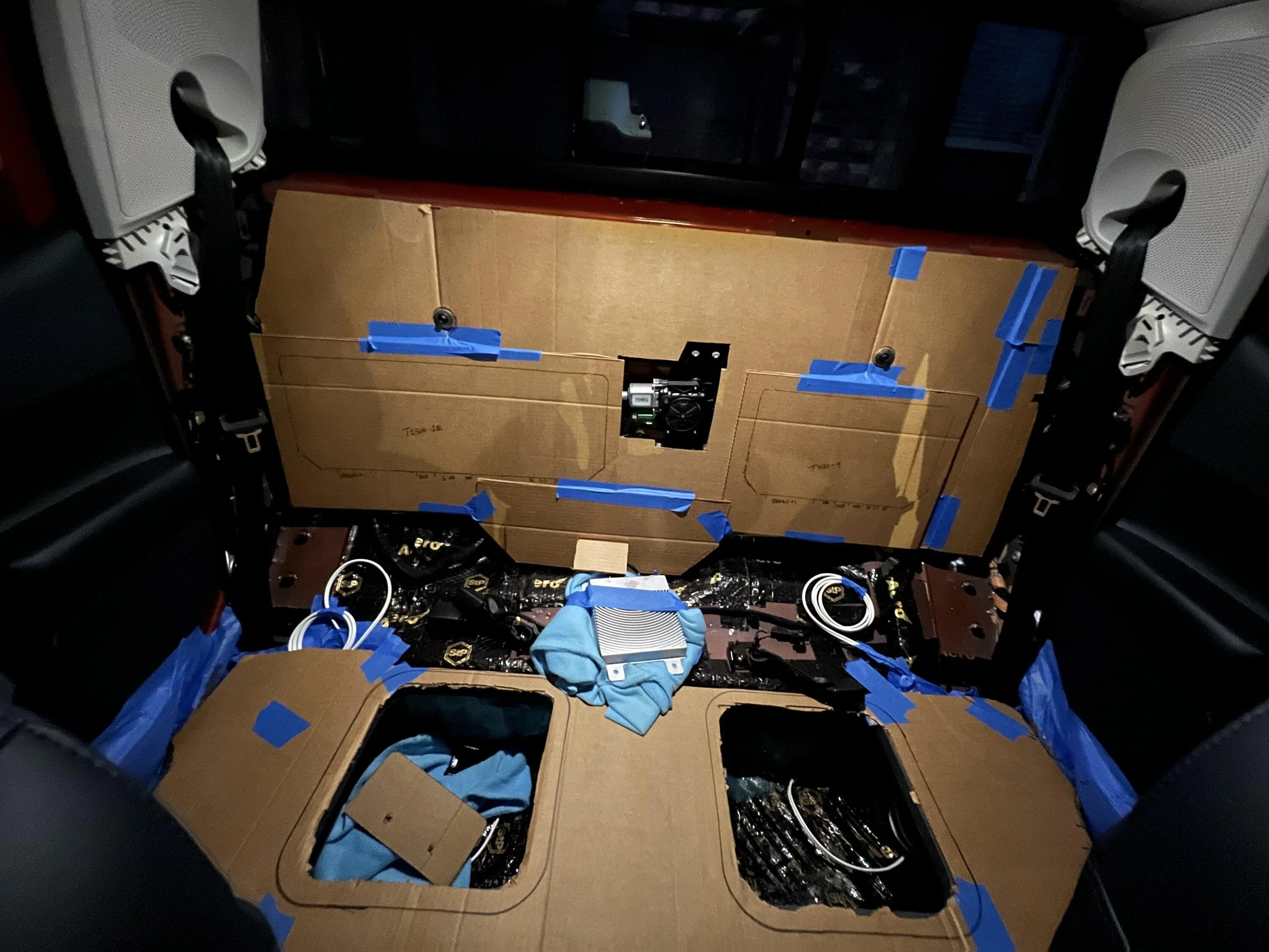

Still don’t know what I’m doing
I guess now I’ll just cut a piece of plywood to match the template and go from there

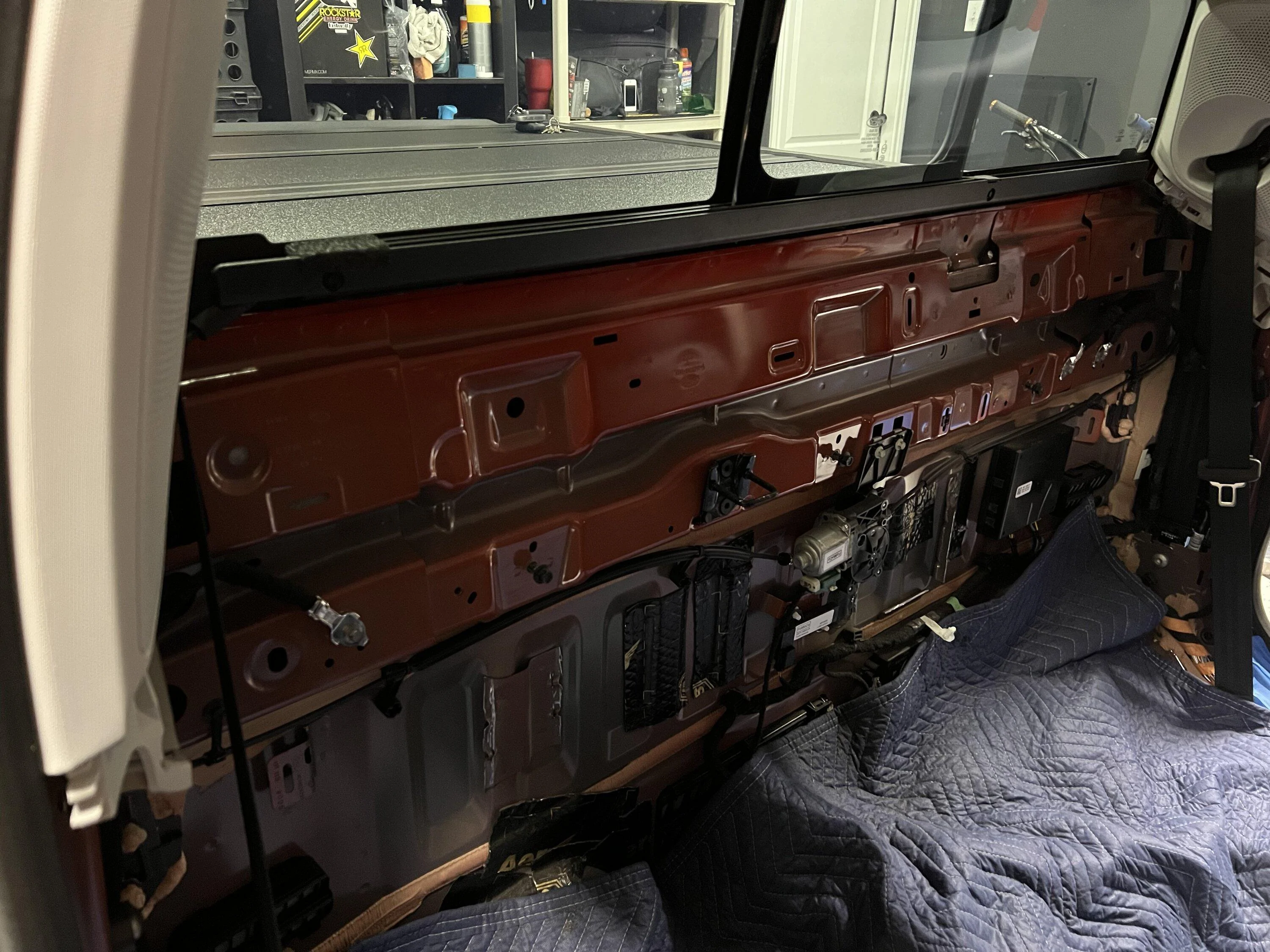

Tomorrow I’m going over to my dads house to look at his Maverick (Hot Pepper Lariat too) to remind myself how the back seat meets the trim pieces and what not
I’ve forgotten and neglected to take many before pictures

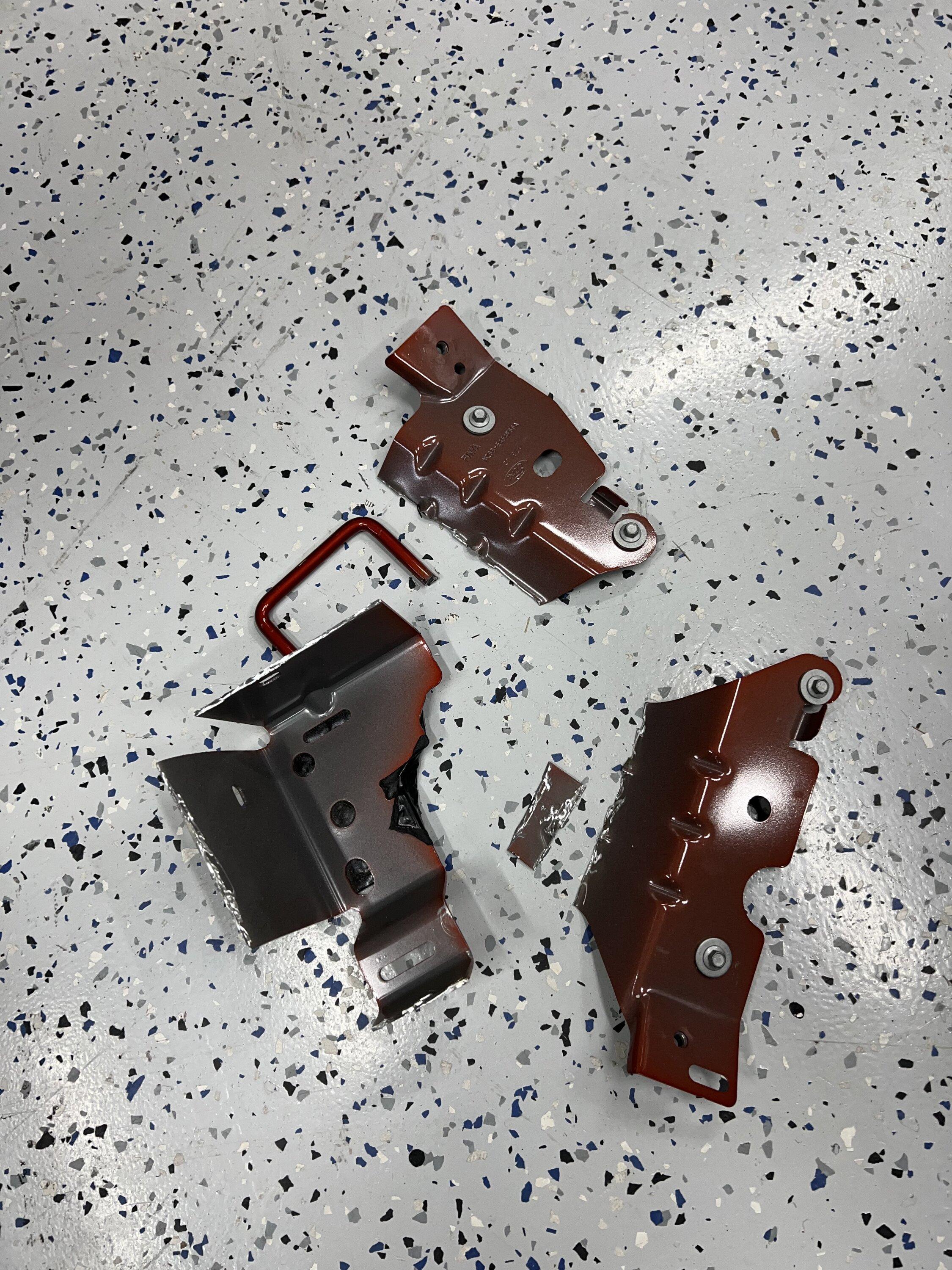

Removed excess brackets to make room

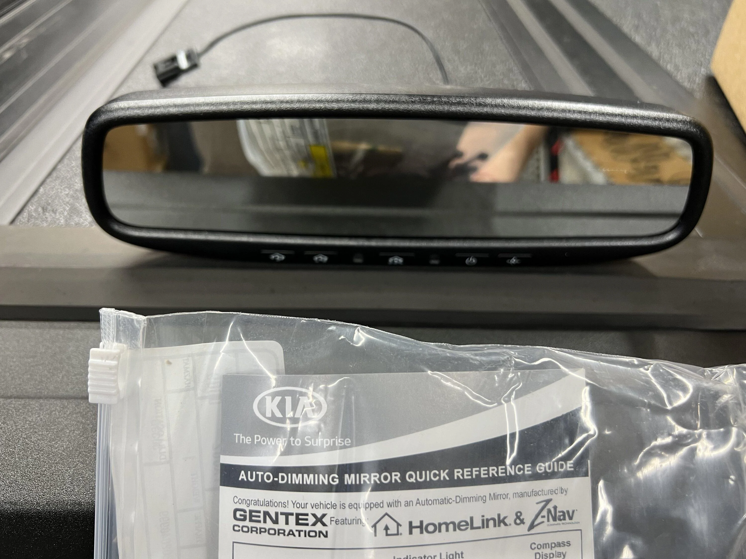

And my Kia homelink mirror came in ($22 shipped) so add that to the list of things to do

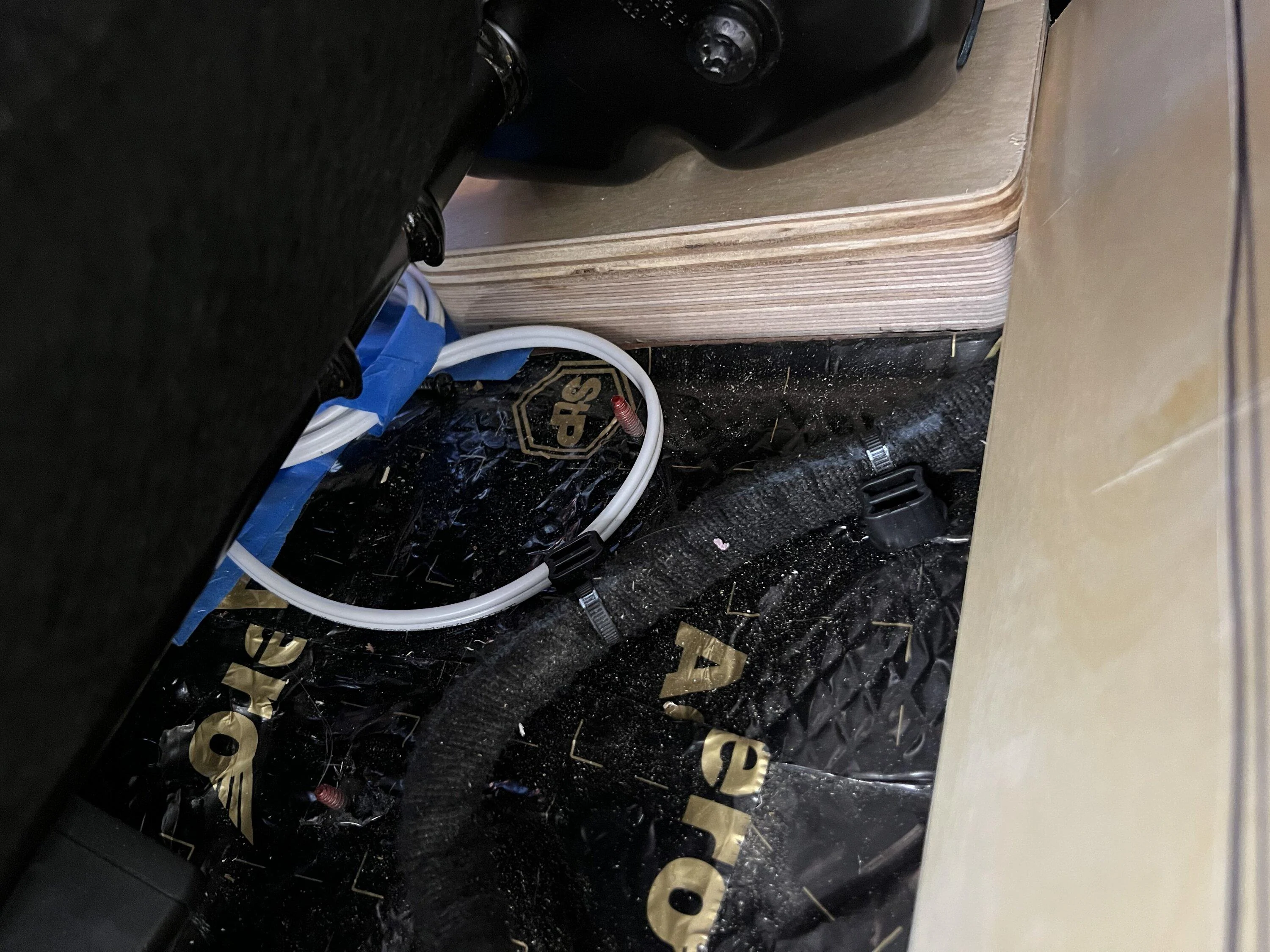

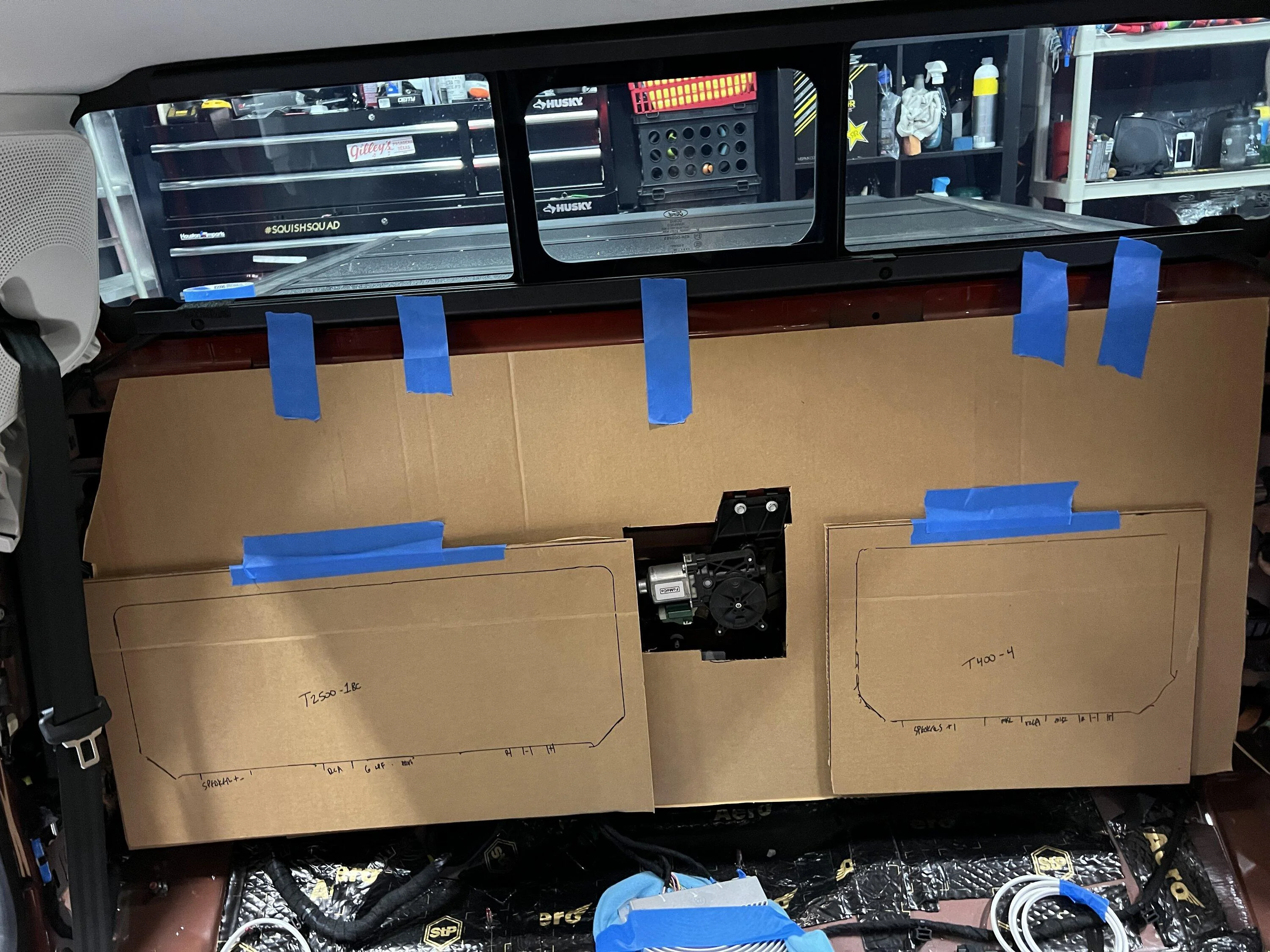

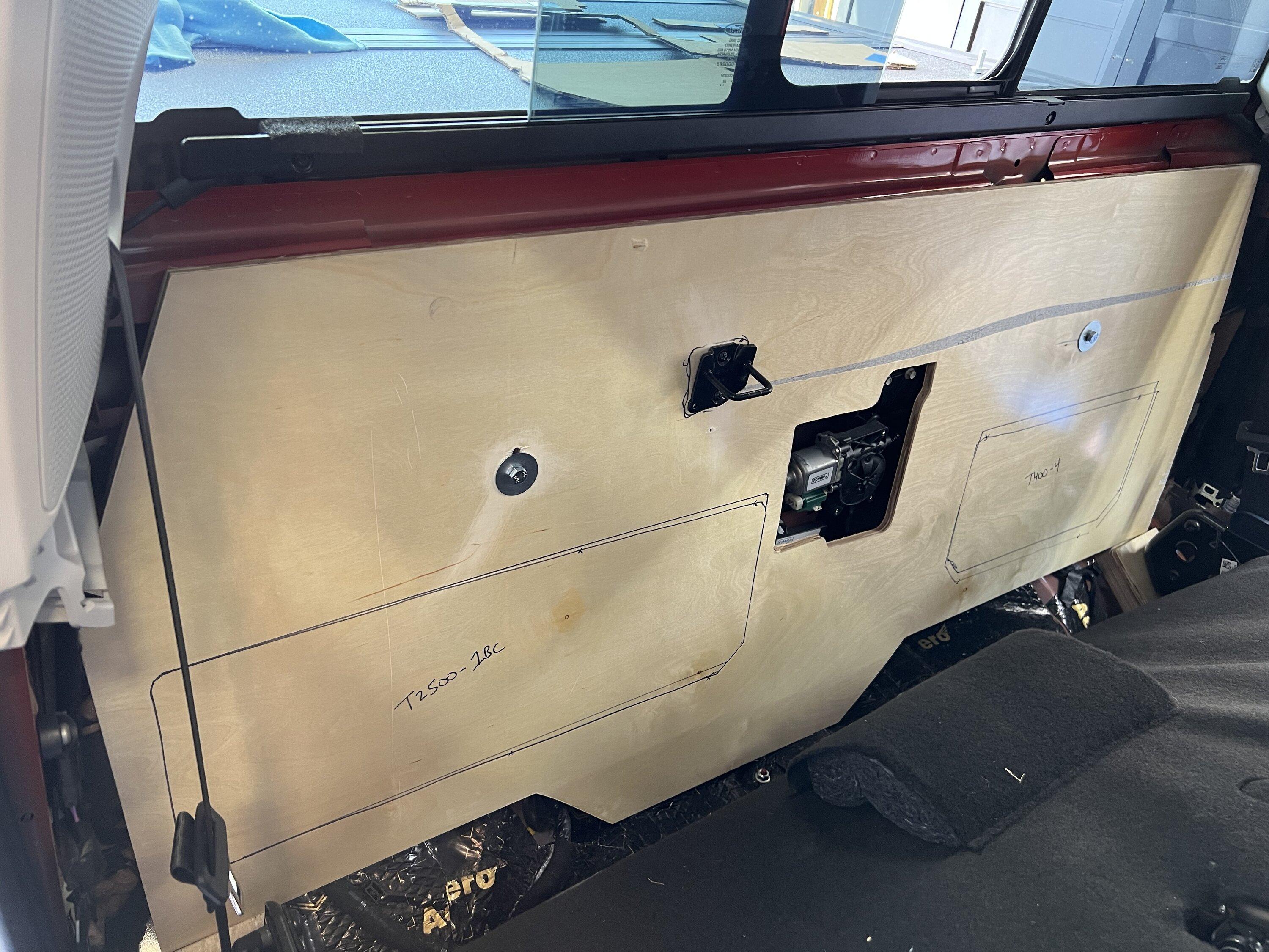

So confirmed I’ll be using two car seat anchors and at least one of the jack tie down bolts to secure the amp rack panel
Also mounted to this panel will be the rear seat upper mount latch thing (since we’ve spaced the seat out it won’t reach the factory location)
Getting closer
Wednesday we should be cutting the last of the wood…. Then all I have to do is some finishing work and put everything back in (well I guess some things will be going in for the first time)
Ford Maverick volksnuts’ Lariat Maverick build 90861DE5-6852-47C9-B23A-CC0D9280359C
This my first time really using CAD to build things out (cardboard aided drafting)

Cardboard is your friend! I love using it instead of guessing on real wood, especially now with wood prices still absurdly high.
MavDave
Apr 10, 2022
442
562
Houston
2022 XLT
C.A.D. can be Cardboard Aided Design. It definitely helps saving time and more importantly $$

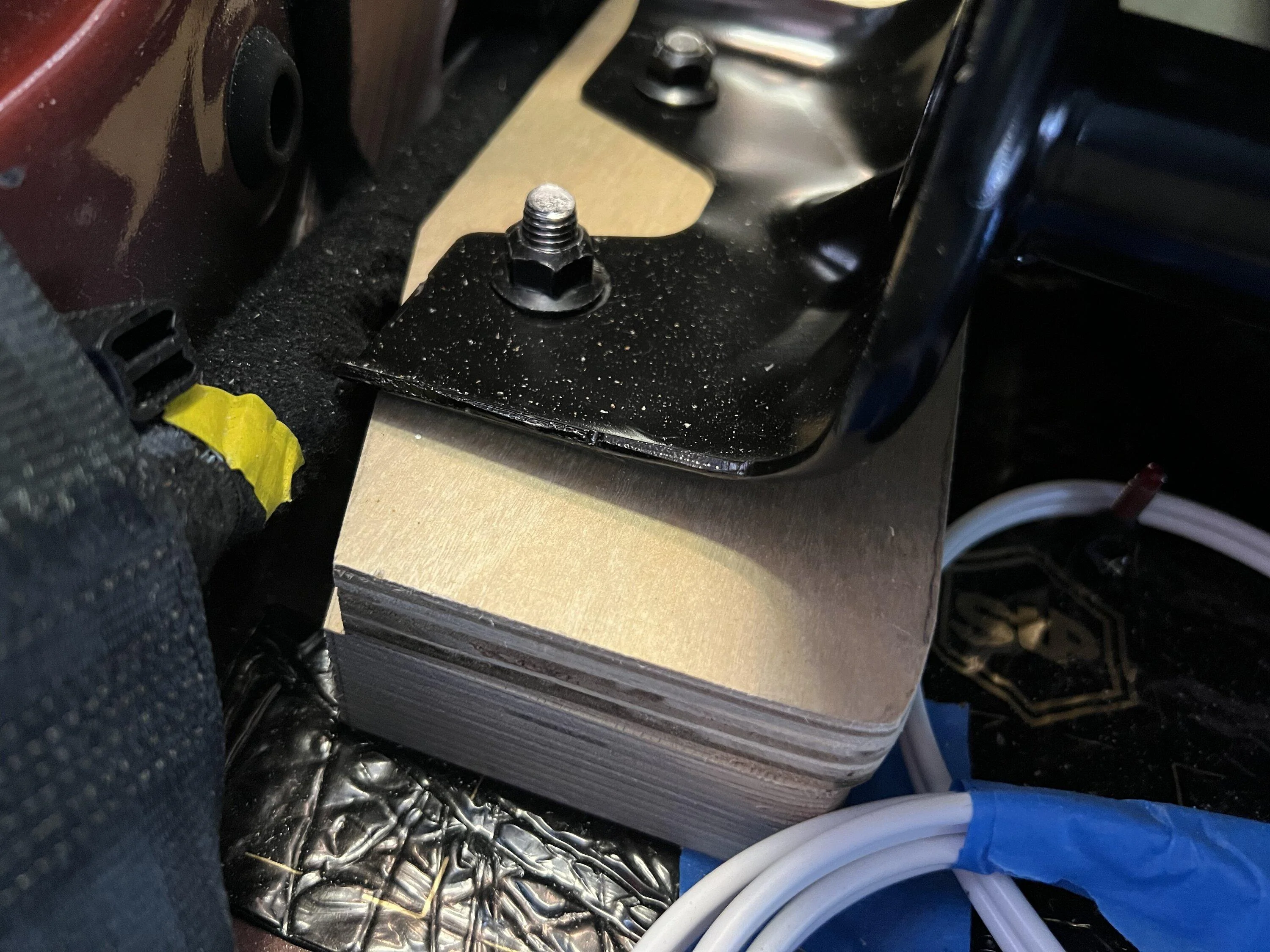

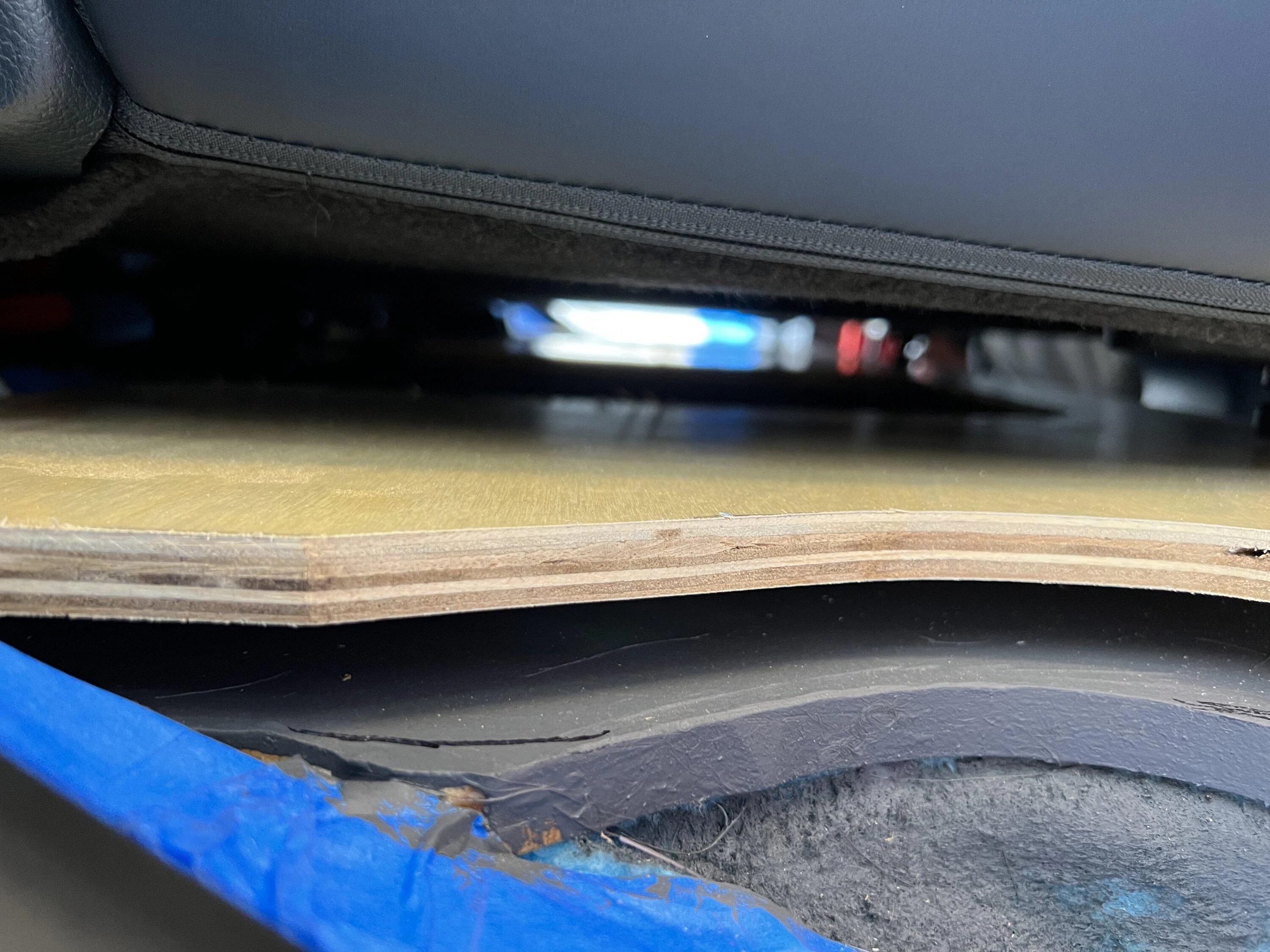

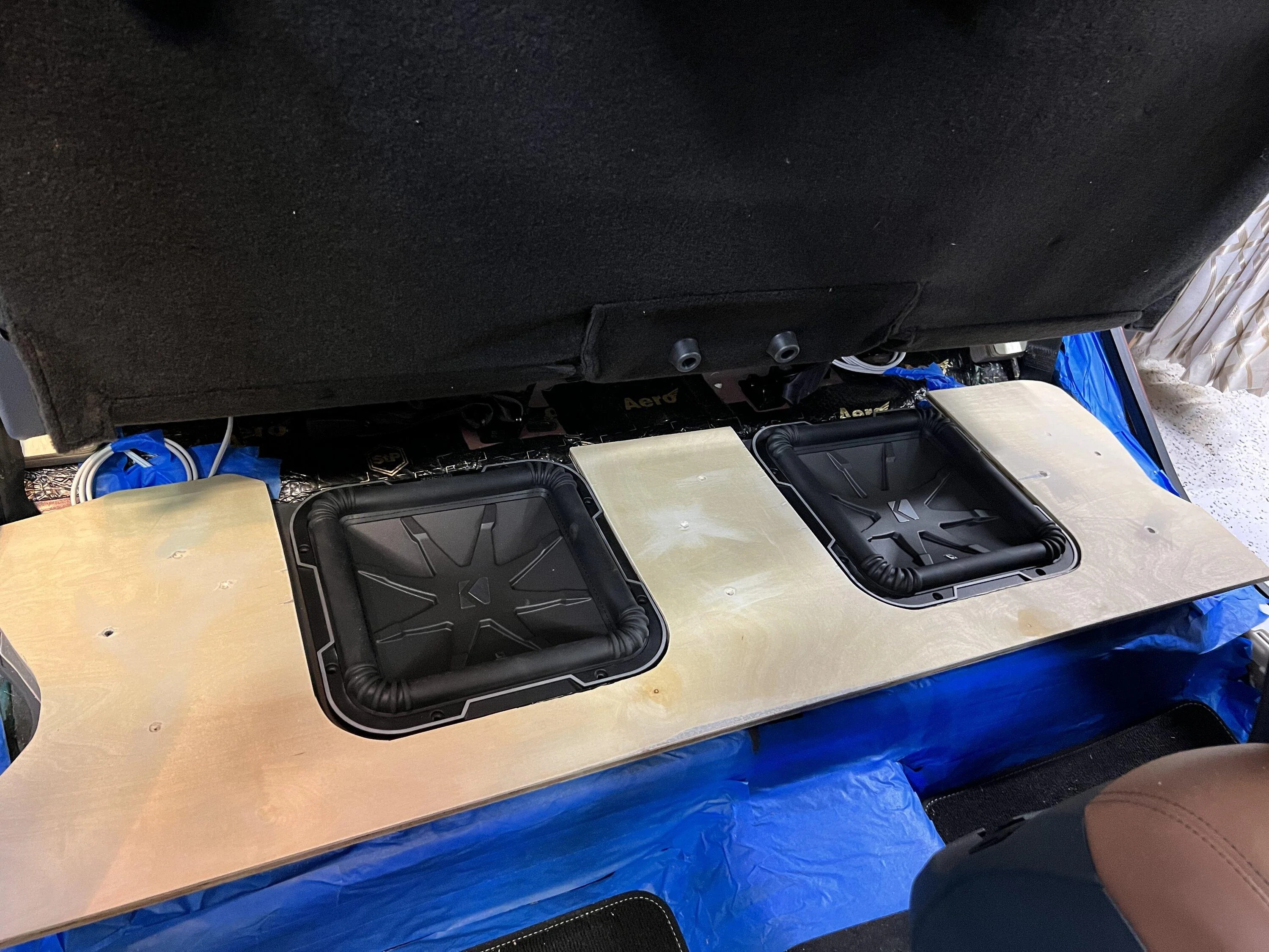

Ok I think I’m now at the point where I can go ahead and start doing final finishes and run wires
Fitted the rear panel and attached the seat striker…. Mocked up the amps and made sure there was space (still tight!)
Added the finish panel to the baffle
It’s glued and screwed and will be getting black carpet laid over it
Seat spacers v.2 work great
Just need to paint them black or something
Gives extra room under and behind the seat
Probably cuts down on space back there but no one but teenaged girls ever ride back there (which is very rare)
Next step is running wires to the front and installing front speakers…. Will be adding sound damping to the doors at that time
Totally forgot about my new mirror I wanted to hook up
Got distracted because we had to fix something on the Jeep
Looking good! Do you have any brackets that hold the bottom of the amp rack? I was thinking about using one of the jack bolts for mine.
volksnuts
volksnuts
Brian
Nov 12, 2021
1,772
2,925
Katy,TX
Maverick Lariat HPR
The bottom is touching but I plan to have basically a wedge piece to keep it from moving forward (using the two forward jack mount bolts)
But as far as up and down it’s not going anywhere
Just to clarify the rack is sitting between the forward and rearward jack mount bolts
