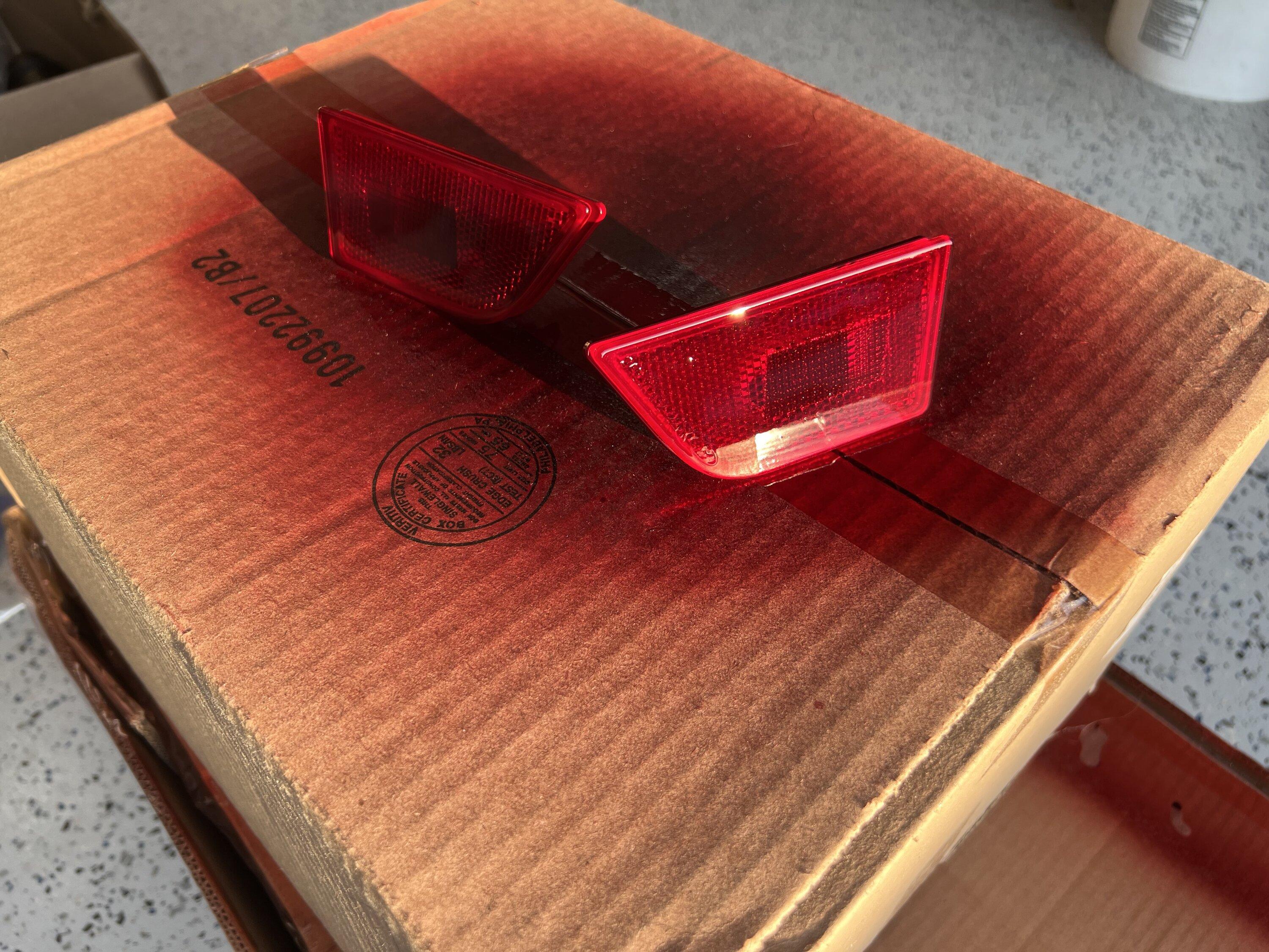

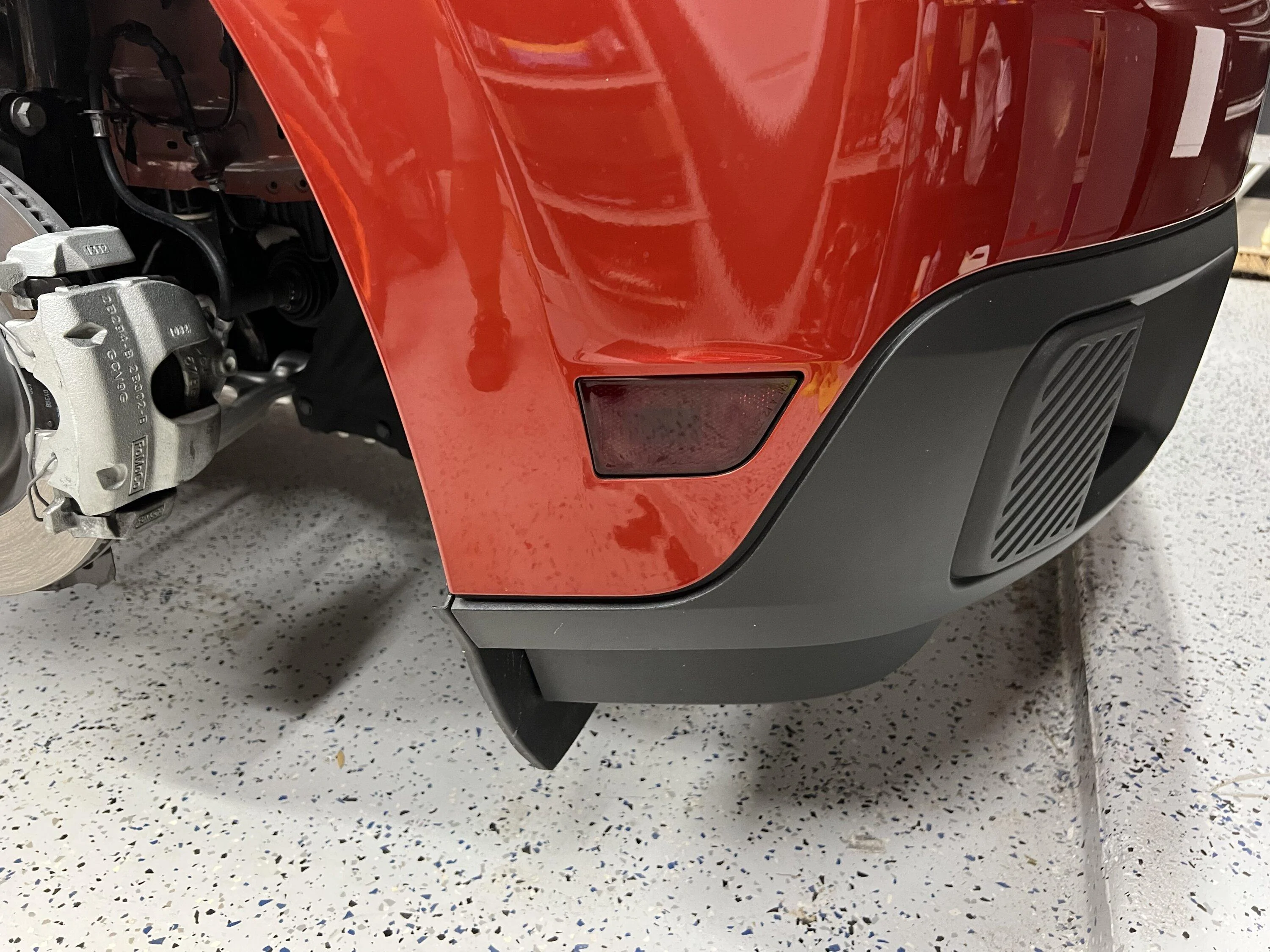

Went too dark on the front side marker lights, did 4 coats when I should have just done two coats
Was shooting for an orange red tint but ended up with dark red
At some point I’ll get another set and try again but the driver side one was such a pain idk I want to mess with it
They looked much lighter in the light

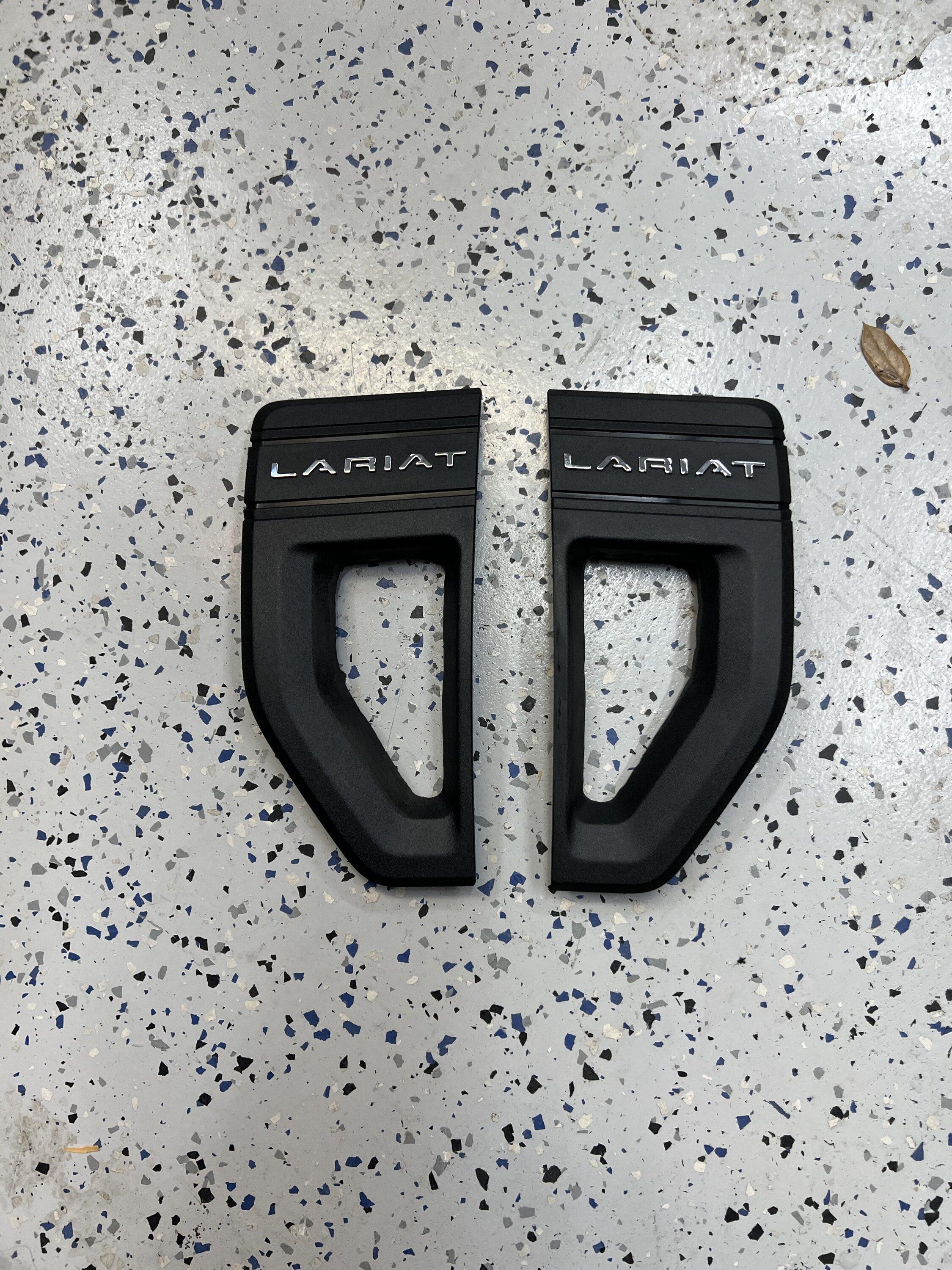

Going to have a local legend lowrider painter work some magic on these….
Still hoping I can convince someone to make these in carbon
Also have another set I’m going to make into full functional vents (won’t say Lariat anymore either)

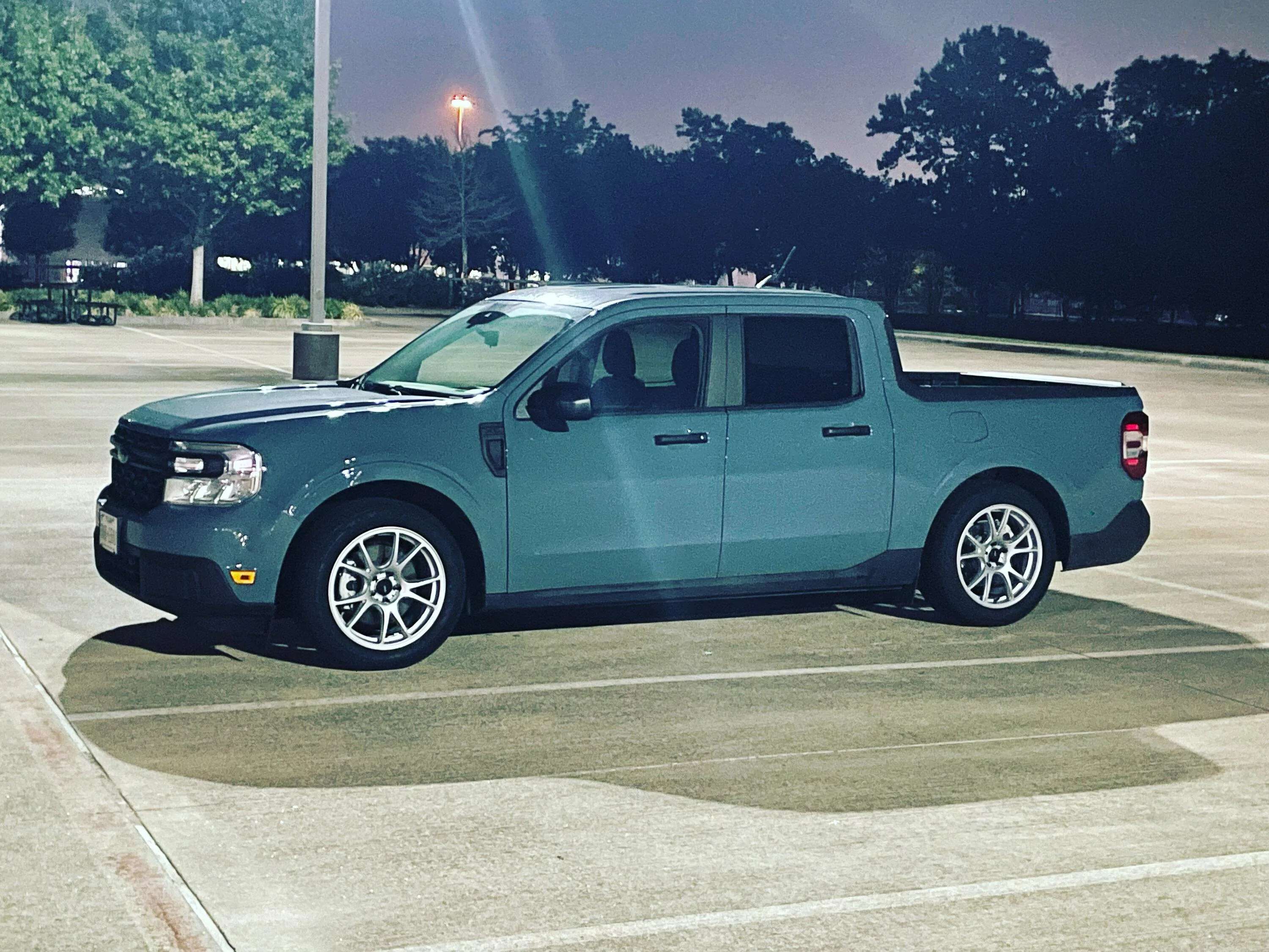

Lowest setting in the front, up about 1.5” in the rear
Have not looked at CV joint angle

I asked about the CV angle because I saw a few people reporting issues with the 2.5" front lift. Obviously we're going the other direction, but was wondering if they ended up flat or inverted some. Ideally, you don't want to run them horizontal.
Deleted member 6544
Guest
Here is the reply I received from Scale when asked if any other suspension adjustments would be needed. Granted I ordered the regular version. That will still lower the truck 4" in the front and level it in the back.
Reply...
No additional modification are needed to the suspension when installing this coilover . CV Joints handle the angle change well and the suspension configuration don't give too much natural negative camber when lowering so it's pretty easy to align wheels to prevent excessive tire wear. The suspension already come with camber adjustable front top mount and also have camber adjustment on the shock to knuckle bolt. Rear only have factory alignment adjustment but it can be set to avoid tire wear. Factory swaybar endlinks are strong enough so just adding the coilover upgrade works great with other factory components.
