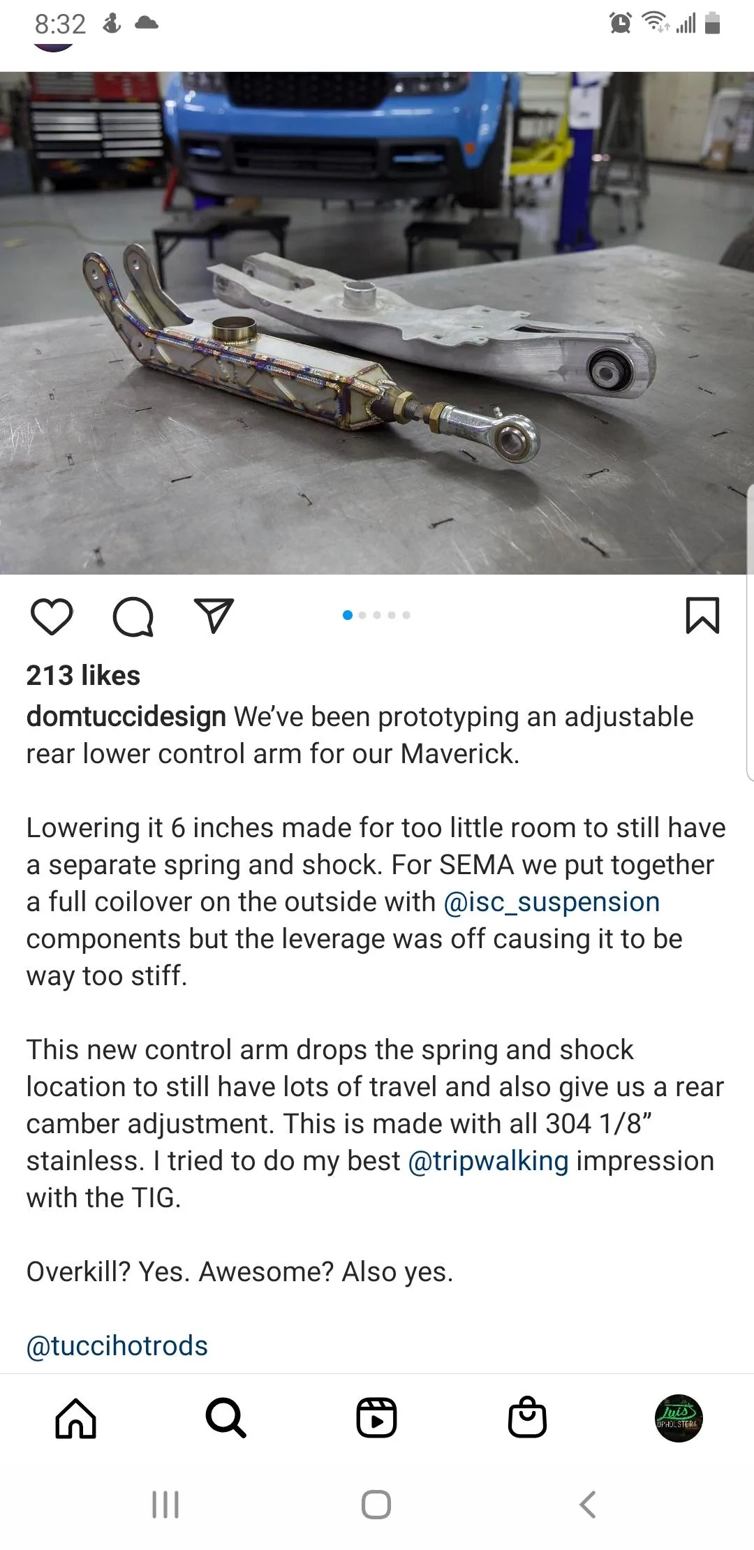

The front really isn’t the issue other than having to adjust the camber plate before you install the assembly since you can’t access it from the top
The answer they gave me on the rear is to adjust the toe to lessen the tire wear…. Basically just get it close enough
The shop I’m working with is building some custom pieces to
The rear end seems to have less adjustability than most would like to see
I don’t recall what issue @catinthebathtub was having in the rear but it’s is something they are working on as well
