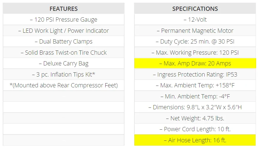

Once my Mav comes in i will be able to donate my crappy Harbor Freight compressor to goodwill and pick up the Viair 88p. This looks to be perfect to semi permanently hook up to one of the 12v leads in the bed. It maxes out at 20 amps. With a 16 foot hose should be able to easily reach any tire on the vehicle.
http://www.viaircorp.com/portables/88p
Looks good. Does it come with a power cord to plug into the bed leads?

I've had a Viair 88P since, well, I don't remember. 5 years? It still runs like a champ. Out of all the portable models at the time, it had the longest duty cycle, which was important to me since I used it to air up my F-250's 35" tires from 15PSI to 80 PSI.
I needed the 10' extension hose to reach the driver side rear tire on my F-250, but the included 16' hose is enough for my Nissan Frontier crew cab short bed. Should have no problem with the Maverick. In fact, you might have enough hose to set the compressor on the radiator shroud so it's not on the ground/in the dirt.
