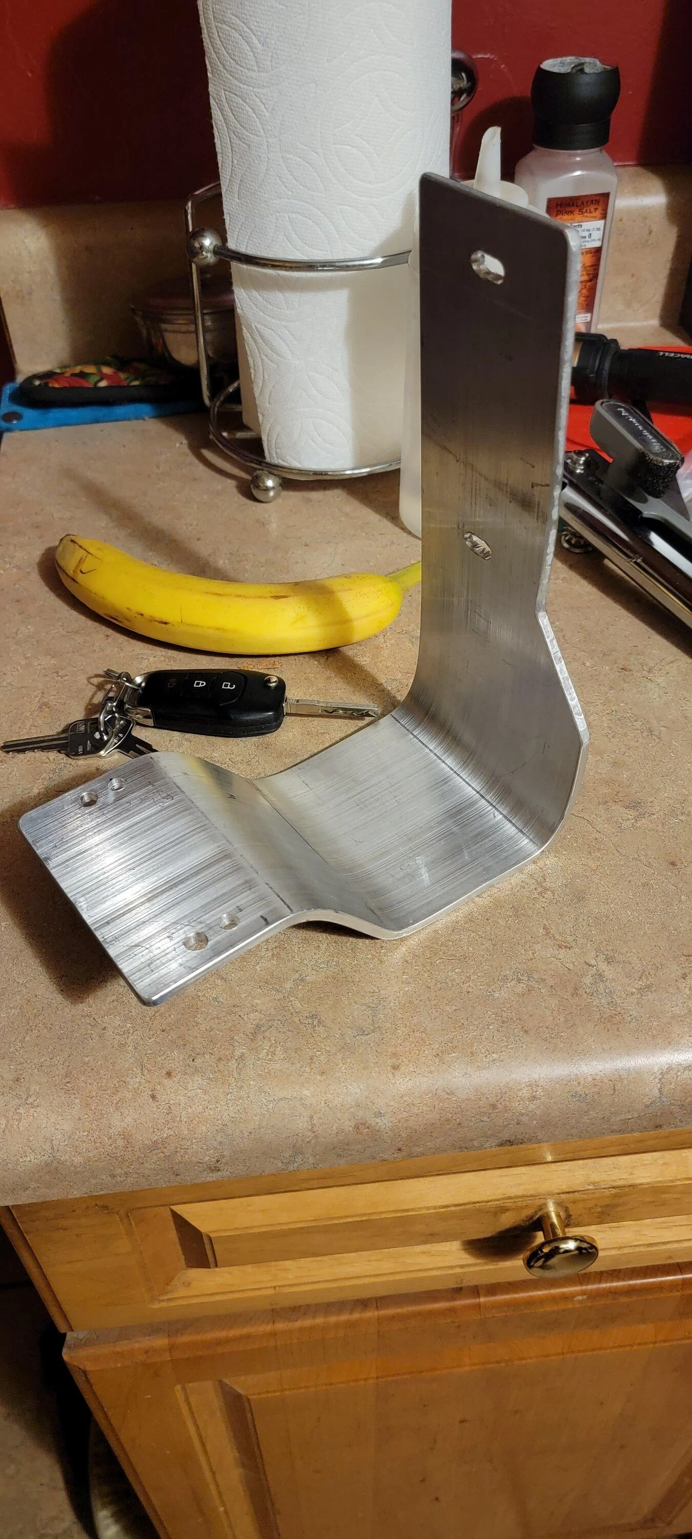

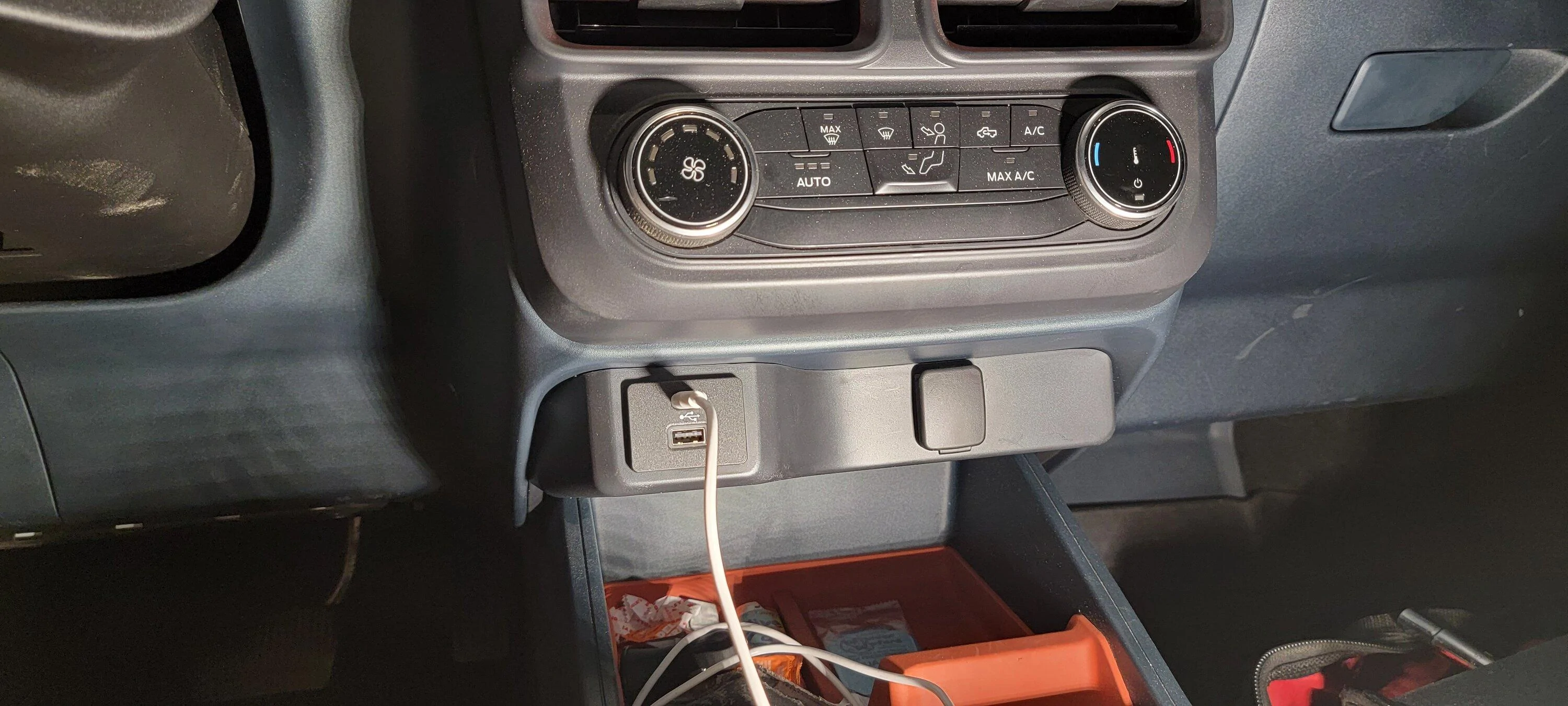

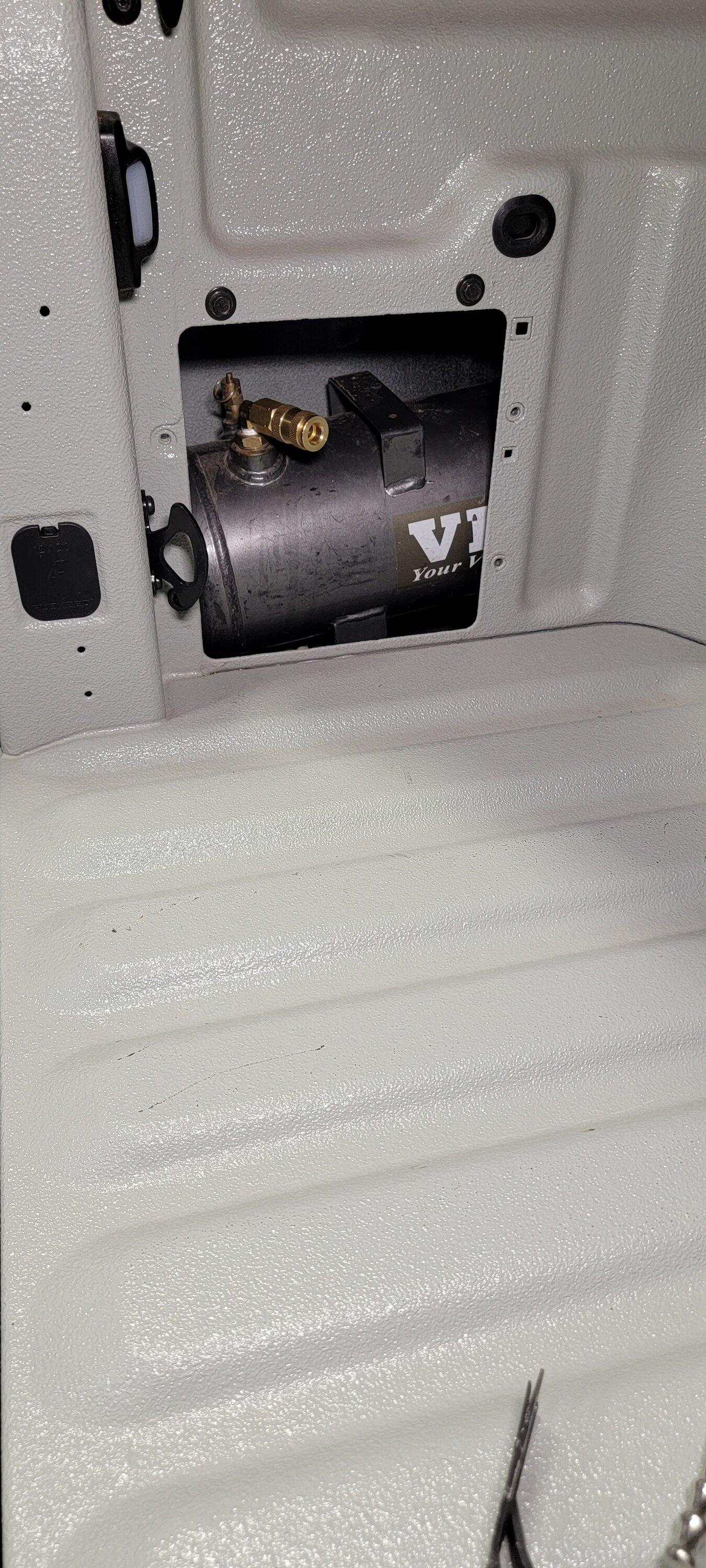

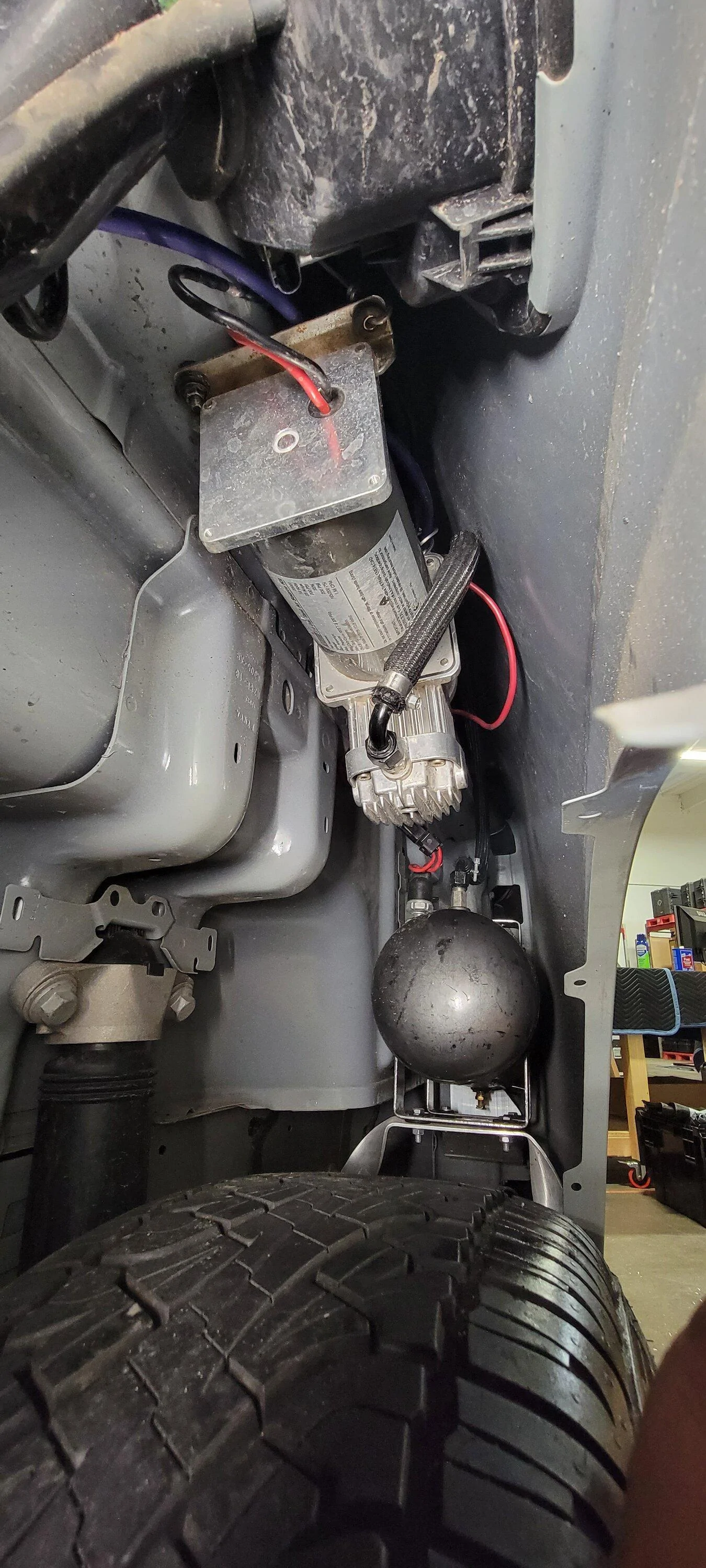

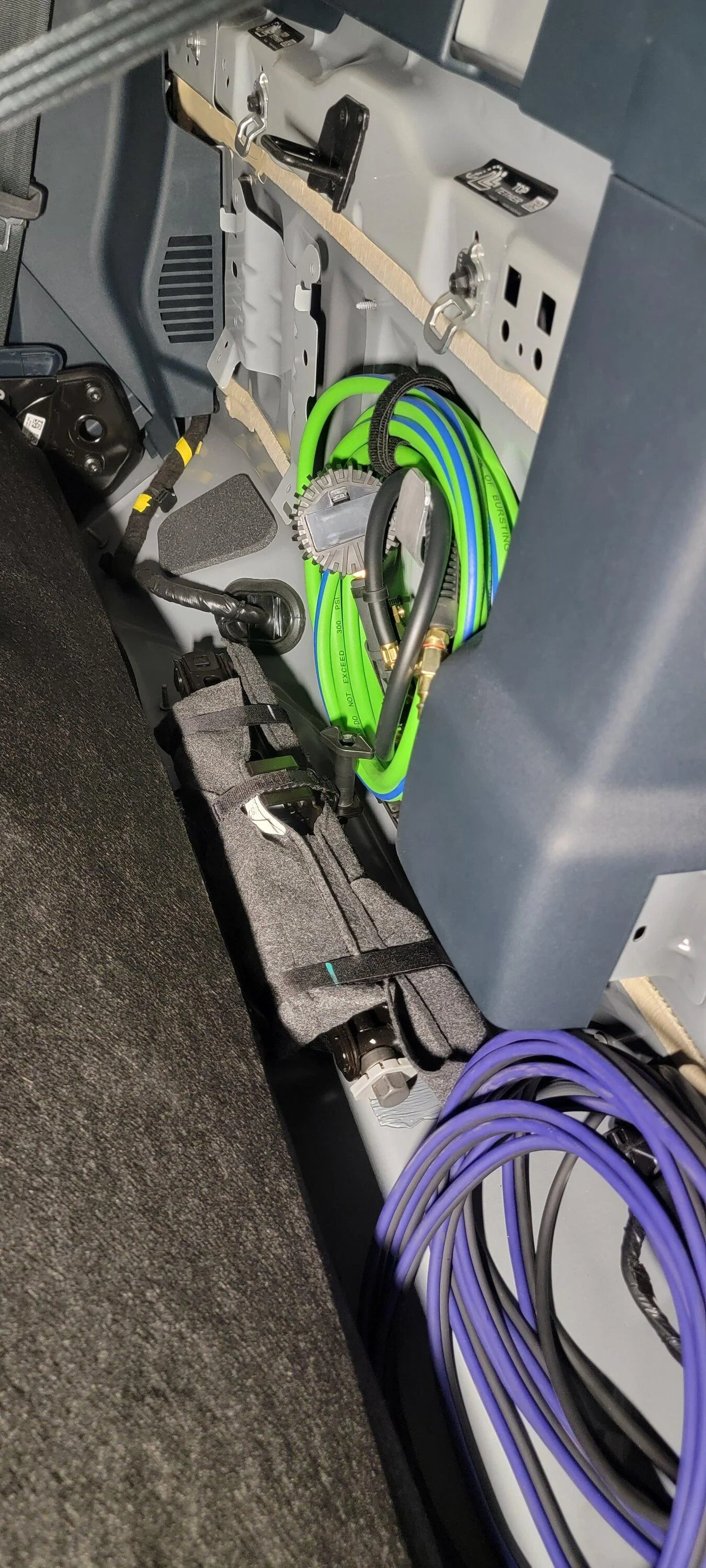

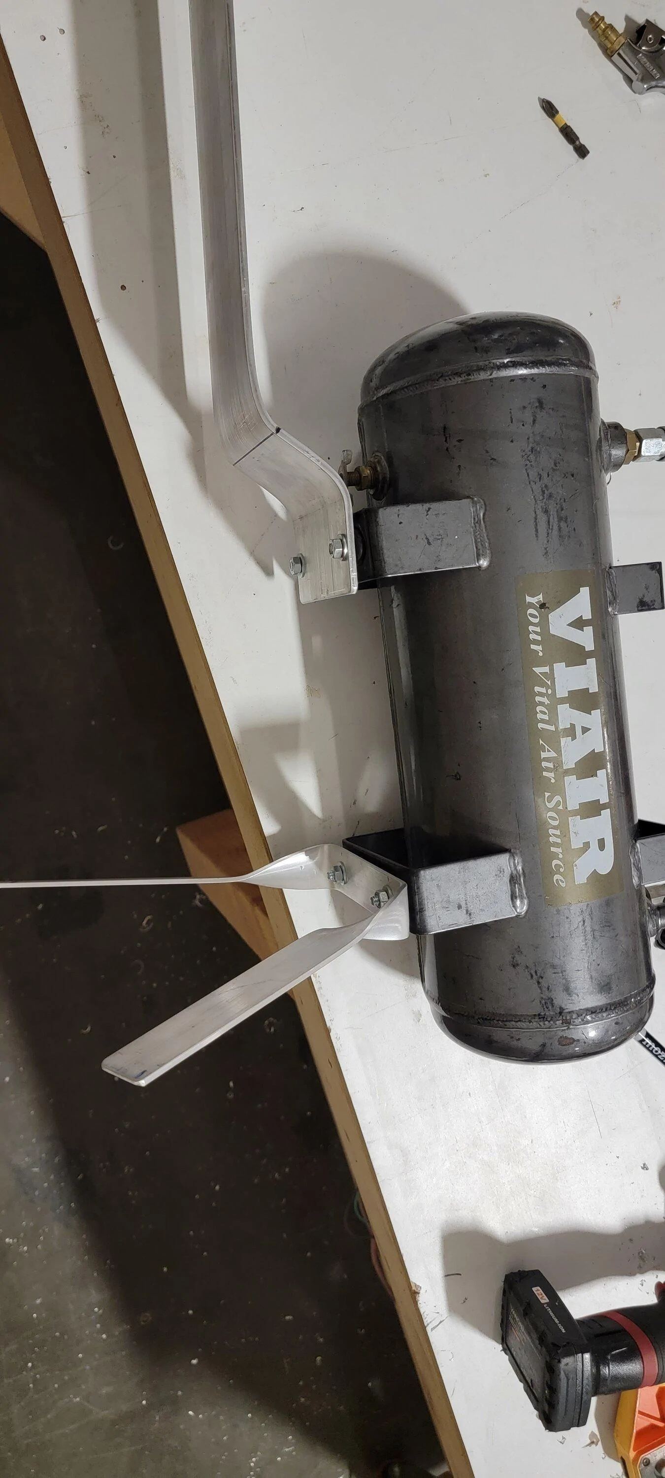

I've done a bit of work to my Maverick and still have quite a bit more to go but for now I'm just trying to finish adding the compressor but need some help figuring out how to remove the black panel with the 12v socket above the phone storage area which I'm hoping there is a way to remove just that panel but am kinda doubting it. so if anyone has some advice or photos that would be amazing.

If you mean the panel with usb and 12v, just pull straight out, tug harder than you think you should. I would wire compressor into battery with a fuse in-line. Good luck with your mods.

I knew there was a lot of space in the bed sides and it was just a matter of time before someone put something in there.
Looks like you went in from the bottom with taking the fender liners out.
What did you attach the pump and tank top?
More information on the install would be great.
I am guessing this is on the driver's side?
