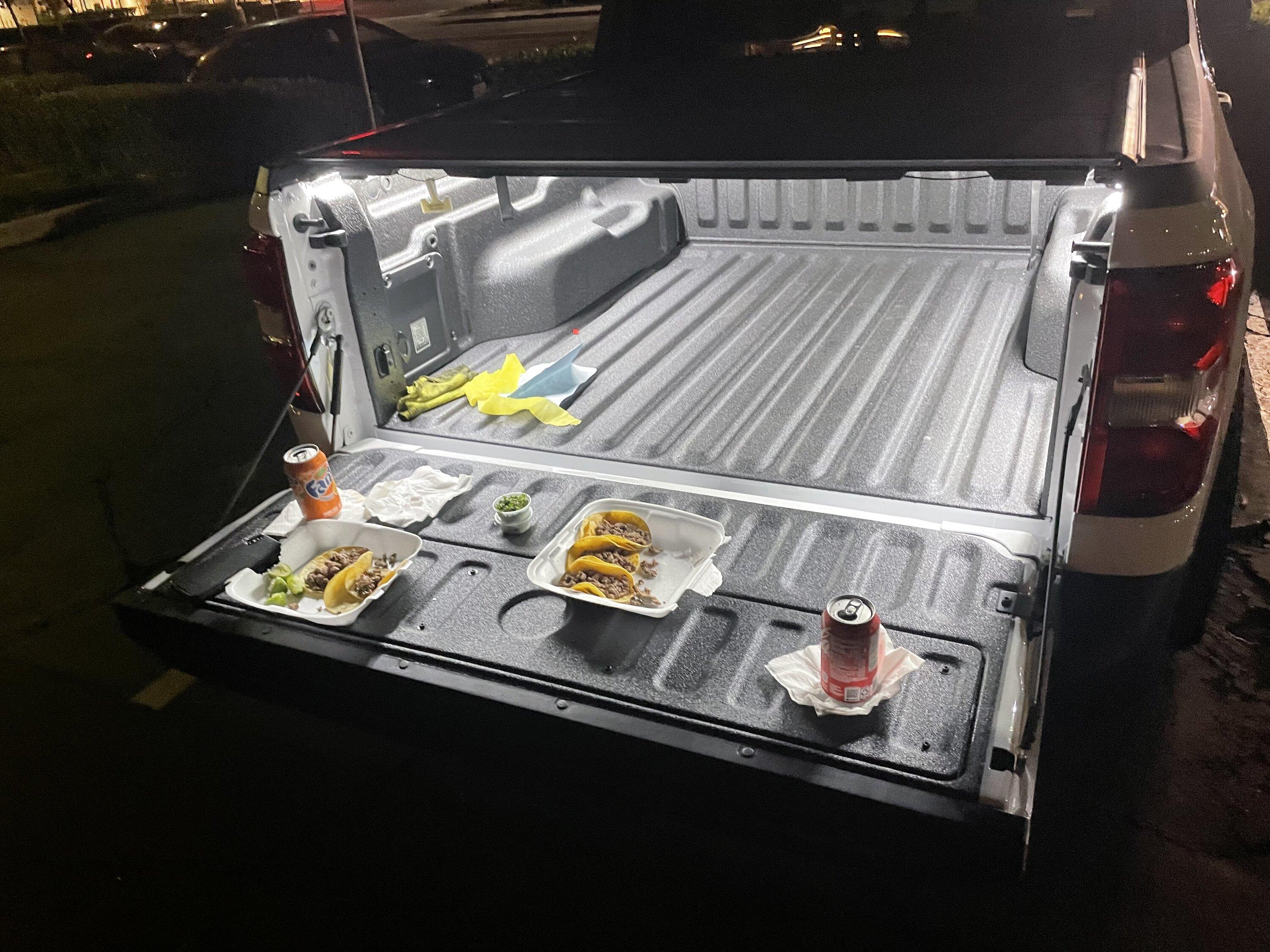

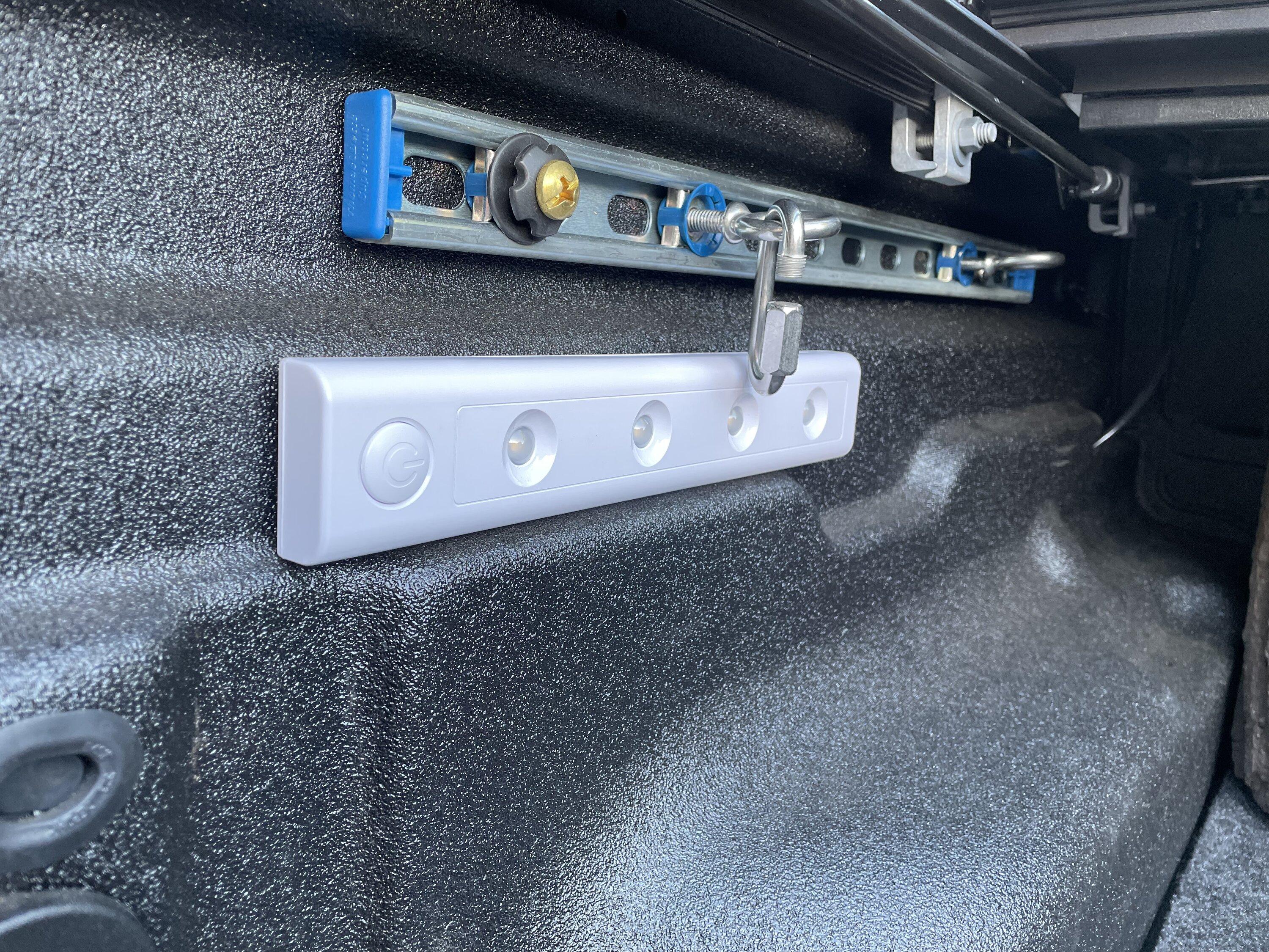

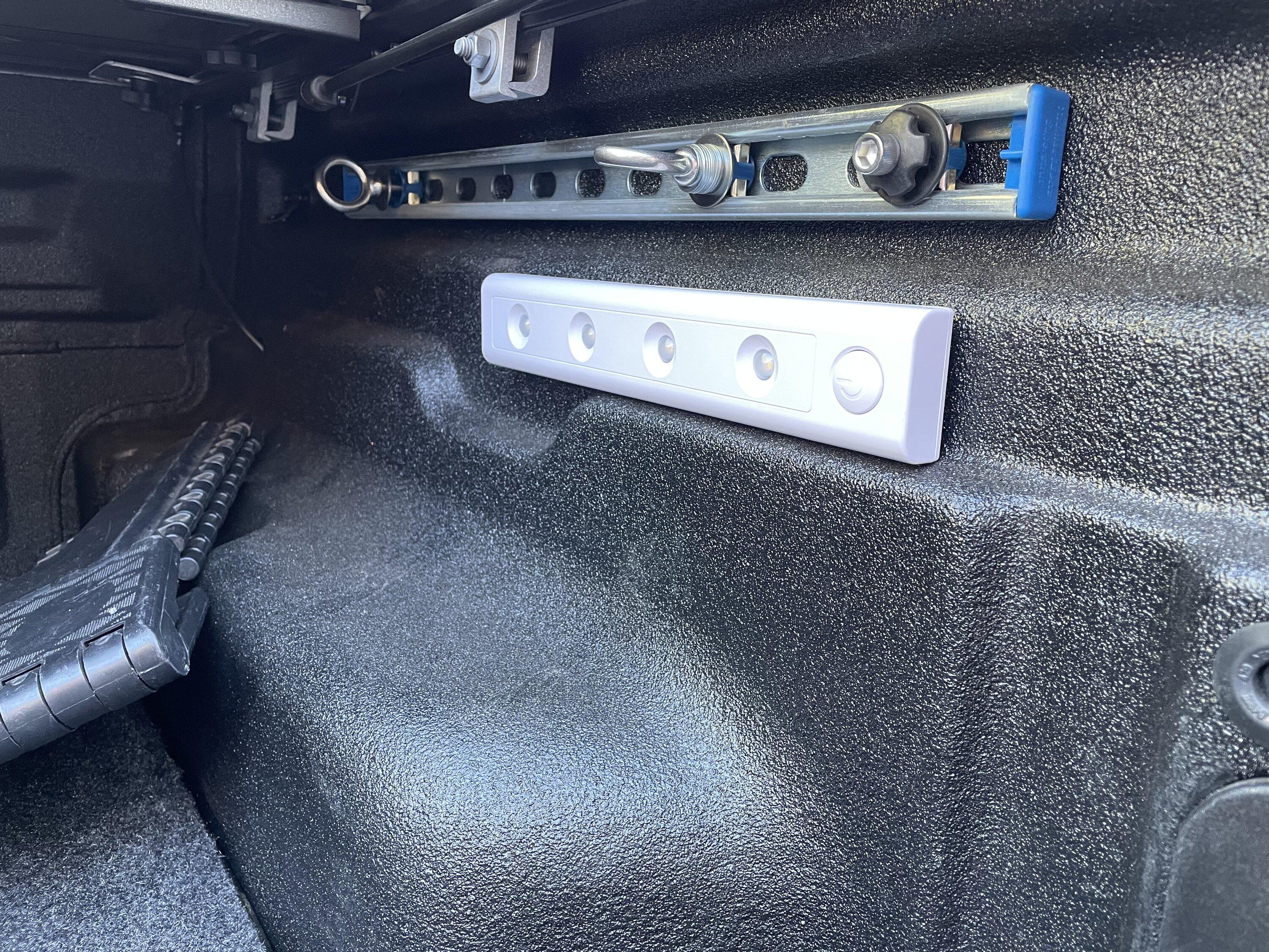

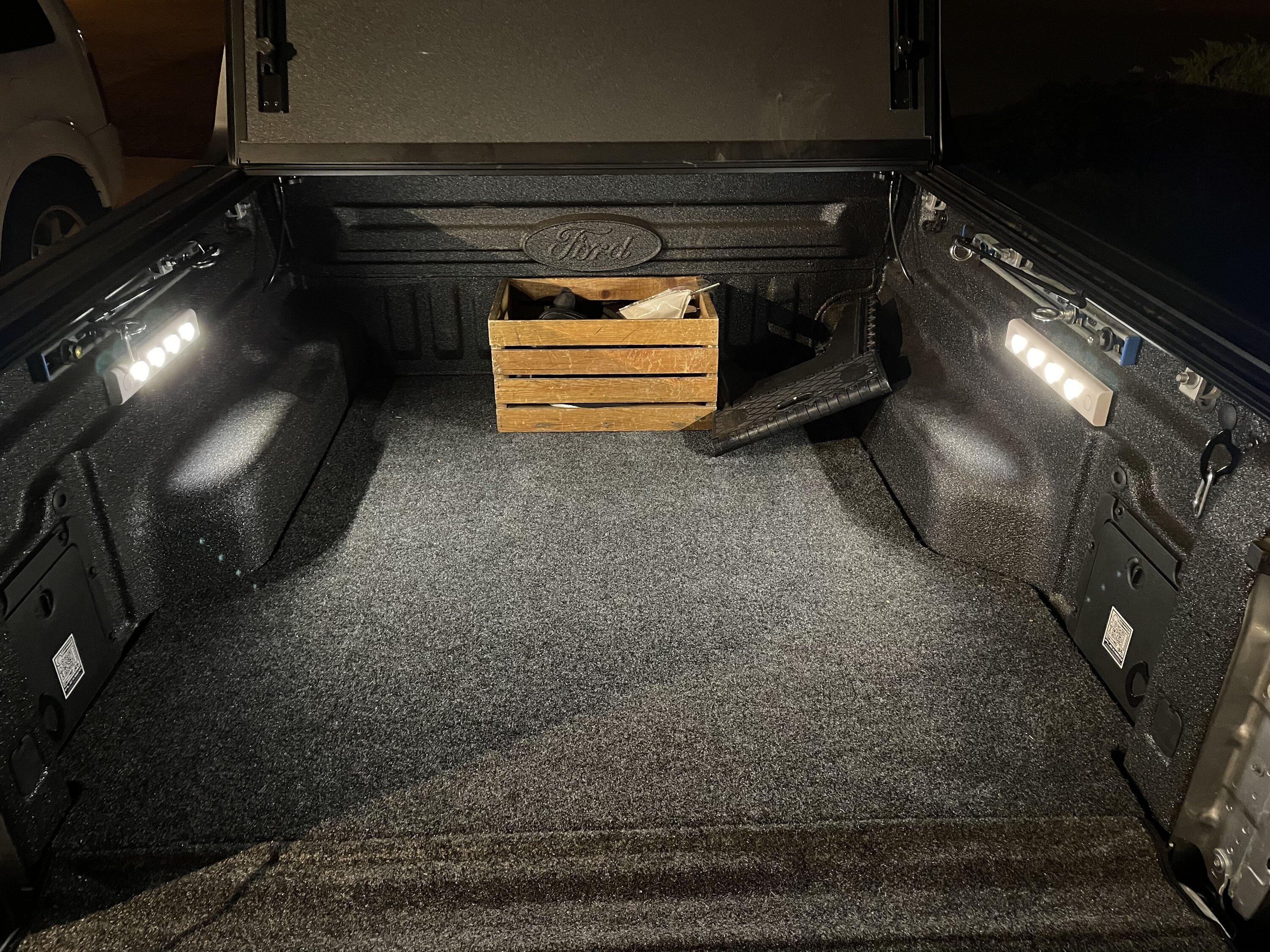

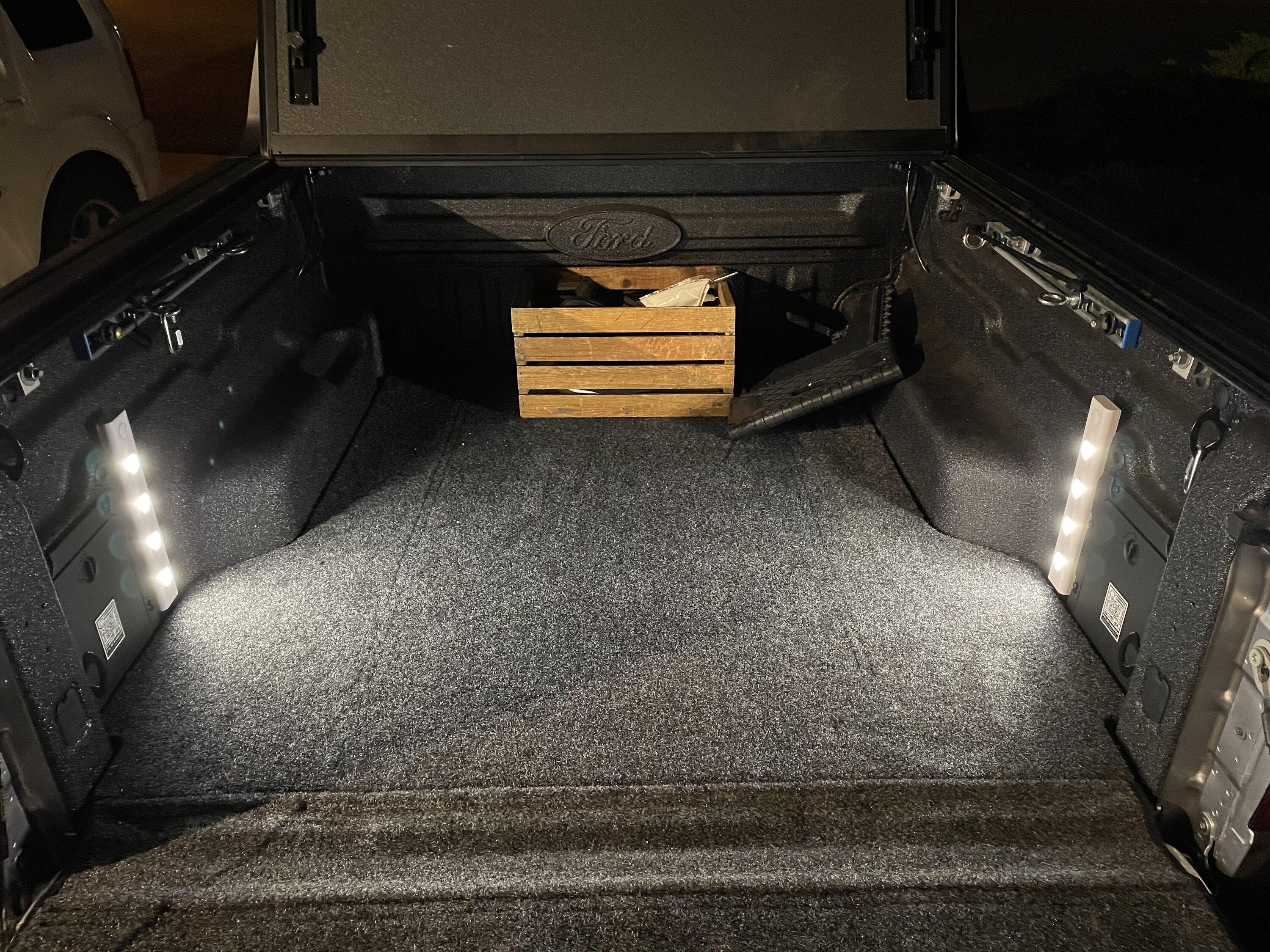

I picked up this idea on Reddit from a post by titanup0812:
I liked the poster’s idea for a simpler and much less expensive solution for bed lighting using GE Under Cabinet LED light strips.
https://www.amazon.com/gp/aw/d/B08RN3VLFG/ref=ya_aw_od_pi?ie=UTF8&psc=1

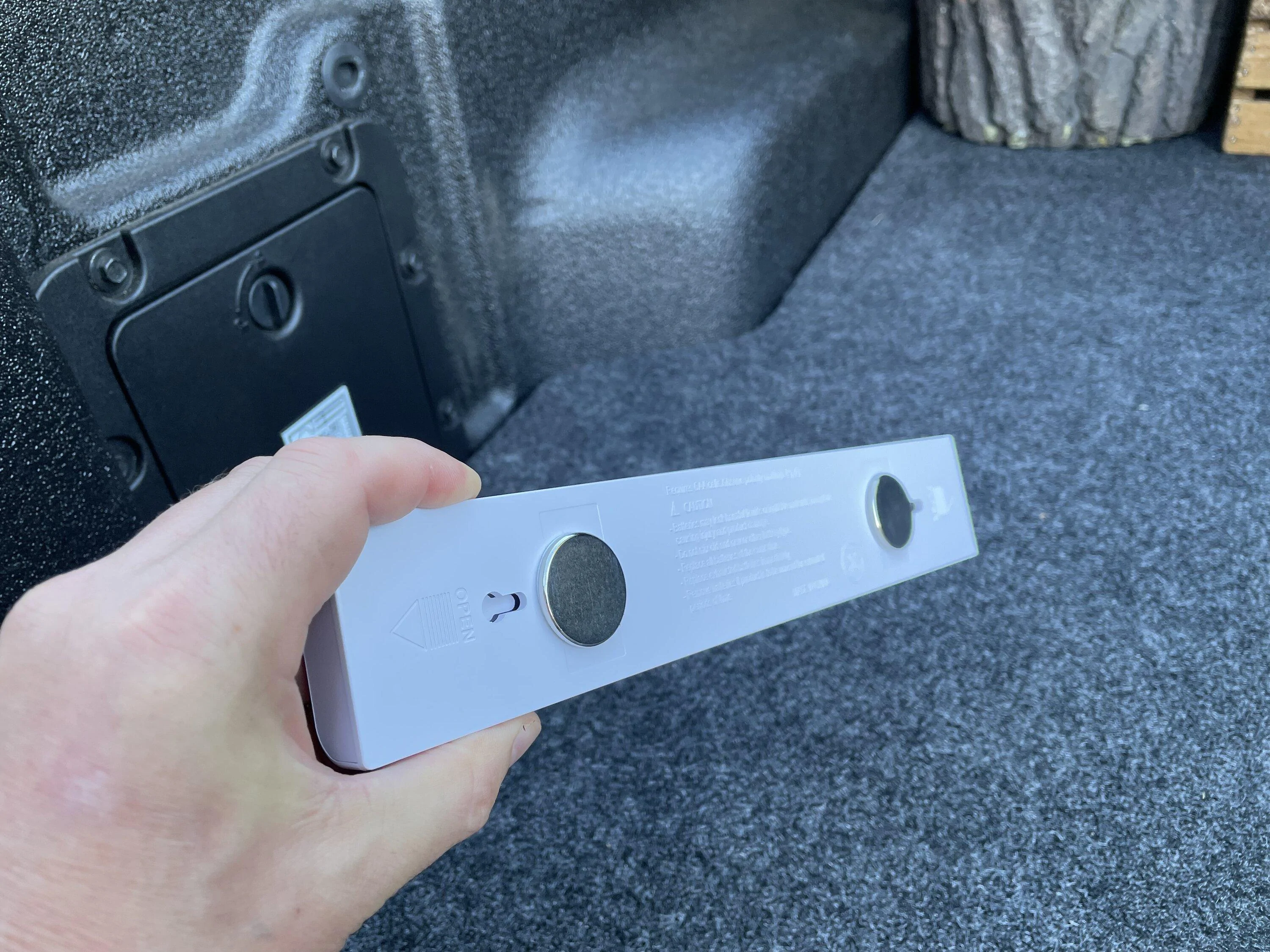

I wanted to make the lights repositionable so instead of using the included 3M adhesive pads to adhere the lights themselves to the truck bed I used the adhesive pads to adhere two neodymium disk magnets to the back of each light bar.
https://www.amazon.com/gp/aw/d/B089CVX89D?psc=1&ref=ppx_pop_mob_b_asin_title
The light bars hold very well but can slide around a little bit on the slick spray in bed liner surface. I may add a third magnet to each light bar if they do end up moving around too much or falling off while driving.
A big drawback is the lights are not waterproof and I am wondering how exposure to the summer heat will effect them. Of course, they could be stored inside the truck and put in place when needed.
But, at around $8 per light strip and $1.75 per magnet (plus the cost of 12 AA batteries) it is an easy, effective and inexpensive solution for illuminating the bed area.

Great Idea. And you can always store them inside the cab or in the bed cubby so the weather doesn't get them.
