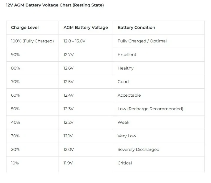

@Cherokee
Not at all useless observation.
12.8 on your AGM is very good, in the optimal range and especially compared with the 12.4 volts you were getting previously.
For those interested, I found this chart handy..

@Cherokee
I like that Chart !
Knowledge is Power, :’P
Thank you Mr. Dragon.

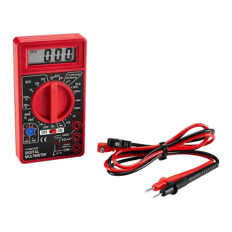

Did you test with a meter? I’ve found interesting behavior with modern vehicles in that regard. Voltage at the posts is,,,,,,,
Yes sir !
With my very high quality
$7.99 digital VOM
From Harbor Freight.
On the battery posts.
:’P
FWIW the same meter is at Wally World for
$12.95 but it comes in black. I have both.
They are exactly the same and test out exactly the same.
