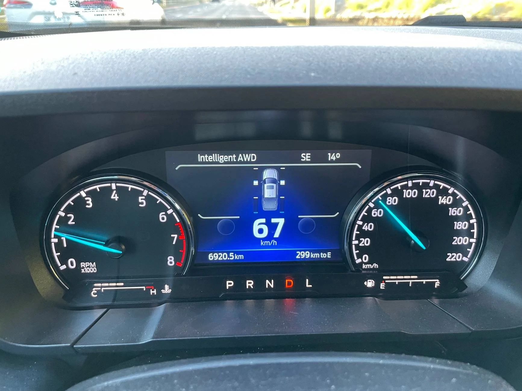

The instrument cluster has a screen that shows how power is applied to the front and rear drive.
Both front and rear receive power when you accelerate from a stop, then goes to mostly front. Enable that screen and you'll get a visual answer to your question.
I have a 23 AWD XLT ecoboost. I have not seen that screen. Am I missing something?
Yes. If you're not able to flip to the screen from the steering wheel controls, it is probably disabled. You can enable it in settings.

It’s one of the screens you can select to be shown along with the mpg and tire pressure screens.
You are truly in fwd running down the highway. The intelligent awd system has clutches at both ends of the driveshaft and disconnects when not needed so the shaft isn’t turning like in an old 4WD system.
I have owned mine for a year and just found the screen a few weeks ago. It's there under one of the instrumentation categories.
Edit: At least on the XL, play with the screen and go to settings and then information and under there will be the auto start/stop, the AWD, etc...,
