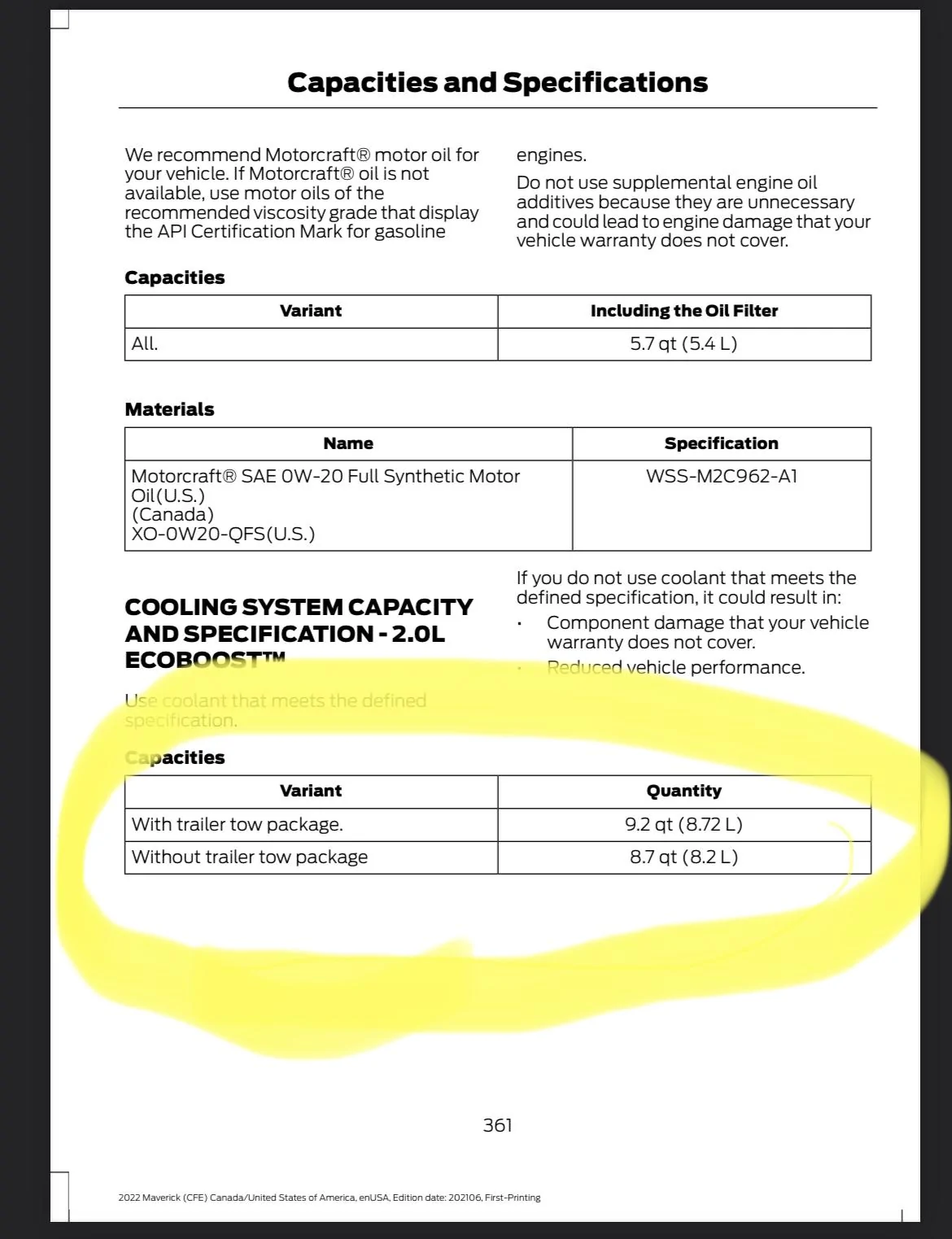

That's how I am going to order mine. I believe other than the lower final drive, the 4K tow package includes an oil cooler.
*transmission cooler
plus the higher capacity radiator and cooling fans.
Ford Maverick FWD vs AWD for acceleration? 55841C5C-87F7-4815-A8A6-686AB423E2FA
