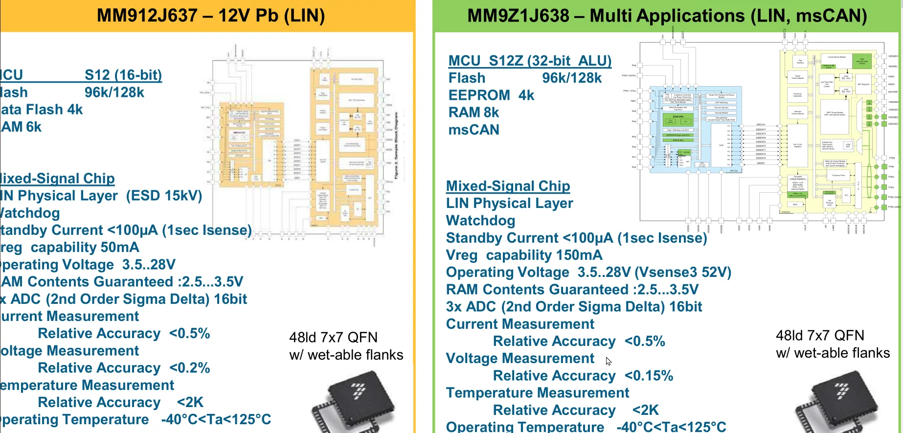

I'd guess the Ford shunt type BMS Sensor functions like Bosch & Continental sensors, except the Bosch EBS sounds better on paper than Ford BMS actual performance on their vehicles.
Bosch electronic battery sensor (EBS)
Continental Intelligent Battery Sensor (IBS).
Bosch Mobility EBS:
High measurement accuracy for Voltage, Current and Temperature.
Integrated battery state detection:
The algorithm delivers precise, reliable information on current and predicted battery state.
The electronic battery sensor (EBS) measures the current, voltage and temperature of 12V lead-acid batteries with great precision.
The battery state detection algorithm (BSD) integrated into the EBS calculates the current and predicted state of charge and function of the battery from these base parameters and indicates battery aging effects. This information is passed on to a higher-level control unit, e.g. the electrical energy management (EEM) system
The SOC indicates how much power is available. Using the SOC, the electrical energy management system (EEM) in the main control unit regulates ancillary load to optimize battery life and fuel consumption.
The SOF predicts the influence of the load profile on the voltage curve. Based on the SOH value, battery aging effects and their influence on the battery's capacity to store energy and its power output are calculated.
Continental IBS:
Provides the battery’s State-of-Charge (SOC), State-of-Health (SOH), State-of-Function (SOF).
Ford Maverick Updated BMS Available Why? 1754022425901-u0
NXP Intelligent Precision Battery Sensor MM9Z1_638 - Product Training
Ford Maverick Updated BMS Available Why? 1755206179021-yv
Bosch Mobility EBS:
Continental IBS:
Since accurate Voltage and SOC% should only be after the charging has stopped awhile and surface charge dissipated, I'm wondering if it's as simple as trusting those reading as given while the truck is being driven, and applying charging strategy based on them.
Or perhaps the chip in them has some compensation already applied. Or is supposed to but doesn't. Or is badly done compared to newer chips.
