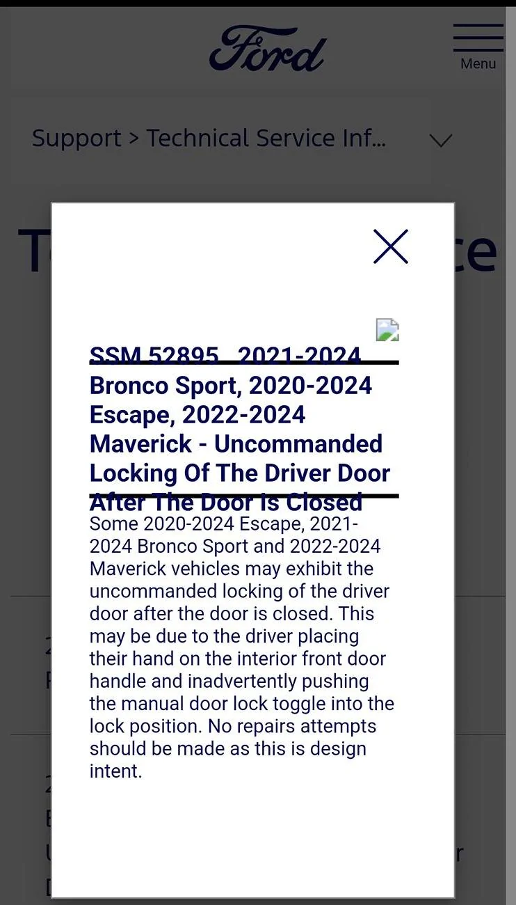

There is a Ford Service Bulletin issued regarding this issue but I don’t remember a number. It said exactly what is being discussed in this post, accidentally touching the lock button when exiting the truck.There is no repair or software offered.
I just noticed the bulletin when looking on Ford website after logging in to my vehicle “dashboard” yesterday and clicking on service bulletins.
Thank you for the lead.
Appears to be human error. As I demonstrated the possibility of in my video.
Here is the Ford service bulletin.
Ford Maverick UPDATE: Driver's door locks itself when I exit my running XLT hybrid Screenshot_2024-09-24-20-22-27-35_40deb401b9ffe8e1df2f1cc5ba480b12
To those folks, that insist it happens automatically.
To those folks I say. Please take a video of it. It can only bolster your claim.
