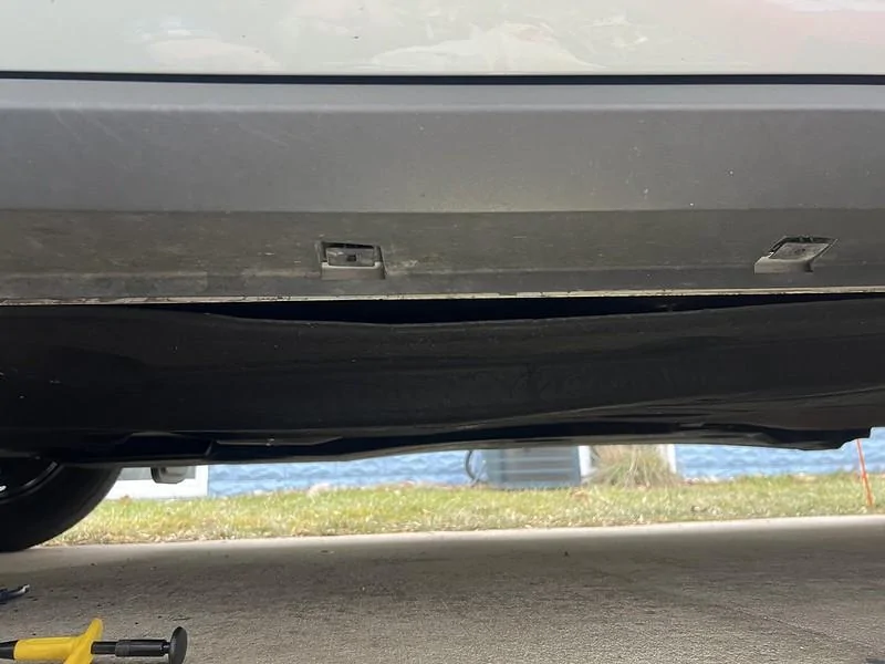

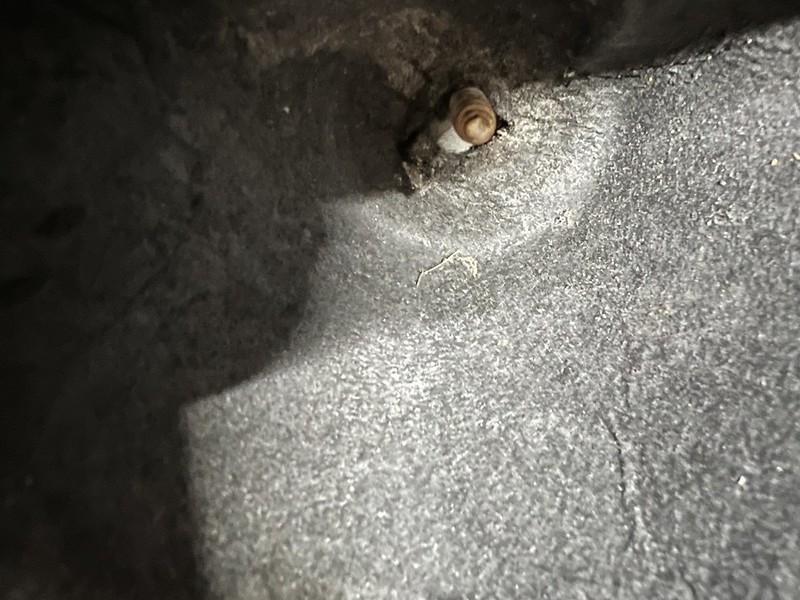

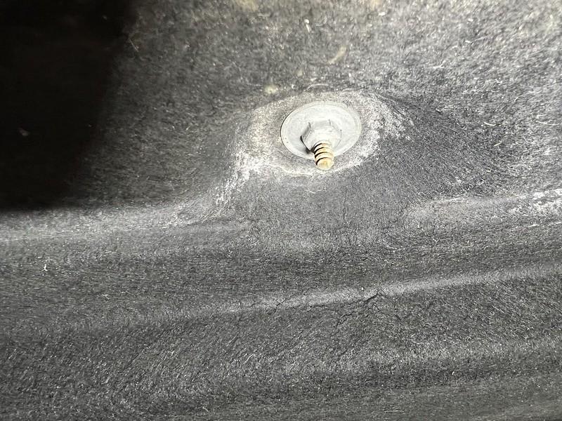

Today I noticed the shield/splash guard under the driver side doors was hanging down.
I found there are at least 2 missing nuts.
Does anyone have a part number or the size of the nut I need?
Shield hanging down.
Ford Maverick Underbody shield fastener part number needed 53544452828_886a253238_c
Loose shield under driver door by jon72vega, on Flickr

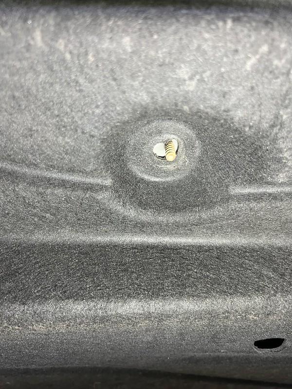

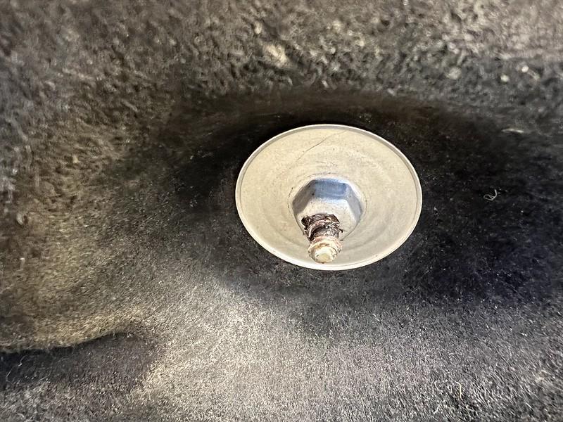

Missing fasteners.
Ford Maverick Underbody shield fastener part number needed 53544703215_cf380121bf_c
Missing nut by jon72vega, on Flickr
Ford Maverick Underbody shield fastener part number needed 53543398787_23ca10f8da_c

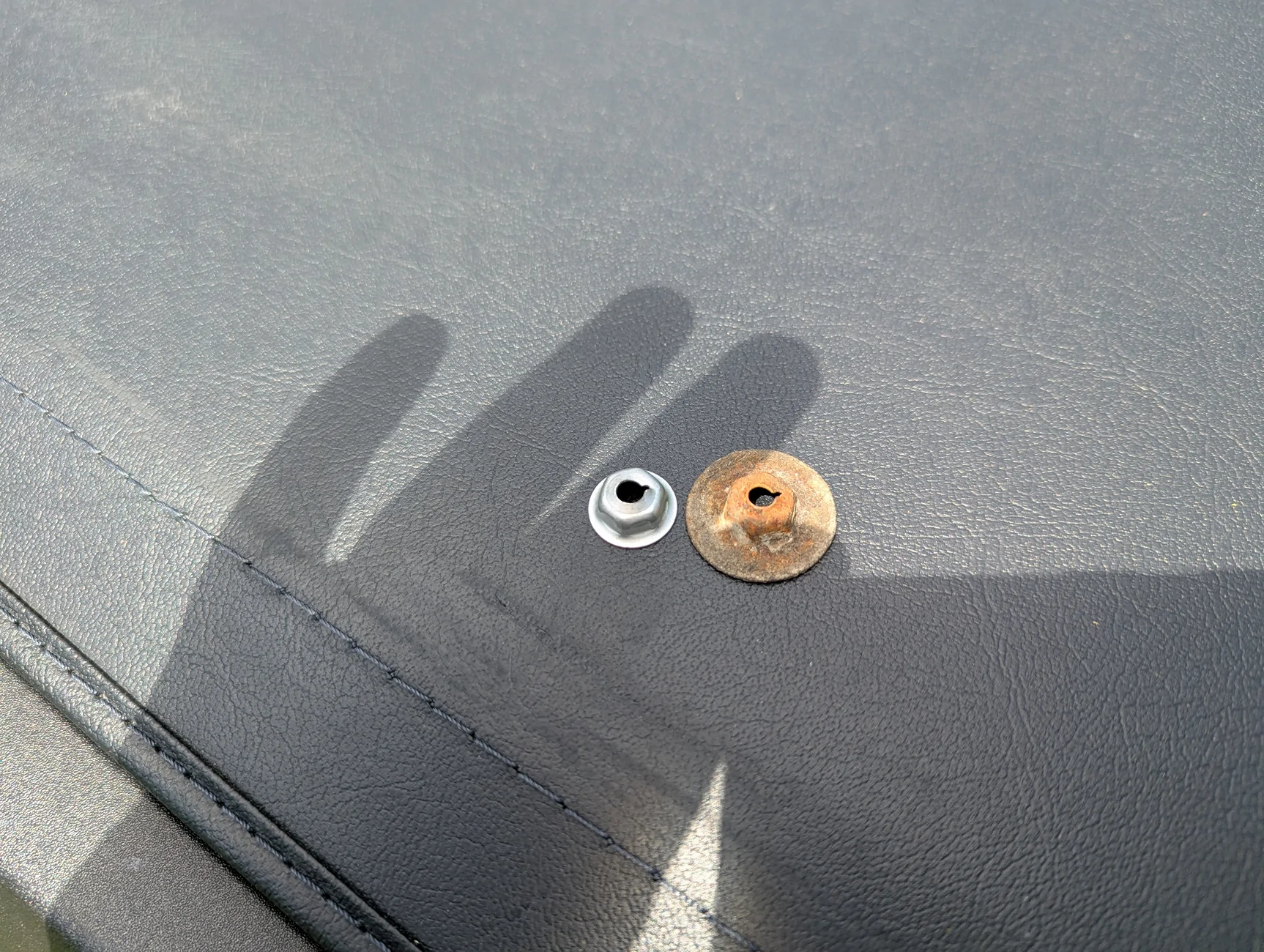

This is what the nut looks like.
Ford Maverick Underbody shield fastener part number needed 53544451753_ca2b115430_c
The nut by jon72vega, on Flickr

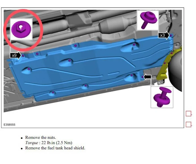

Found this diagram, but could not find a part # for the nut.
Ford Maverick Underbody shield fastener part number needed 53544589039_406cf23876_c
shield nut by jon72vega, on Flickr
I Google searched for over 30 minutes and came up with nothing.
Any help in figuring out the correct part # would be appreciated.

Most likely M6x1.0

Take a good nut and bolt assembly out and match it up at a hardware store or auto parts store.Amazon has them also.

Where did you find the diagram for the under body shield? I just had a tire retread fly off a truck and I ran it over and the rear drivers side portion ripped off. Now I’m hearing all sorts of noises like something is loose and jiggling around. Going to need to replace that piece now. Just need the part number.
bgn
Jun 12, 2021
3,021
5,638
WA
This might be useful as a starting point:
https://parts.lakelandford.com/a/Fo...loor-Under-cover--splash-shields/MM22592.html
I'd suggest double checking with the parts diagram available at your local parts counter. The one above seems to be from the service manual and I don't think they have part numbers.

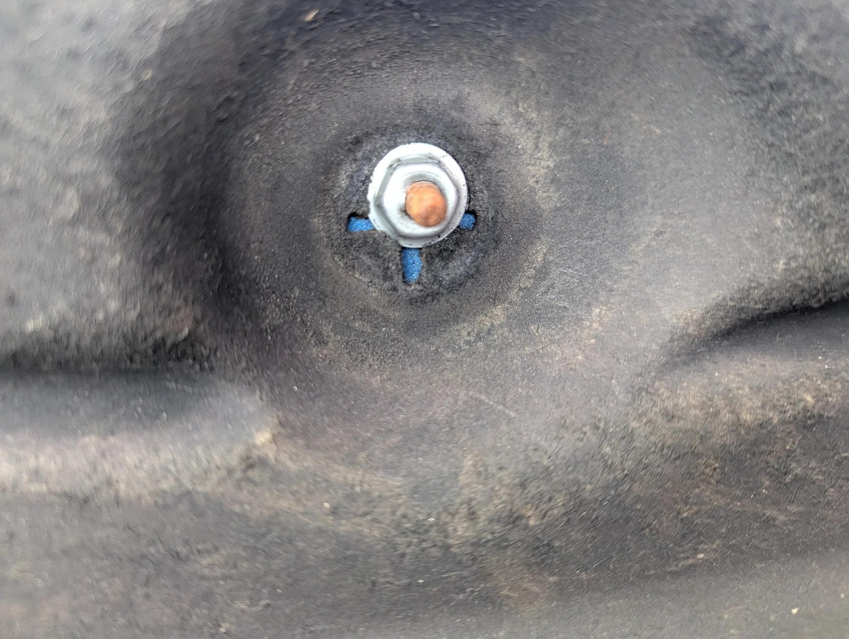

An update on getting more fasteners.
I purchased these on Amazon. Body Flanged Hex Nut
Had to drill out the hole to 11/64", (I expected I would have to enlarge the hole to make the fasteners work) and Bob's your uncle.
Ford Maverick Underbody shield fastener part number needed 53551345405_348b9d45ec_c
Retainer nut for splash shield by jon72vega, on Flickr
Ford Maverick Underbody shield fastener part number needed 53551096468_a81d16082e_c
