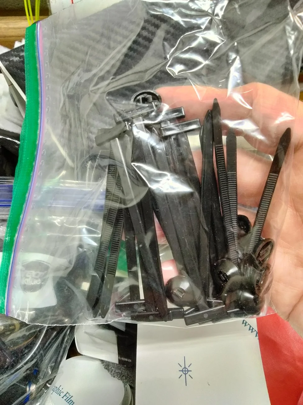

A picture would really help. Without one I'm only guessing.
I bought a bag of these from Amazon. To replace loose or missing ones when I do an oil change.
Here's the link to the Amazon fastener kit:
https://www.amazon.com/dp/B0BFGBHWDX?ref=ppx_yo2ov_dt_b_fed_asin_title
These work pretty good too for the fender liners. My niece gave them to me so I don't have a link.

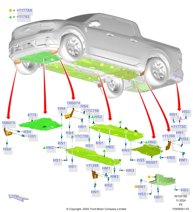

Are you talking about part HN1 in this diagram?

W709729S442 - HN1
W718770S439 - HN2
Both list for $16 Ford. Looks like both have something come up on Amazon.

HN1 - W706735S439 - 4.2, Nut "U" Spring
HN2 comes with the Air Deflector or W717422S439 - Nut U Spg Spl 5 X 1.5 - 2.5 Stl,
HN3 - W709729S442 - Nut - Stamped M5 HF
