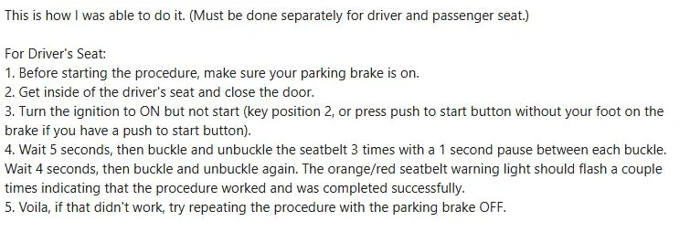

I will look up what worked for me in my 22, cause manual didn’t work there either. Give me a minute and I’ll try it on my 25 and post instructions. This confirmed working for me just now.........DO NOT START vehicle, I have push button start now, so just hit the button without foot on the brake. parking brake was on, did both front seats, from the drivers seat. Good luck!

I didn’t wait for the seatbelt light to “go off” before starting, it never would on the 22, and wouldn’t on the 25 either. Just got in, pushed start button, counted to 5 and then started buckling and unbuckling. It’s been a PIA for a lot of folks to turn off the chime

OMG, I finally got it to work! The OM is wrong in 2 places for my 2025 Lariat Hybrid AWD . . I did NOT 1. Start the engine and I did NOT
2. Wait a short period of time until the
seatbelt warning light switches off. I did everything else as written and it worked.

CORRECTED Instructions from the owner's manual of my 2025 Lariat Hybtid AWD:
Make sure that:
• You set the parking brake.
• The transmission is in park (P).
• The ignition is off.
• You close all vehicle doors.
• You unfasten the driver and front
passenger seatbelts.
1. Start the engine.
After Step 2, wait an additional five
seconds before proceeding with Step
3.
Once you start Step 3, complete the
procedure within 30 seconds.
3. For the seating position you are
switching off, fasten then unfasten the
seatbelt four times at a moderate
speed, ending in the unfastened state.
After each unfasten, the seatbelt
warning light switches on and off with
each fasten.
4. The seatbelt warning light flashes for
confirmation.
So, I ignored steps 1 & 2 in the OM and it worked.

So, wait...you didn't start the engine? You just had the accessory power on?

Just writing to confirm this worked for me in my '25 XLT!
