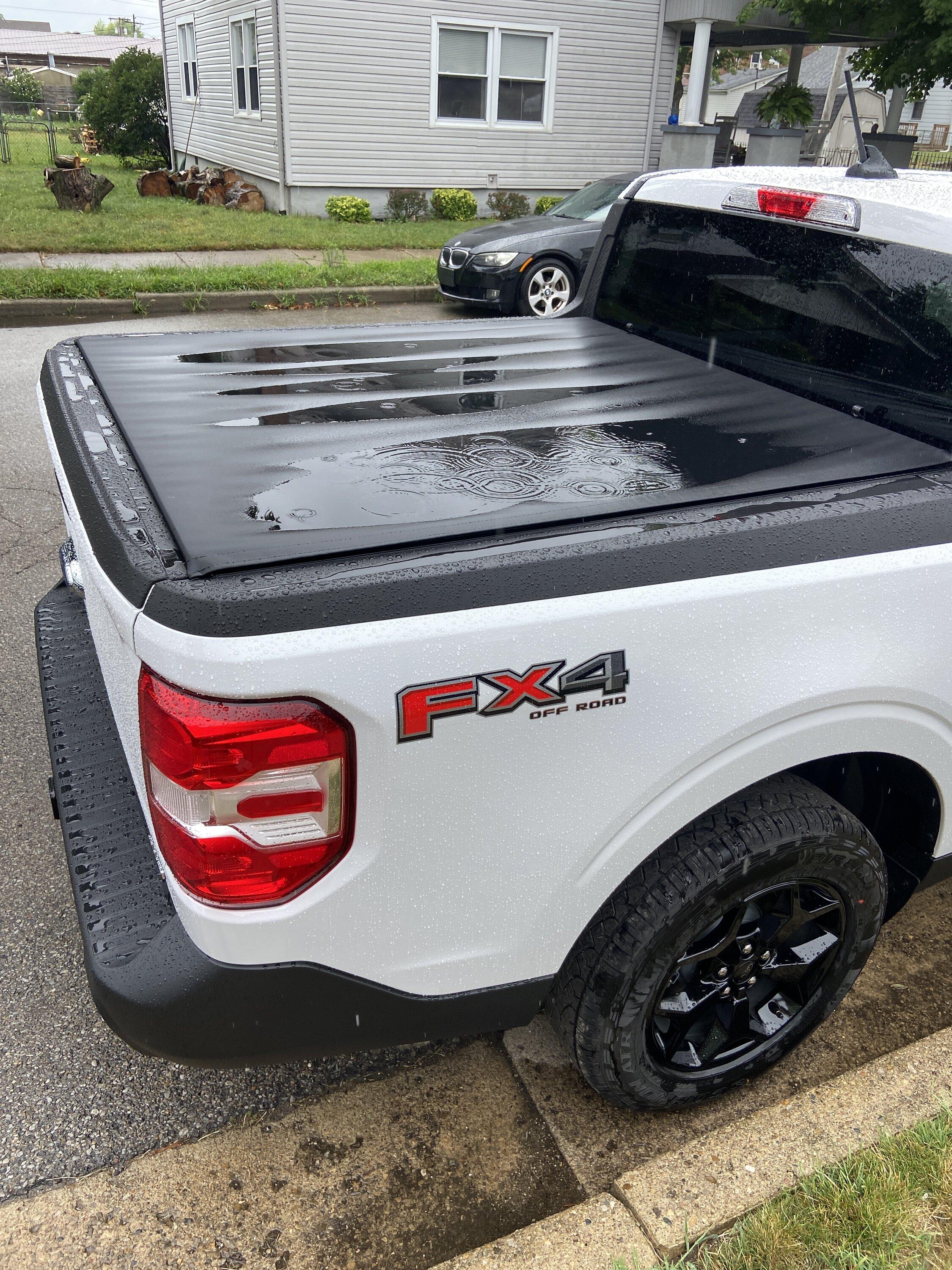

How do I adjust the top to stop these water puddles from forming?
MoveHow do I adjust the top to stop these water puddles from forming?
Yeah, mine won’t latch closed if the tailgate is already closed.Do you have the foam gaskets installed at each end of the rails? It looks loose...
Also, you have the gasket at the tailgate pinched. It should rest on the top of the tailgate, not folded under.
