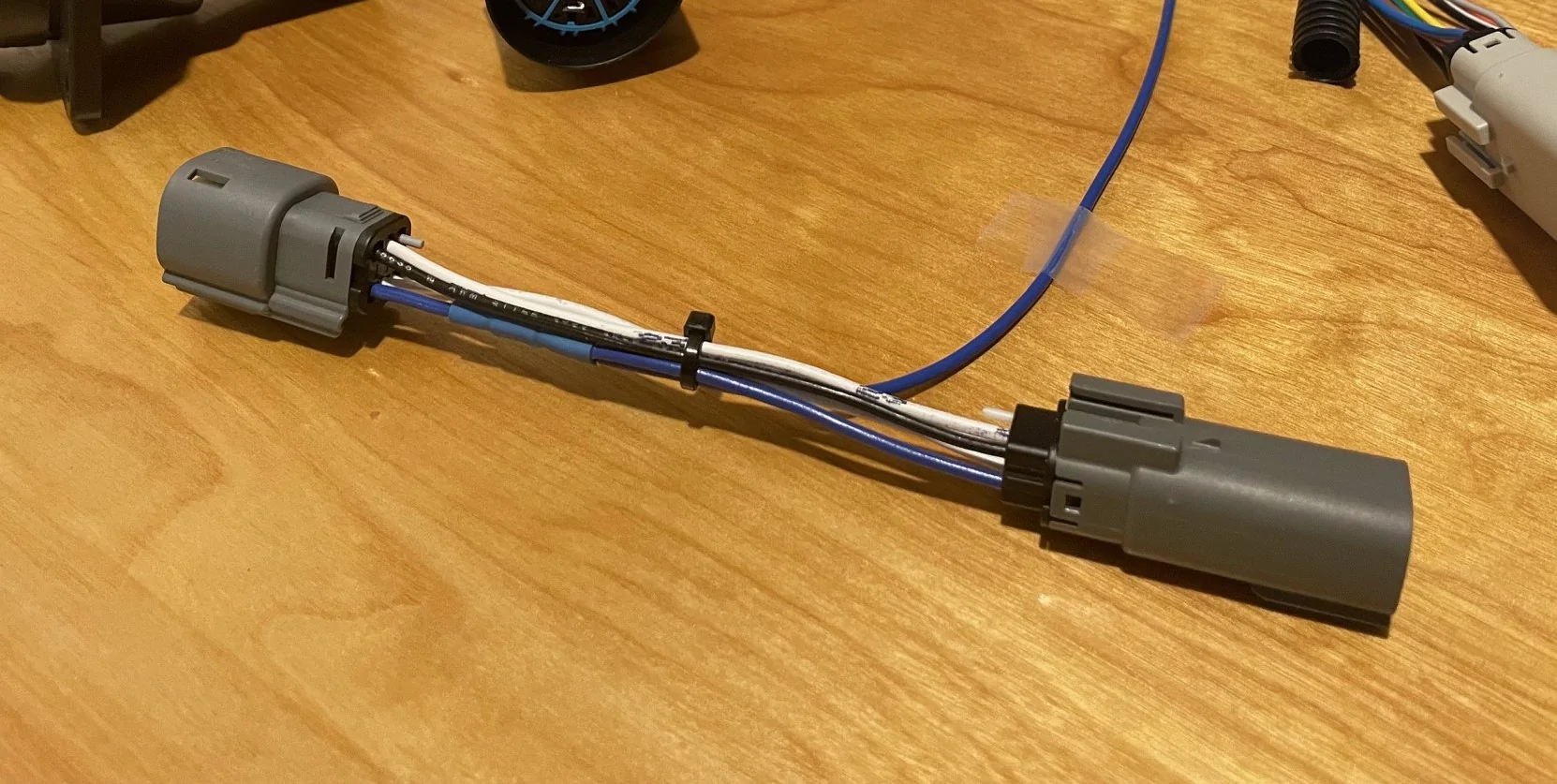

Ford Maverick Trailer hitch brake light Maverick 6-pin taillight jumper

I have a hitch brake light. It plugs into a harness that connects to the driver side taillight harness. It flashes a few times when the brake is pressed.
No BLIS errors.

I have not found any plug and play solution for adding a hitch mounted brake light or a underside tailgate light bar that includes brake light, turn signals and reverse light for my 2025 Maverick Lariat AWD Hybrid - some say they exist but no after market supplier that I’ve contacted has an answer🤷🏼‍♂️
This is what I have. Install was pretty simple and it works as you described.
https://amzn.to/3Nq0WiJ

I ended up installing the Curt wiring harness to put brake lights on my bike rack. It's a bit expensive, but seemed the easiest way to keep the side traffic alert. It does seem to be about $40 cheaper on Amazon right now though.
